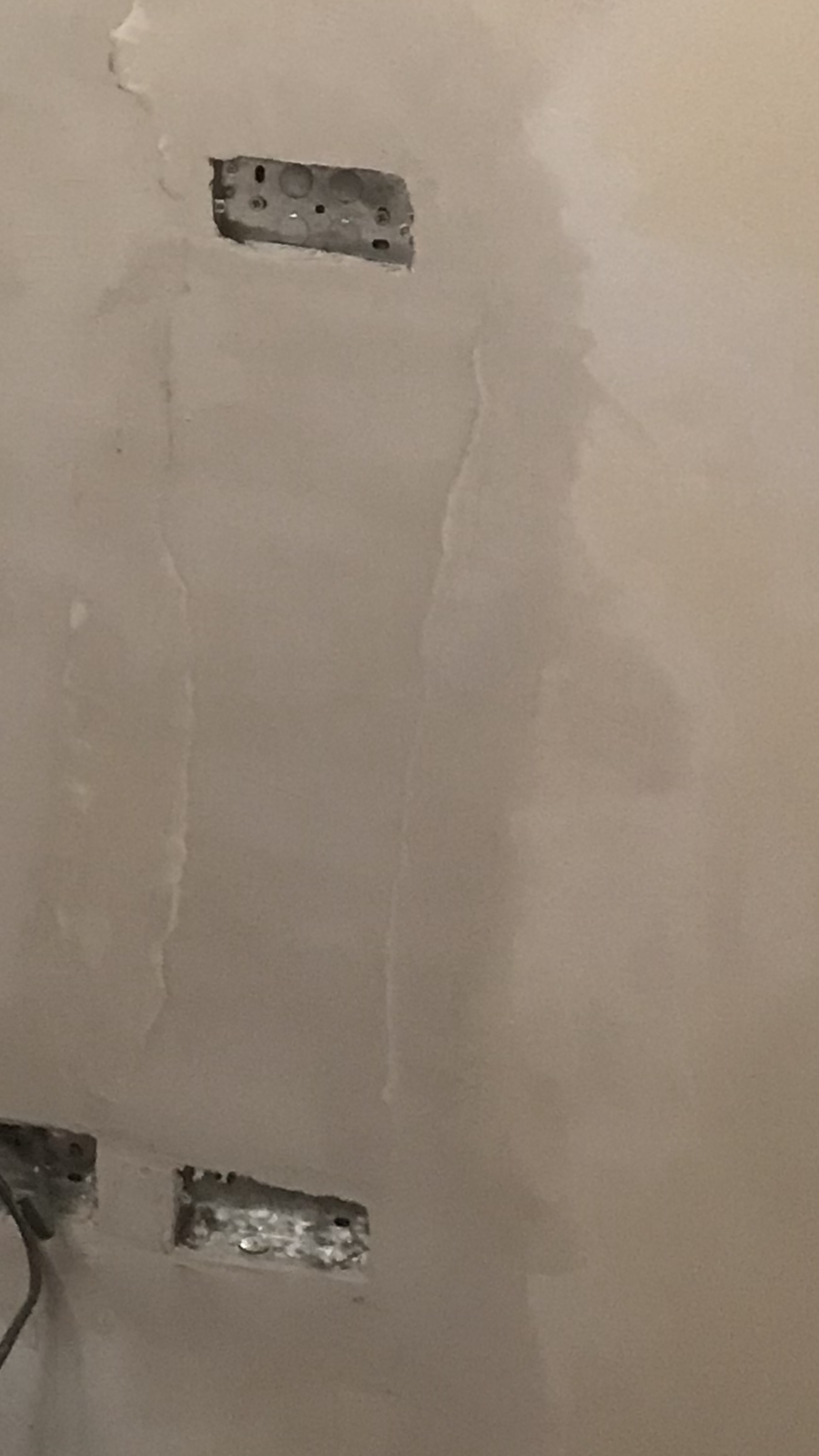

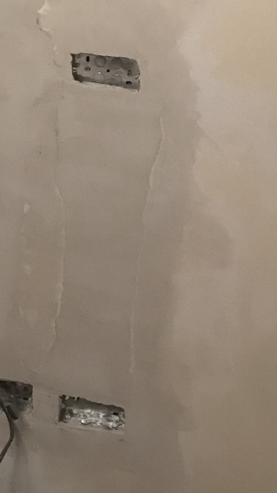

Concealing cables for TV

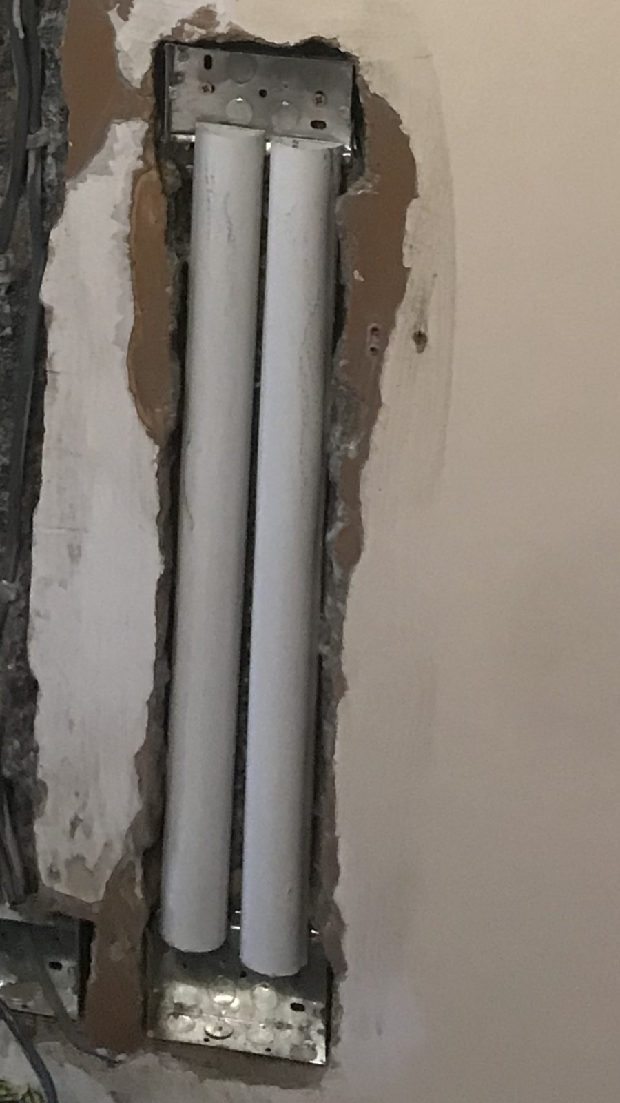

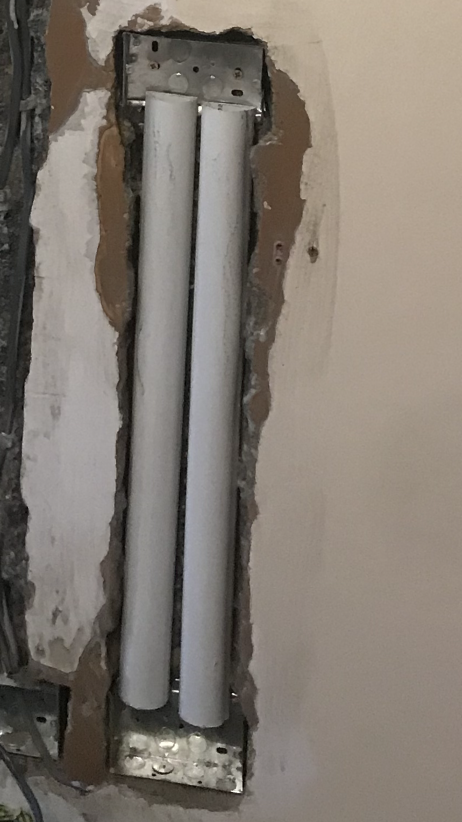

I would be inclined to use two or even three of these instead with a double box top and bottom
as the semi round is internally much smaller
UPDATE: went with these as the reviews suggest that it’s is very easy to feed in (up to 3 apparently…) HDMI cable into each Trunking. As you can see, I have fitted two for expansion purposes.
The contours in the image are deceptive. The easifill is beautifully smooth and level. Love that stuff.
Welcome your feedback. Thanks for your help.

Apart from HDMI and other Extra Low Voltage Cables, how do you propose to get 240 V AC power to the device concerned?
Unless the TV uses an IEC C7 (or even C5) power connector, you will not be able to get a BS 1363 plug ended cable through any small diameter duct.

Although he has fitted power sockets behind the TV position it wouldnt take long to cut the plug off, thread the cable and fit a new plug would it??
As said above, there is a double socket for the TV. This sits towards the top (and back) of where the TV will be. The ducting is purely for cables running between TV and any devices I have in the base unit E.g. HDMI cables
