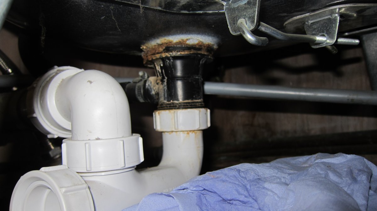

I am going to try to replace this leaking bath waste but I am concerned that the level of corrosion might make such plans futile. I intend to remove the waste and give the bath outlet a good wire-brushing and apply some suitable paint (Hammerite?). Is it possible, though, that the bath may be beyond repair?
Thanks for any advice.
Give us a pic with the waste removed and wire brushed, if you can.....silicone will fill a multitude of rust pockets if you need it to.
John :)
Burnerman: To be frank, John, when I looked at this a couple of weeks ago I did not think it looked too bad so I did not get around to removing the waste – I should say that it is at a friend’s property . It was only when I put the pic on the computer that I realised how intense the corrosion appears. Would you treat the metalwork with any kind of primer beforehand or just plunge in with the silicone?

If the steel isn't too pitted and still all there, to do it so it lasts > wire brush > kurust > leave to dry as long as possible (cple of hours or as long as MI mentions) > 1 coat of hammerite and dry again as long as MI mentions before using a little silicone to re-seal waste.
Just to be clear- Krust is the converter
A couple of hours is fine
You'd get it in Halfords or similar. It converts rust to a stable material and stops further
Suppose he gives it a good wire brushing and it all flakes away and can't be resealed? If it was my friend's bath I wouldn't be volunteering.
Of course, only proceed as long as your friend is aware of the ramifications if it's too corroded to re-seal.

I have always found Kurust to be a superior product, so, in your position, I would try to find a supplier with some on the shelf. If there is some other paint or motor accessory shop nearby they may have some. I will take care of the jar I have at home.
