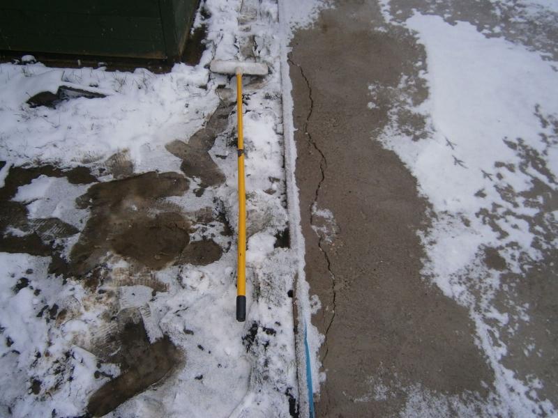

Just been up to sweep away the snow and small cracks by the shuttering have started to show, I'll see how it is in the morning and call the contractor.

Contractor came out. He said the concrete had not gone off properly. He suggested cutting out blocks of concrete where the cracks were and filling in with a new mix. Pic of one crack:
I declined and said I wanted it up and relaid by someone else. We came to an amicable arrangement and both parties were happyish. I asked how many bags of cement he used - enough for the job (there were some broken bags in black plastic sacks which I remember seeing but it didn't look a lot. Anyways, I didn't push it too much so left it at that.

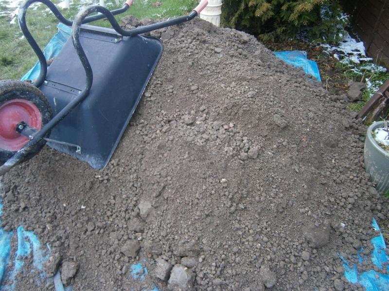

So started busting up the concrete. A pile of which can be seen below:
I'm wondering if I could use this as a sub-base?

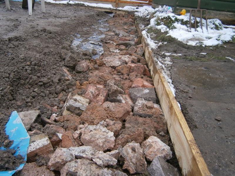

The current compacted sub-base under the dpm looks like this, which I take it is unsuitable?

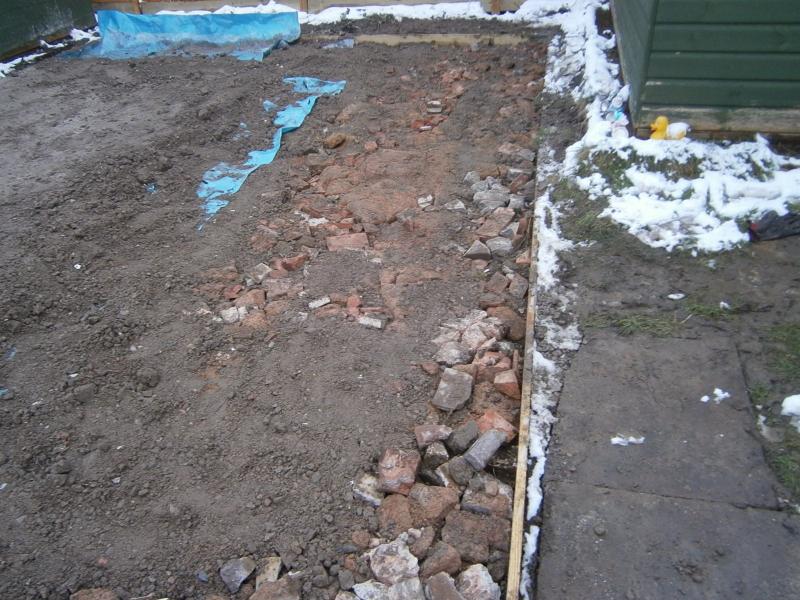

Got half the base up this afternoon, and it now looks like this:
Will just get the site prepared for a firm to just lay the concrete. I think the shuttering is still good or should I get new?

It should have been covered and not left open to the elements.
The screed shutter looks banked behind with concrete. That will make it very difficult to remove.
All you need is a few pegs.
