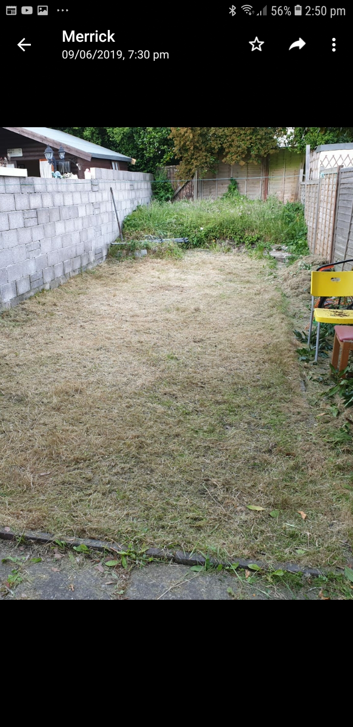

A mate wants to put a summer house at the end of his garden . Is a concrete base easy to make with shuttering and mixing the cement in a wheelbarrow?
His summer house will be 3 x 4 metres or 3 x 3 metres. It's pretty rough raised ground at the top of his garden where he wants the base to go.

Personally a concrete base might be overkill. Lots of people float them a bit like you would decking only a bit beefier. 3x3 isn't very big, I've seen people simply rest fence posts on concrete slabs or concrete these posts in and build on top.

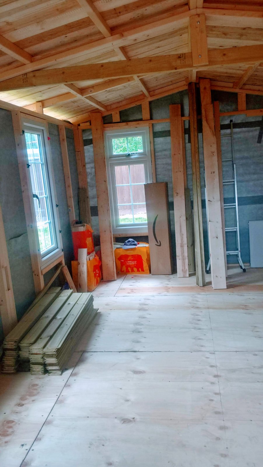

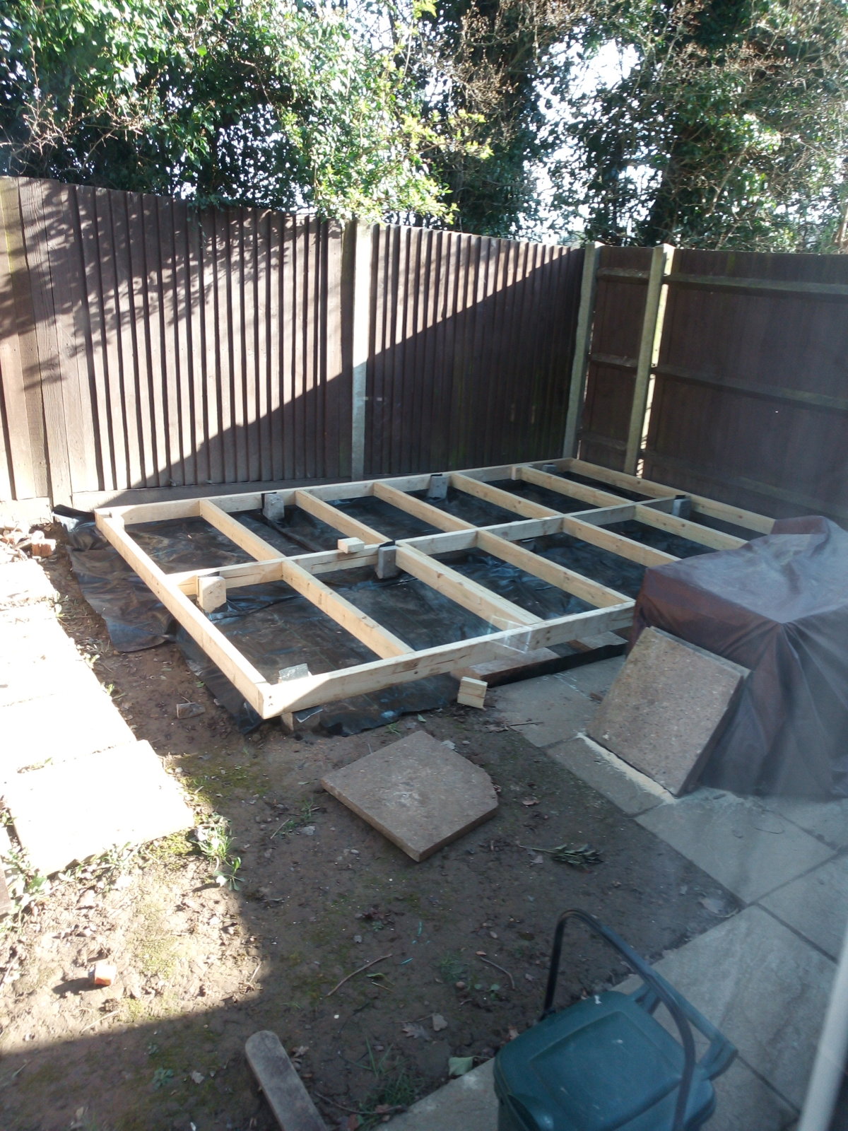

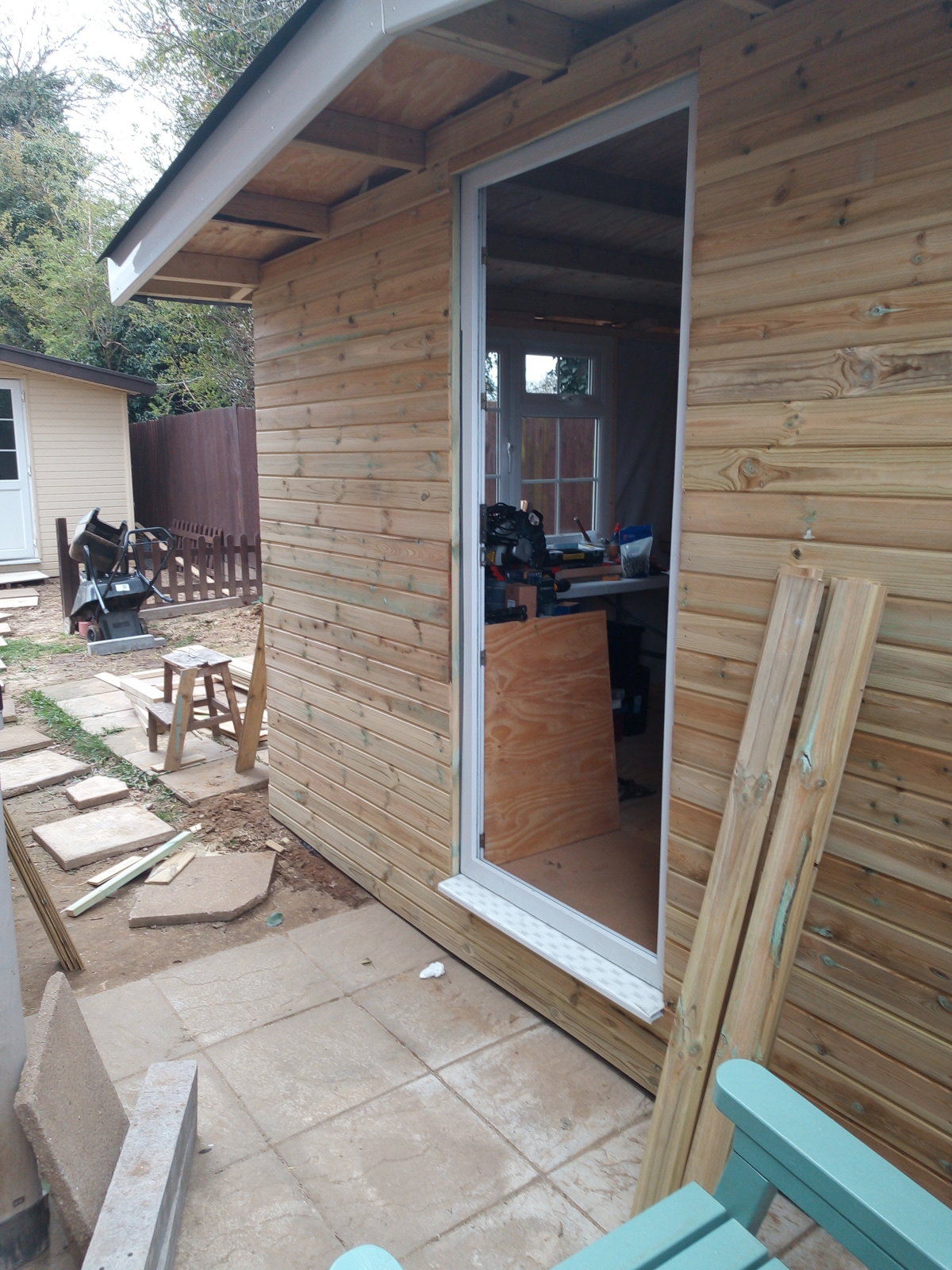

Best would be a raised base like I have just finished for my shed. A lot easier and better than concrete.
I've seen a lot of people do it as a DIY project. Depends on your skills but wood is quite forgiving

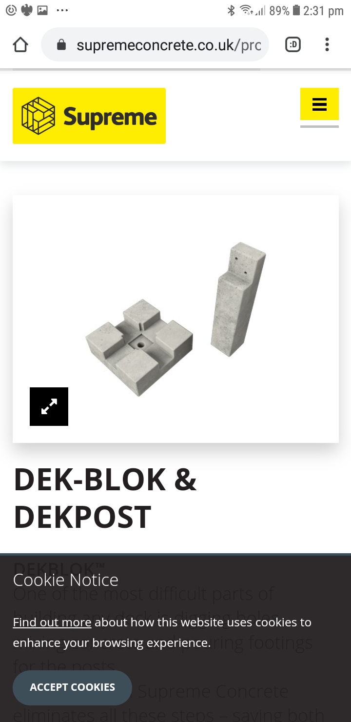

It's a lot easier than it looks, getting materials now is a different story, I always use the concrete dek posts from supreme concrete, never rot sold in different lengths, I use stainless steel bolts with dpm inbetween the post and timber frame, on the 3.6 x2.5 base I used 12 posts @£6 each from my local supplier, I have used these on different projects they are sold in different lengths, I always use the 600mm length ones. Make the timber frame mark out the holes set each post in a cement ballast mix. Rock solid and the frame becomes the floor which is ideal for a log cabin.

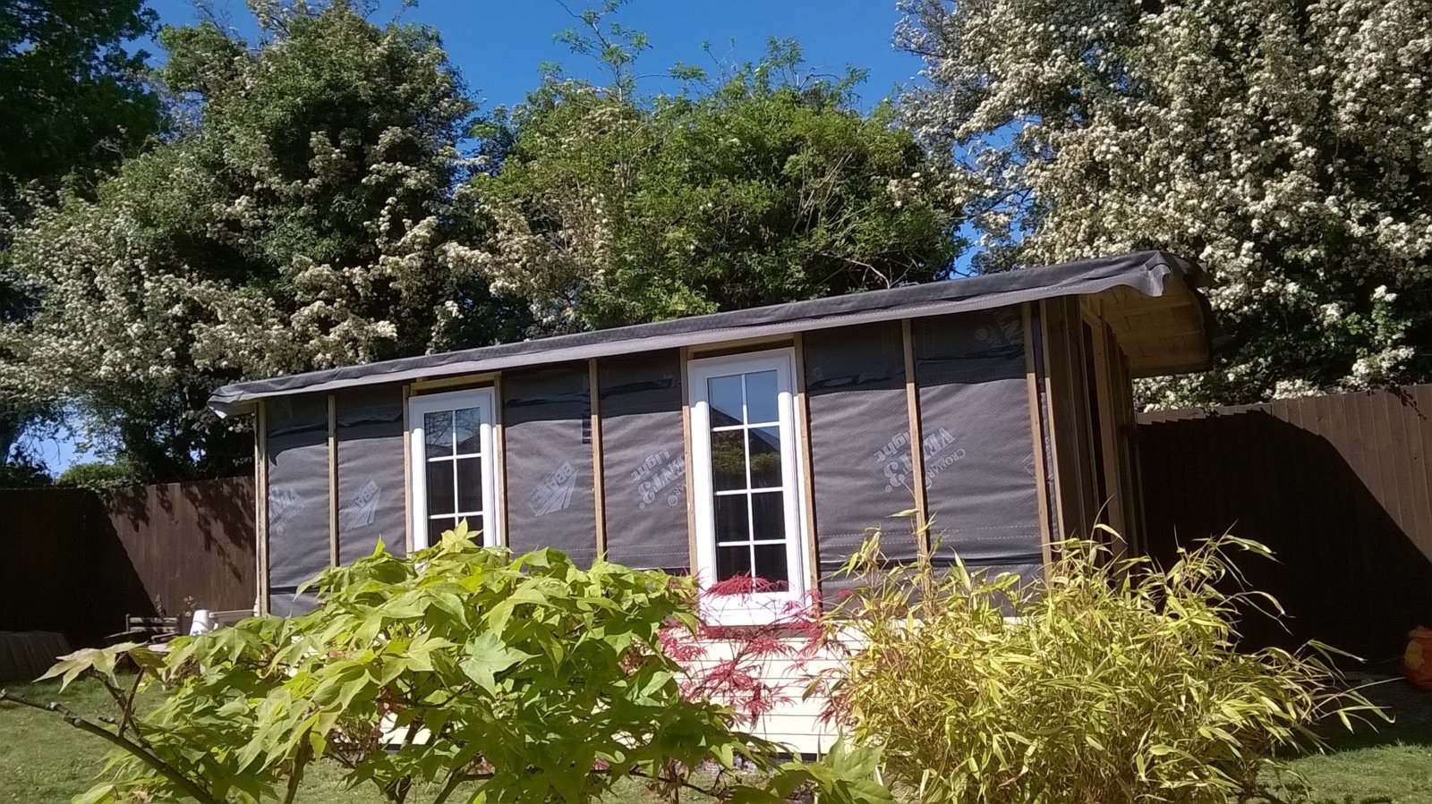

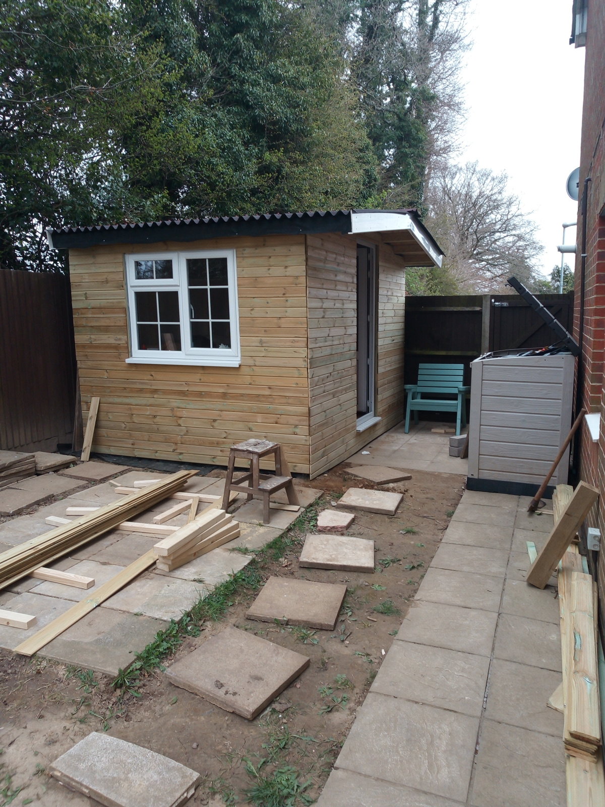

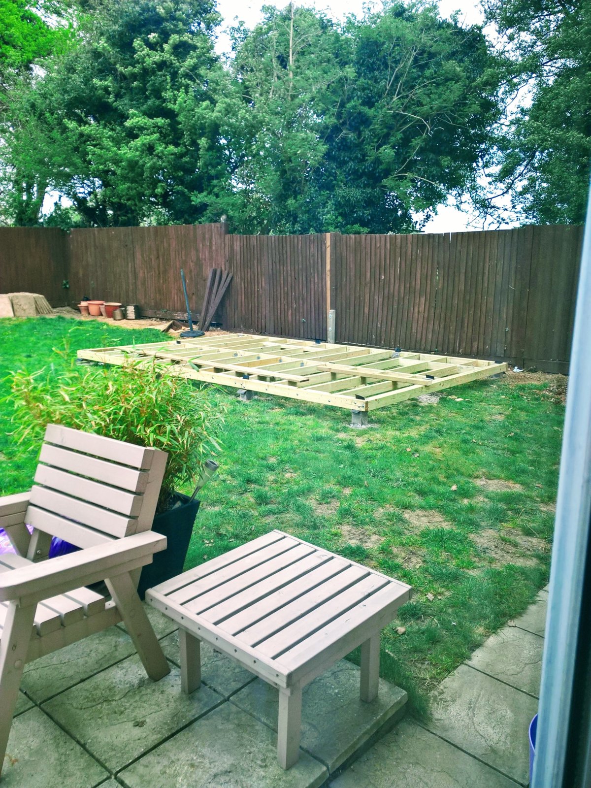

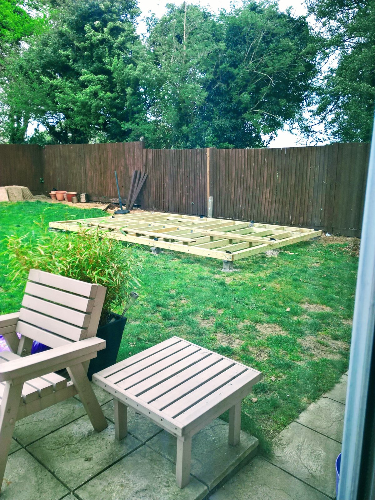

This is the 3m X 5.5m summerhouse that I built last year on the same principle, 12 concrete dek posts, and the same 4x2 treated timber supporting frame, all off the floor and it's under the 2.5m height limit

How about this concrete post?
Put them 2 feet into the ground?
Postcrete it in then bolt 4 x2 to it

There the posts, if the ground is unlevel the depth of the posts allow for depth adjustment, dig the hole approximately 200mm square especially if the ground is soft, the least disturbance the better, the frame this way allows for air flow underneath and no water can get to the frame. It's my personal choice instead of concrete, we live in a small close and deliveries are not easy, but being a carpenter I prefer wood, treated of course.
Would postcrete hold these posts? And a normal weed membrane instead of a dpm?
