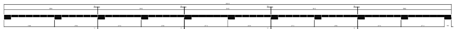

Expansion at every other Pillar I think. I was thinking 6m crs as per the joints but you need them at ~3 m crs so Start with a Pillar/wall/Pillar/wall. Joint. Pillar/Wall/Pillar./wall Joint, repeat, last bay will be Pillar/wall/pillar/wall/Pillar, slightly longer to get your 28m.
Panels (I think) 1No. 5864mm [2 pillars](12mm exp joint) 3No. 5312 [2 pillars](12mm exp joints) 1No 5862 [3 pillars] total length 28010mm - with 12mm vertical (perp) joints insterad of 10mm.
not sure if you can read this image - long "Teams" meeting this morning :)
Regards the piers - it might be simpler to stack bond the blocks and just use wall ties in the joints, as long as they are tied to the wall - there are some hilarious videos on you tube of piers that are completely detached from the wall they are holding up.

What software did you use to create that image?
Looks like your suggesting 11 pillars an 5 blocks between with one end being 6 blocks?
I knocked it up in a package called ProStructures. I design steel signalling structures for the Rail industry as a living.
Yes it has 11, if it ties to the house or similar at an end, that pier can be left off.

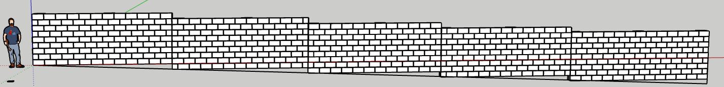

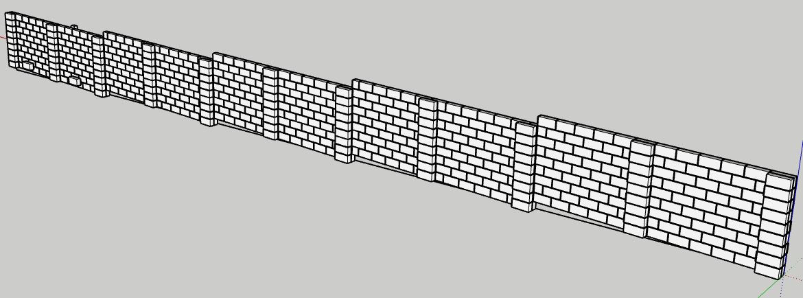

sketchup drawing... does it work? (Noth sure if the pillars are thick enough two blocks of 140mm?
Expansion gap to the left of every second pillar.
Looks about right, don't forget to put a DPC in at 150 above ground.
I think the Piers should be adequate, but if you want bigger then put a couple of blocks in at 90° to form a 440 square pier (including the wall thickness) If you do this then fill the void with concrete and maybe stick a few bits of rebar in there as well, should withstand anything short of a tank.
