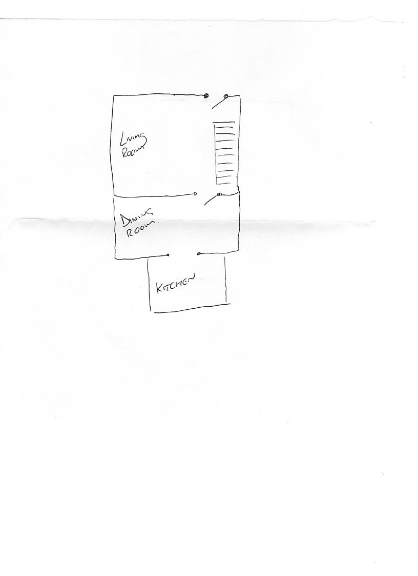

Just after some help laying a concrete slab, I've been looking over old posts but a few things don't seem to have been covered.
I have the basics - Compact ground, 100mm Hardcore, 25mm Sand, DPM, 100mm Concrete, 75mm Inulation & finish with 25mm screed. It's just some of the practicals I'm not sure about;
1. I keep reading about HAVING to lap the DPM into the DPC. In this case the DPC is bitumen and strangely is below the existing slab level ?? I really don't want to start cutting into 100 year old bitumen joints, would Building Control allow me to just cut the DPM membrane at floor level or tuck it in somewhere ?
2. Stairs. When I dig down, how do I support the stairs at the bottom, do I even need to ?
3. Can I pour the slab in two seperate pieces ( the kitchen is already concrete ) with a break betwen them, I mean one slab for living room and another for dining area, maybe have some insulation board seperating them where the door threashold is ?
4. On the day of the pour, I was gonna stump up the few hundred quid and have it pumped in, about 3m3 for living room and 2m3 for dining area. I've never done concrete before, Is the tamping and levelling easy enough or should I see if I can get a builder for this ?

1. It's not what building control "will allow", but the risk of damp getting up between the DPC and DPM at some future date.
2. Timber chocks or blocks. Or a hanger off the ceiling.
3. Unwise unless you design ties to deal with uneven settlement or movement.
4. Easy if you know what you're doing.

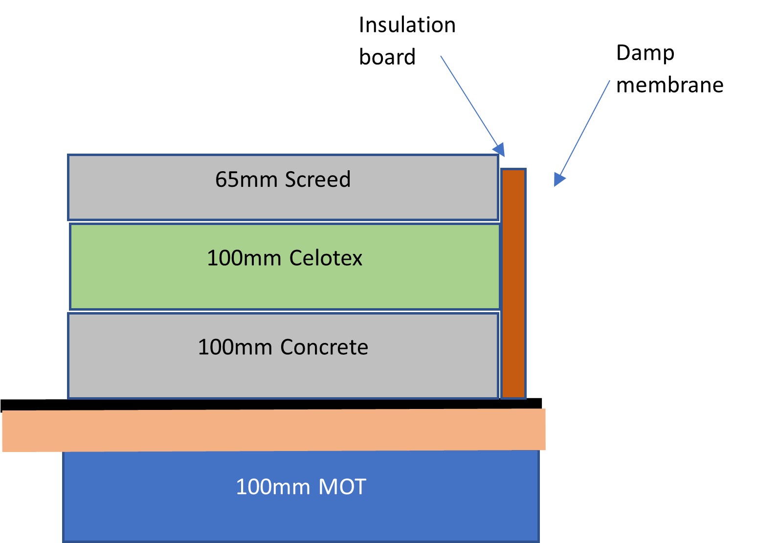

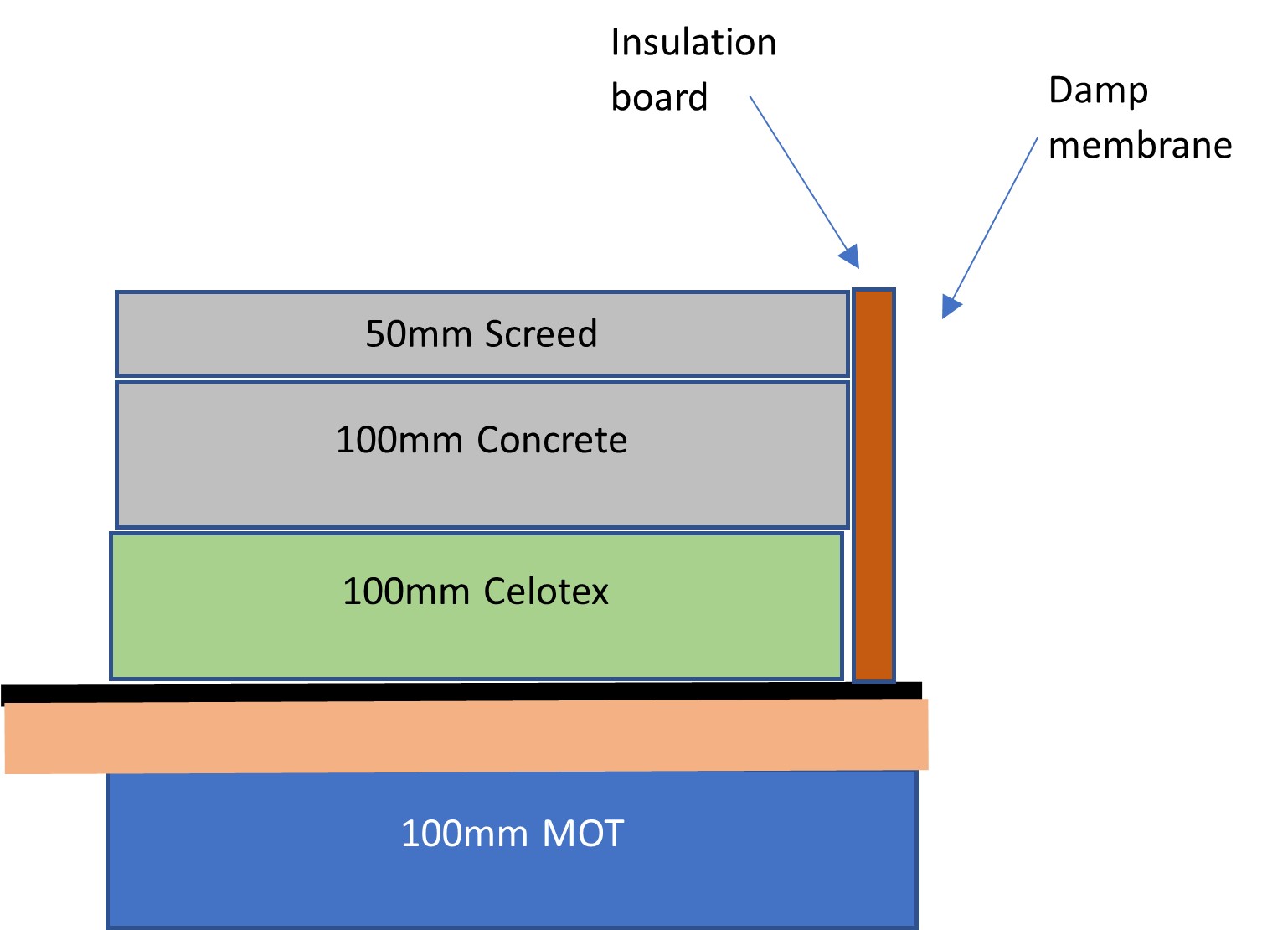

Some my two options are as attached ? Either way I'll be digging out nearly 400mm.

I understand what Woody said about pouring in one complete slab but wouldn't the thin section of connecting slab by the doorway between living room and dining room be a weak point ?? It's why I was gonna shutter it off and pour two seperate slabs, maybe a week or so apart, so you can work off one.

This is probably a daft question, but whats the point of the screed over the concrete, purely to smooth ? Couldn't you just have the concrete and then put laminate or carpet over it ? I really want to keep the excavation down to a minimum.

You don't have to screed on top, but it is normal practice to do so. Rarely are concrete slabs flat enough to take your floor covering.
I have option 2, the UFH pipes are in the screed, probably no use to you.
You could do option 1, and then either thinner screed or self levelling compound (SLC) on top (this would only be mm's thick).
