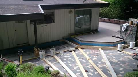

In the past when I couldn't pin down a form I've put braces and just stuck weight on it. Your slab won't be too thick so it should be fine to do something similar. Good luck!
