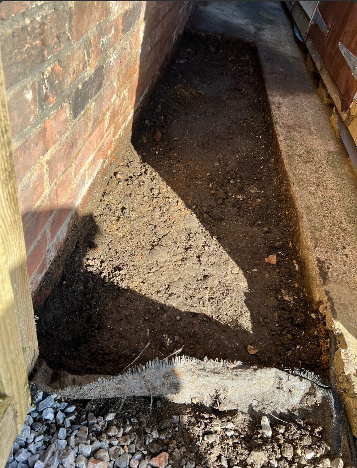

Concreting this section
30 Mar 2015
4,394
80
I’ve got around 8 bags of building sand and 3 of cement. I was considering paving slabs for this section but perhaps, I should concrete it. Can I have some advice and instructions for this please.
Thanks in advance.
Thanks in advance.
Buy 10+ 25kg bags of ballast and two bags of cement. Mix concrete (6:1) in a mixer. Lay concrete in the hole, tamp it flat-ish then walk away for a couple of hours. Trowel it smooth. Go have lunch. Trowel it again.
Buy 10+ 25kg bags of ballast and two bags of cement. Mix concrete in a mixer. Lay concrete in the hole, tamp it flat-ish then walk away for a couple of hours. Trowel it smooth. Go have lunch. Trowel it again.
Can I use my existing bags of sand in some way?
Also, do I need to use MOT1 and crush it down?
