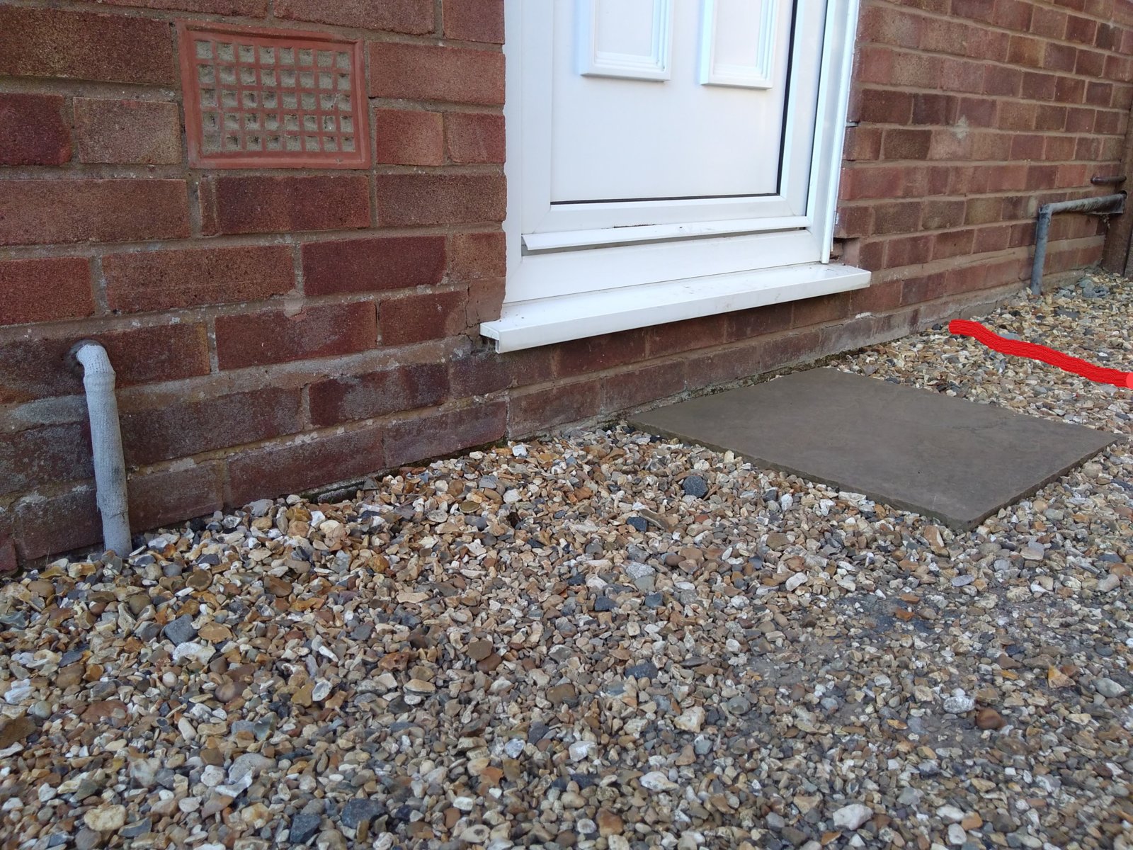

I am planning on putting a concrete base down in my garage
Plan is to dig out and put 100mm of hardcore and 100mm concrete on top
The garage is not used for a car, its more of just a store room
The garage is also NOT accessible directly from the house
My central heating boiler is in the garage and its gas is fed by a 22mm pipe which as you can see from the pictures attached, exits my kitchen wall, drops downwards (see pipe to left of the air brick) into the ground, and then pops up approx 2m to the right before re-appearing and going off to the boiler

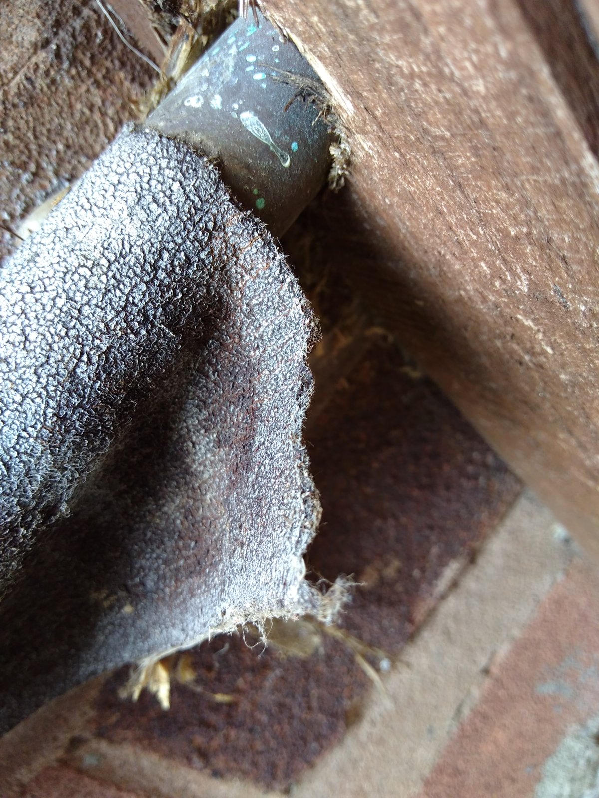

I seem to recall the depth of this pipe is approx 12" below ground and again, i seem to recall being told that the pipe is wrapped in Denso tape (see Denso.jpg)
Obviously i would rather not have to pay for the gas piping to be modified to have to be visible on my outside wall so my questions are :
Q1 - Is it ok to have a standard 22mm copper pipe wrapped in Denso below ground ?
Q2 - If yes, can i concrete over as described above ?
Q3 - Where the concrete meets the pipe, is there any other barrier or distance needed other than the thickness of the Denso tape, to stop the concrete reacting with the pipe ?
The red line on the photo is where i plan for the concrete base to come to
Can anyone advise please ?
Many thanks in advance
Is this Denso tape ???
Lol. I've dug ancient (unprotected) copper pipes out of concrete showing only signs of surface blemishes. The copper and soldered joints was fine and intact.
Crack on. Just cover it in soft sand and warning tape. Sleeve it in plastic if you want, but I would not bother as long as its wrapped in Denso.

It is extremely dangerous to bury gas pipes under structures, that is why it's not allowed.
Incorrect.
It is forbidden to build over a gas service. Please don't post where you are not qualified.
I am qualified, and you are extremely irresponsible to suggest otherwise.
Domestic gas (as long as it is protected against corrosion) in concrete is allowed.
Do stop posting rubbish.
I said, and I am correct "It is extremely dangerous to bury gas pipes under structures, that is why it's not allowed."
And you said "It is forbidden to build over a gas service." an answer open to interpretation, probably deliberate. You can build a path over a gas pipe but you must not build a structure over a gas pipe, doesn't matter what size or who owns it, end of.

No, it is not open to interpretation. The gas 'service' ends at the meter. Domestic gas pipes can be buried in concrete - i.e. built over.
