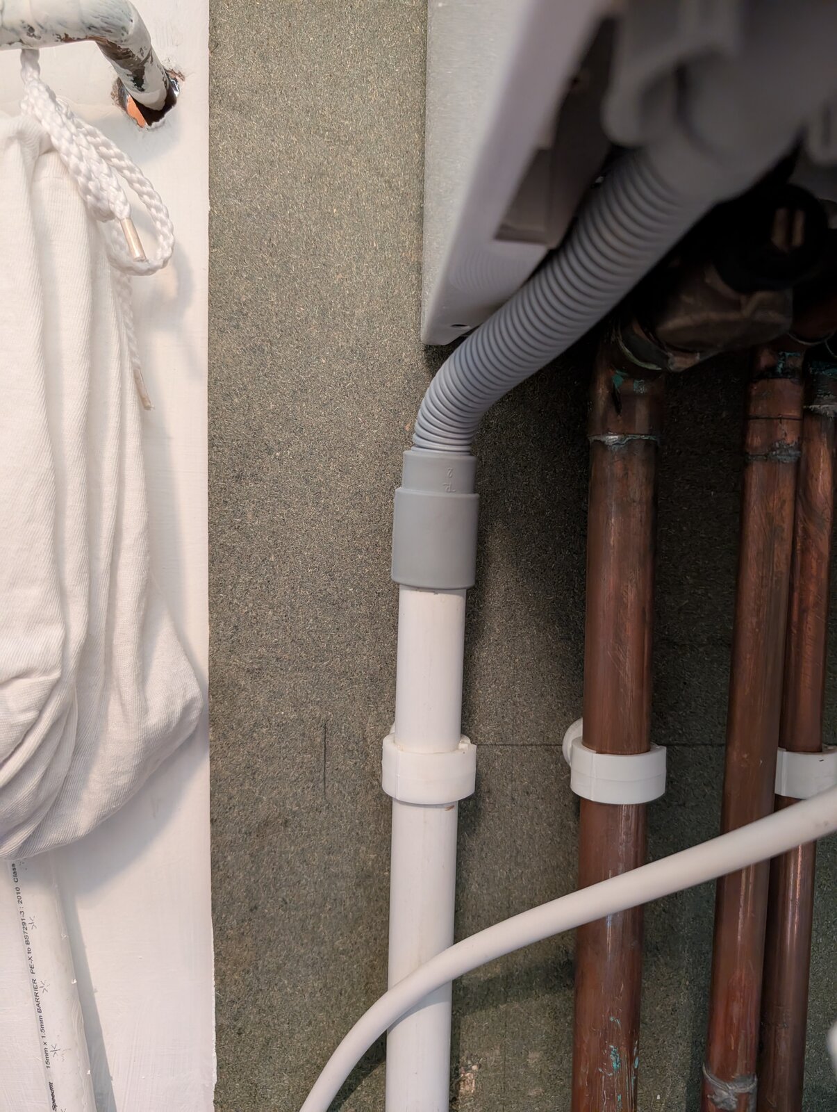

Hi,
We've got a small weep/drip from where the grey condensate drain connects to the white pvc pipe (see picture).
Does this just push on, or does it need to be glued - can I do this myself or do I need to get someone in to do it?
Thanks!
It's a push fit, just pull it off & push back on having first smeared silicone grease or similar around inside of female part.

Is it really just lift off and push back on, because I really don't want to mess this up
What's the purpose of the grease? Lubrication it to help the seal?

I did however phone the Vaillant customer helpline, who weren't much use. They were just adamant that it shouldn't leak, and all I could do was take it off and put it back on again. Don't use any kind of clip as there needs to be an air break, but not sure what they meant by that
Ok, I've managed to take it off. I can see how it's ridged inside to sit on the pipe. Is there supposed to be a washer in there or anything?
