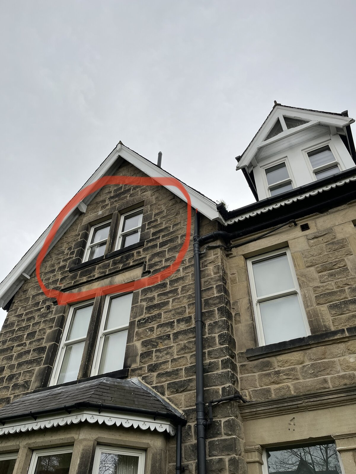

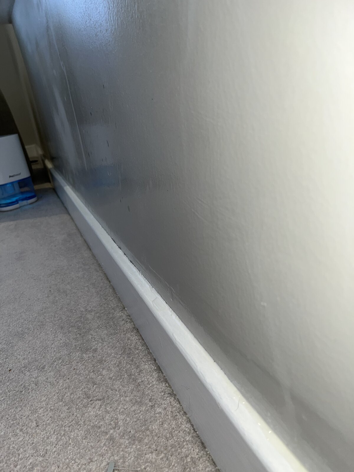

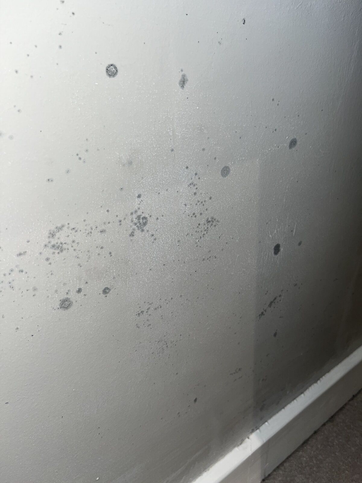

A friend of ours lives in a top floor flat in a stone-built Victorian semi-detached house, and has what appears to be condensation problems on just one wall in a bedroom. Main points as follows:
The flats were converted about 20 years ago, and it looks to have been done well and to high standard as far as it's possible to tell from the finish.
The rest of flat seems fine.

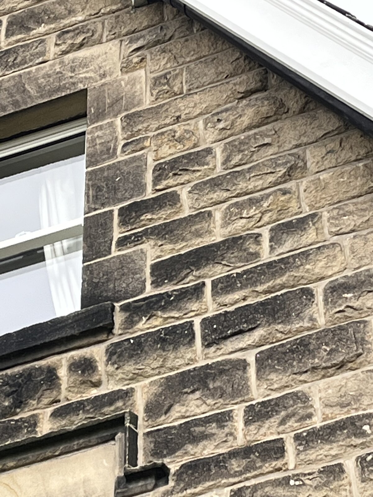

The problems only occur during winter when it's very cold, suggesting this isn't penetrating damp from a leak. The pointing looks OK as far as it's possible to tell from ground level photos.

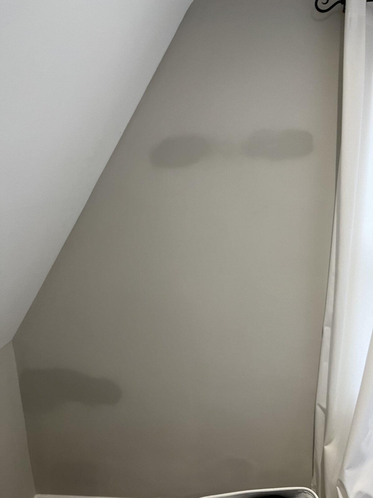

The problem seems to be at its worst below the window level, but some patches higher up.
The wall faces East so ought to get some sun. The mirror image flat in the other half of the semi is fine.
In spite of keeping the room well aired, and even using a dehumidifier, moisture can apparently form on the wall relatively quickly - say a couple of hours.
The previous occupants reckon not to have had any problems.
That wall has been painted since the previous occupants had it, which makes us wonder whether it had breathable emulsion on it before, so perhaps the problem WAS there but moisture didn't sit on the surface to the same degree.
We don't know yet what sort of plaster, insulation etc. would/should have been used.
The working assumption is the surface of the plaster inside is way colder than it should be for some reason on that particular wall such that the heating being on is making little difference to the surface temperature - such as a gap somewhere in the structure allowing cold air to get behind, or missing some insulation that is present elsewhere in the flat. Any thoughts/experiences/fixes appreciated. Thanks!

I'd say the wall is simply too cold for the moisture in the room, but the only way to know for sure is to measure the vapour levels and surface temperature across a range of timescales. You may well be right that the paint hasn't helped - it looks glossy? Ventilation may help but I reckon you are looking at internal insulation to really kill it off. What are you prepared to do to solve the issue?

I got my first proper look at the problem this morning and it soon became clear that the affected walls aren't plasterboard - it is plaster onto solid wall. This is a surprise as I would have expected that anyone doing a complete refurbishment/modernisation as recently as 20 years ago would have taken steps to insulate + it is clearly plasterboard on outside walls of some other areas of the flat such as lounge and main bathroom, and explains why they don't have a problem.
The outside temp at the time was 4.3 degrees and the plaster surface temp on the inside was just 5.5 degrees in the worst affected areas of the wall, and around 8-9 degrees in the rest. That says to me there is simply no insulation.
Human factors such as the relative humidity and general level of heating are clearly contributory factors too when we measured them, but they can be dealt with. e.g. it transpired that the dehumidifier being used was one of those little electronic ones and nowhere near up to the job of keeping an old property like this dry - so that is going to be replaced. I imagine that step alone will improve the situation significantly.

if it's solid plaster I'm inclined to think there could be a roof leak and tracking around. It may be that a small roof fault is chilling a wall, leading to further condensation.
In the outside picture the gutter has grass growing in it.
Human factors need dealing with first - RH in that room was 80%+ and the heating was far too low. Once that's dealt with, we should be able to tell if there is any residual issue of the type you describe. My gut feeling is there isn't. If you wipe the walls, its unquestionably condensation forming very quickly. Yeah, I saw the clump of grass too and the gutters were apparently done last year so could certainly do with another clear out as there are a lot of big old trees in the area.
Condensation.
Warm the room. Ventilate. Insulate that wall.
