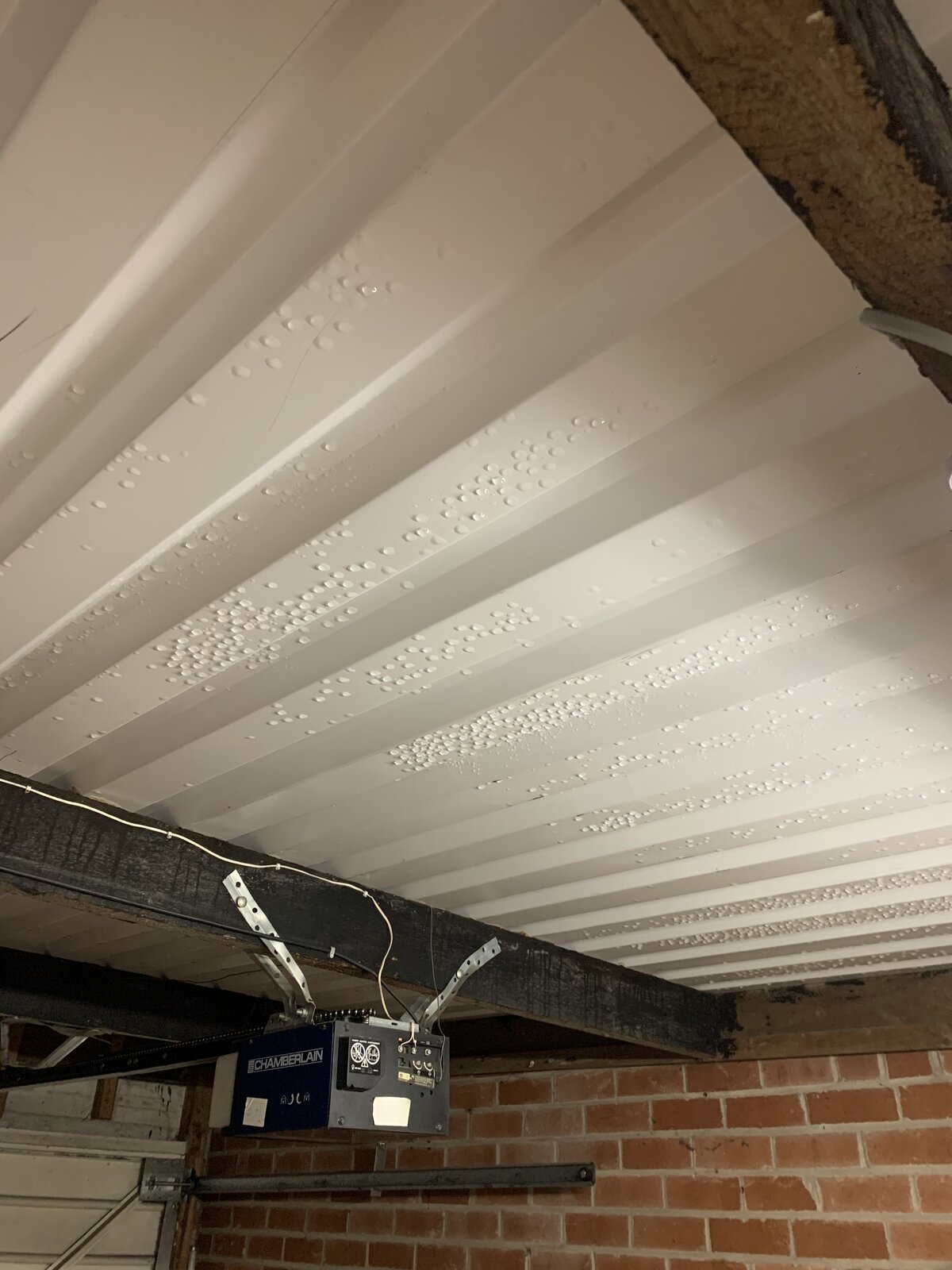

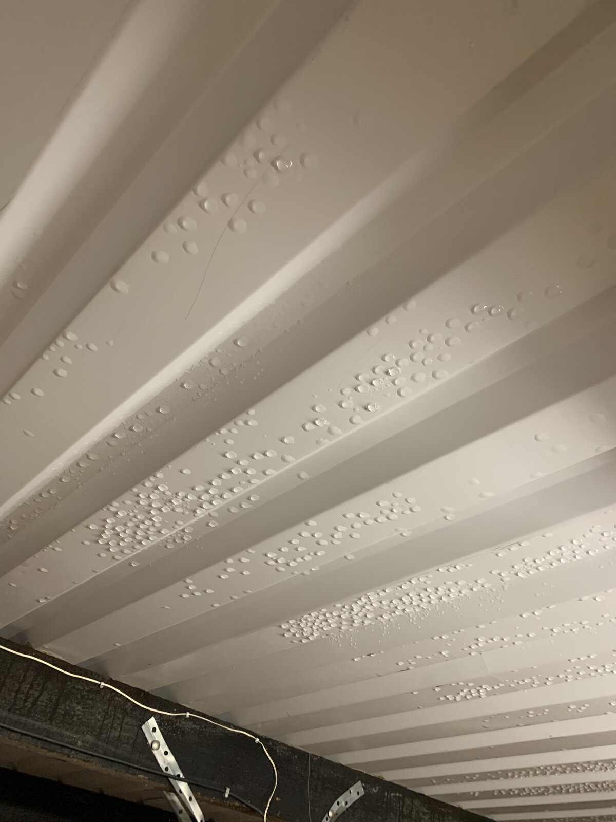

My garage seemed to have gone so damp since I changed to a double glazed window.
There is virtually droplets of water on the tin roof that makes anything inside the garage damp.
How can I sort this out ? Make some holes and put a couple of air bricks or vents ?

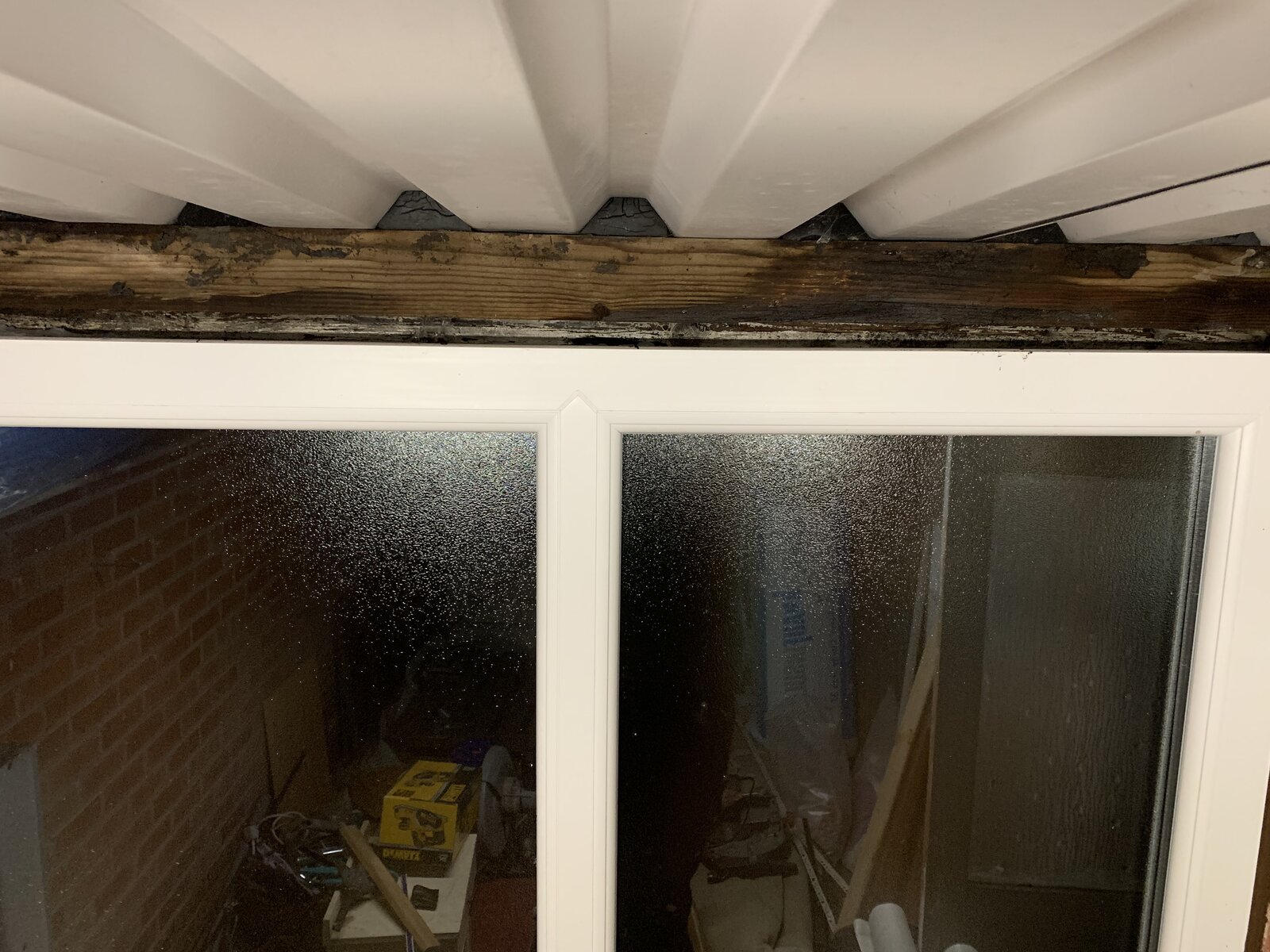

it makes the support timber wet that will rot soon.
Insulation on the underside of the metal roof will help a lot with that. Assuming you park a car in there, it will help to leave the up and over door open a little, after parking a wet car in there.
