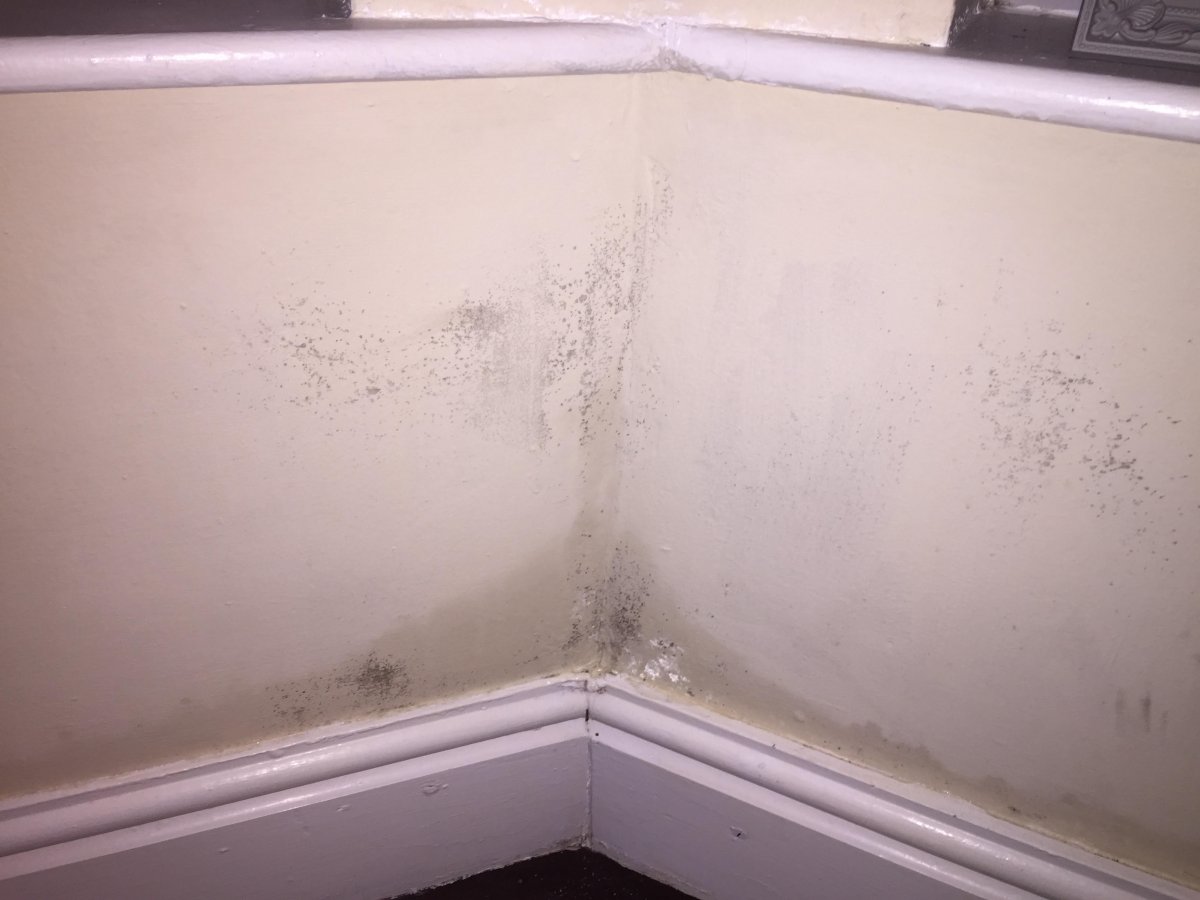

Hoping some damp experts out there can help me out with this one.
My property has damp under my bay window. My first thought was condensation, as it is probably the coldest wall in the room, the heating has been on a lot over winter and there is usually a sofa in the bay window. I repainted the wall in question 6 months ago and there were definitely no signs of damp. Could this be condensation build up or is it possible that penetrating damp has appeared within 6 months? I've added a few pics.
Thanks in advance.

Condensation.
Do not put the couch or anything against the wall.
Apply neat bleach to get rid of the mould.

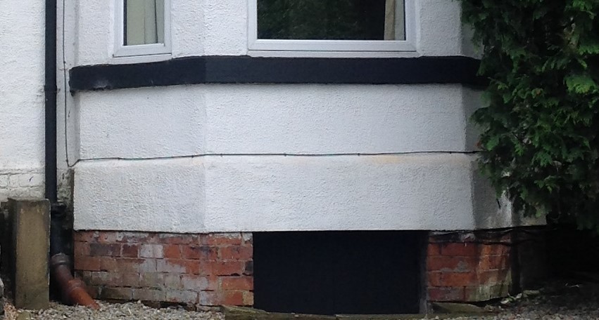

Can we have a photo of what's on the outside of the window ?
It's very mouldy so I'm going with condensation. If it's that much colder than the rest of the wall, presumably there's a thermal bridge. Or it could be excessive humidity.
If it's an excessively cold wall I'd be tempted to line with a thin layer of celotex and plasterboard, but if your humidity is high it'd end up condensing elsewhere.
It appears to be "Black Spot" condensation - however, there are indications that previous "remedial" work has been done in the bay.
As above, thermal bridging could be playing a part?
If you are on the ground floor with a cavity wall then it could be cavity debris blockage bridging?
Leaving the bay clear of furniture and watching and waiting for a few weeks will give a more clear indication of whether its simple condensation or perhaps something a little more complicated?
DaveHerns is right , lets see what is outside that bay with some photo's
Check your guttering and make sure water is going down the pipes and not elsewhere.
Is the ground outside high relative to the floor inside?
What is the wall construction or if you don't know what is the age of the property and where is it?

That wall looks wet in places and certainly you have some condensation but that may be secondary to wetness due to another problem. Any outside wall that is wet through will conduct heat away creating conditions for condensation.

I've attached a pic of the outside, there doesn't seem to be any obvious crack or damage in the render that would cause water to get in.
There is a gutter but in runs to the side of the bay window and isn't leaking.

Judging from the angles in the first photo's the damp is at the corners just before the main wall.
On the one side I would check that downpipe when it is raining to make sure water is not coming out of a bad joint and soaking the brickwork or even if the drain is blocked. However that does not seem likely to be repeated on the other side hidden behind the bushes, but is the runoff from all those leaves going down the side of the house? I would certainly recommend cutting the growth back. Other than those potential issues I can't see anything else externally that would would cause the the wall to be wet and cold where previously they were OK
I seriously doubt you have a cavity wall construction although you may have two skins of brickwork the gaps between them will be full of bits of mortar and every now and then a complete brick will be laid across the two skins. That will be what I would call a solid 9" wall. So any external soaking can easily be transmitted through to the inside.
Does the window sill have a drip throating groove underneath - it should run all around the sill pieces?
The PVC frames seem to have been recessed into the render - & the bottom rails are not true sills and dont project to shed water as sills should.
Do your frames open?
The plinth like piece that also acts as a lintel over the basement door - the top edge of this plinth forms a lip or ledge, and could be holding water that then penetrates through the render and brickwork.

The damp patches are actually in the middle and left hand side (looking at it from the outside like the picture)of the bay window.
The black plinth does have a drip grove and there is no water running down the face of the render. The paint used is regular exterior masonry paint.
