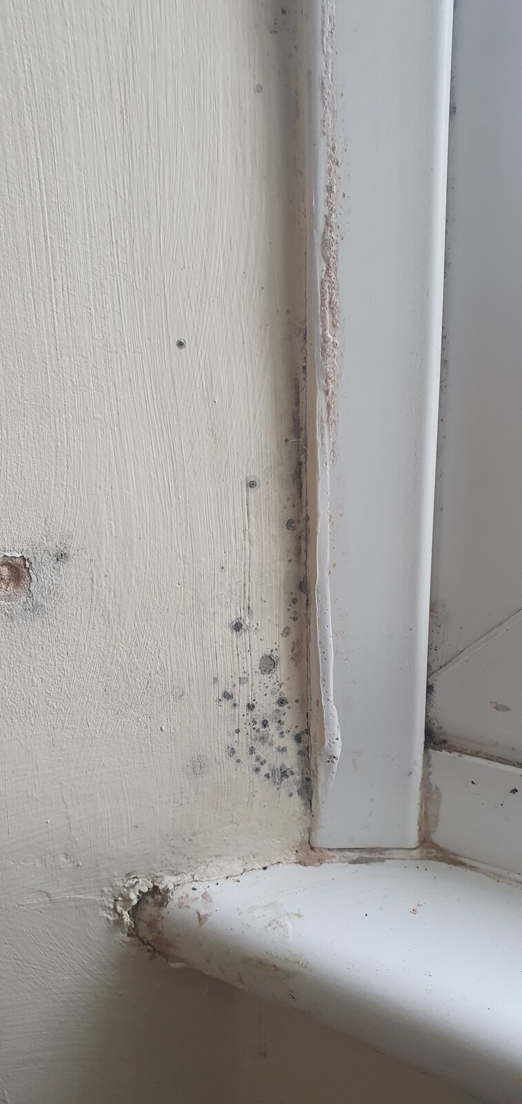

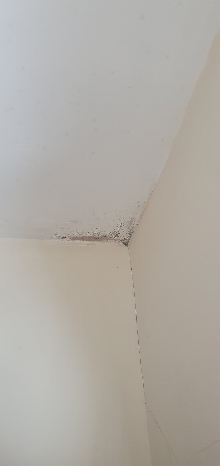

Hi all,
This is my first post and with a house full of jobs to do, it probably won't be the last!
We have an issue with mould in the main bedroom which is causing some concern.
Nowhere else in the house seems to be affected though.
We do have lots of condensation on these windows in this room pretty much every morning, and for a while, there has been a mouldy patch in the top corner (Maybe 3 / 4 inches across). It never seemed like a big deal, and a few times I just cleaned off the mould with some JML mould killer spray and we never noticed any other issues. (other upstairs windows get condensation on them, but not as bad, and there is no mould elsewhere that we have seen)
I assumed this mouldy patch was a because of condensation from the windows, and that occasional cleaning would suffice.
Just recently, the mould got a lot worse, and it starting to spread into the other corner, and above the window.

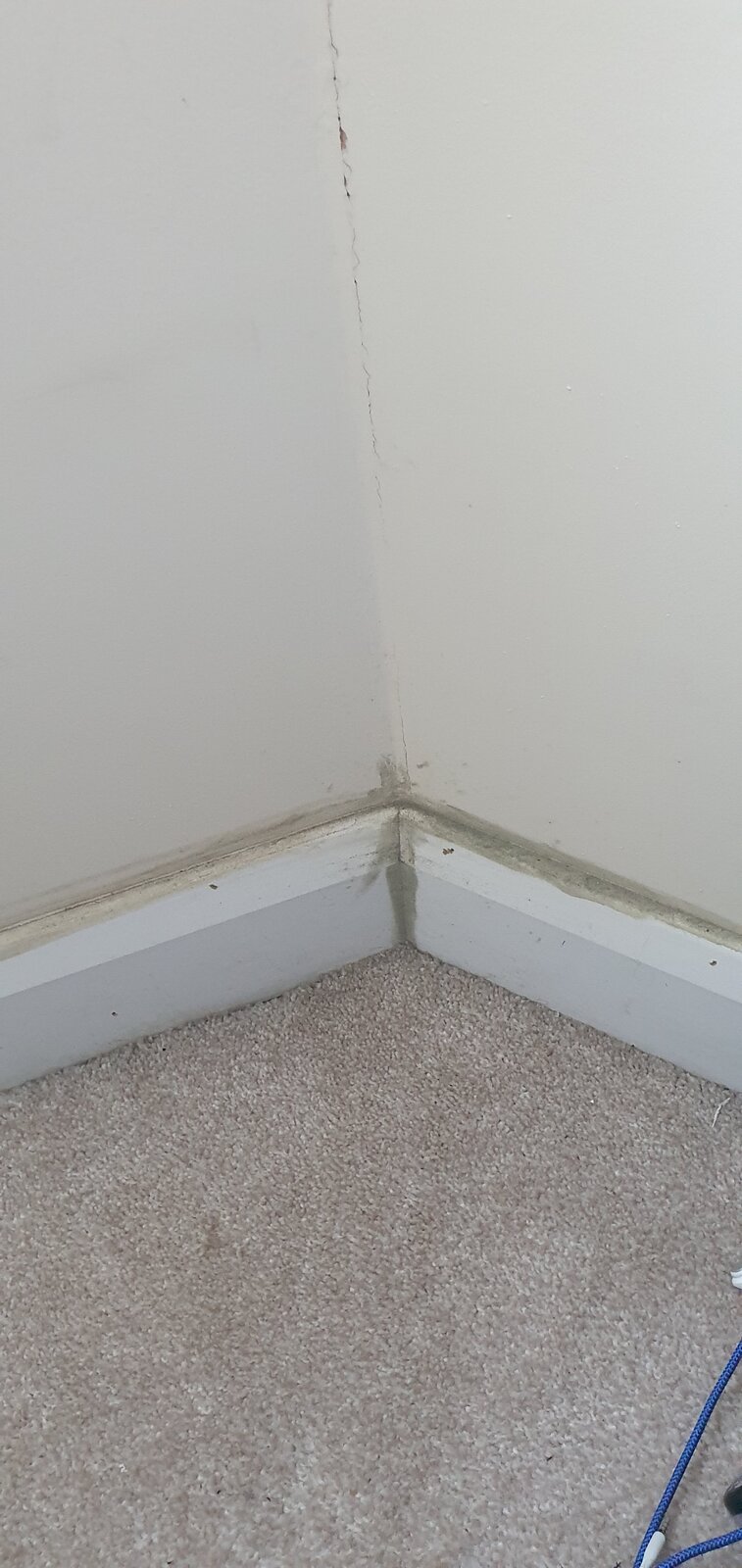

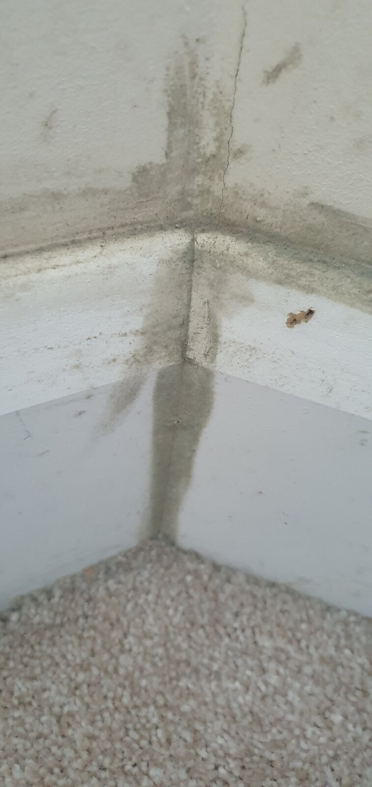

I also noticed on the skirting boards, around the bay (The bay is tiled on the outside) there are dirty marks, and it looks like water / condensation rising is up above the skirting. (this has looked the same for a long while and they were never actually painted)
We have built-in wardrobes, and we noticed a musty smell from those a few days ago, and lots of the clothes have started to go mouldy in there too. OUCH!

So, I know that condensation is a problem in general, but apart from working from home (in this bedroom all day), nothing has really changed much which would explain why it’s suddenly got a lot worse.
We have been making an effort to shut the bathroom door and open the window when showering, we put lids on pans when cooking and close the door to the rest of the house. We have stopped drying clothes on radiators and use a fully vented tumble dryer. We dry down the windows each day (and they have been lots less wet since we started taking all these steps.
I remember when we had this room skimmed about 5 years ago, the side wall took a little longer to dry than the rest, but thought nothing of it at the time.
So, as I said, I know there are issues with condensation, and we have an electrician booked to come and fit a new extractor in the bathroom, and we will sort the cooker hood ASAP
But I feel that there could be something extra going on here, otherwise I think we would have mould in all rooms. (maybe that's faulty assumption!?)

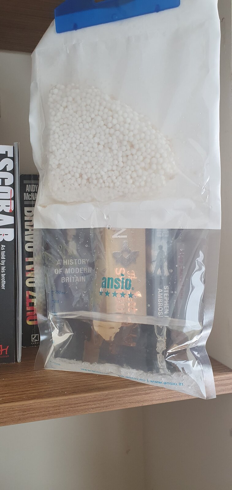

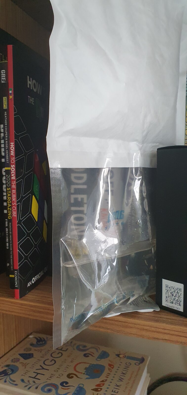

I did hang a couple of those wardrobe dehumidifier packs a couple of weeks back and at the time didn’t realise there was mouldy stuff in there!, they have been there for a week and half now, and they have collected up a fair amount of water (see pictures) which probably makes sense if all the clothes were full of moisture!

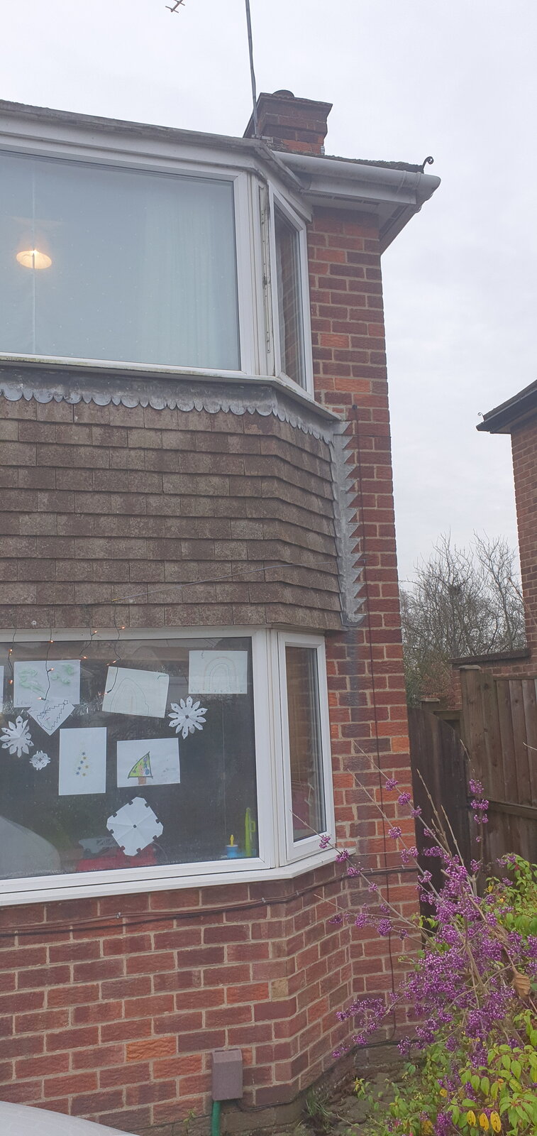

I took a few pictures, which show the corner where the mould was (I cleaned 99% of it off) so it looks a lot better than it did.

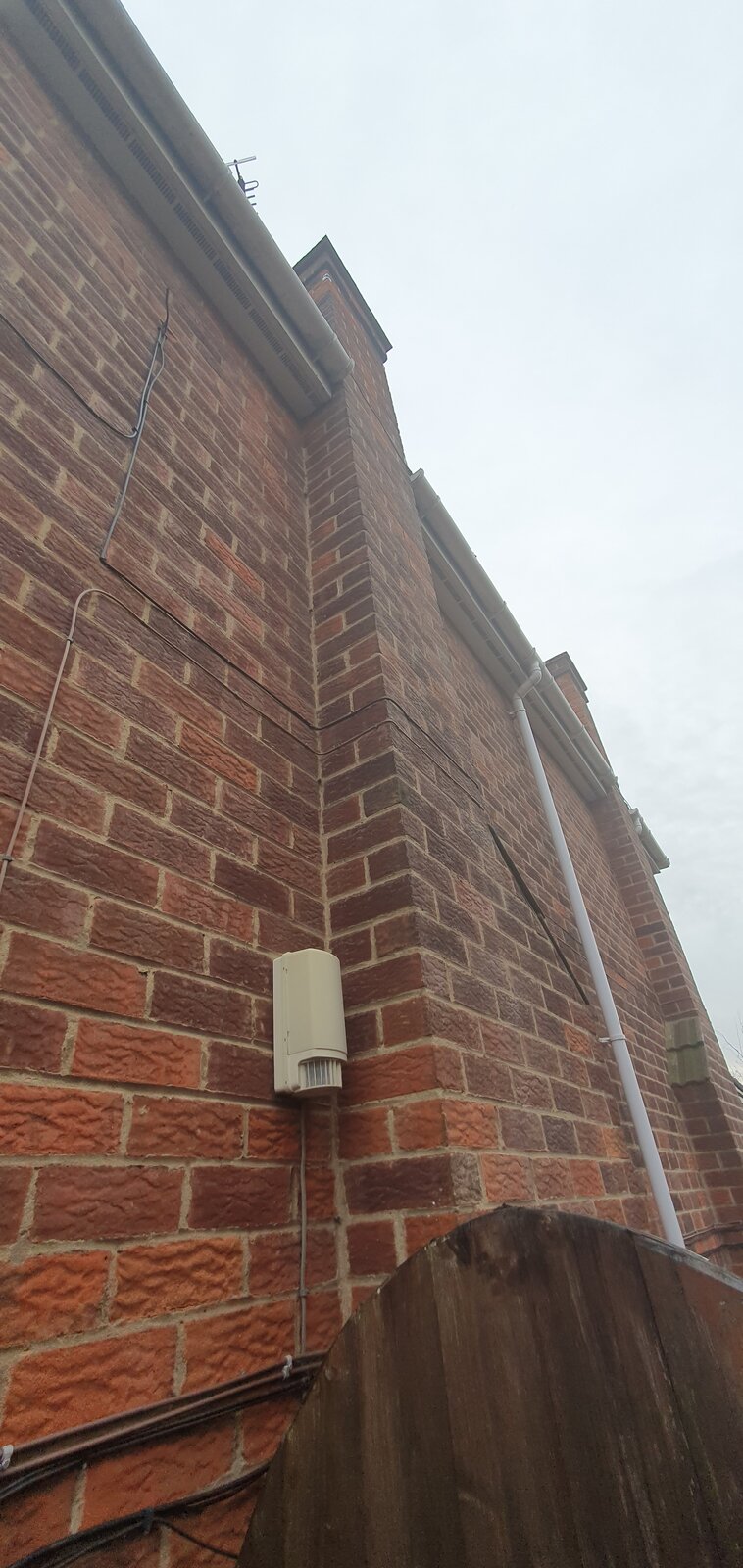

You can see the inside of the wardrobe, the skirting boards and a picture of the outside of the house on that corner.

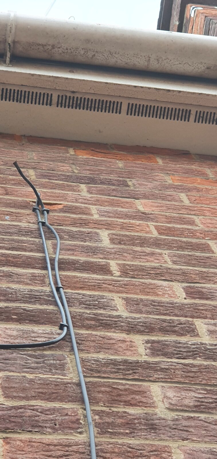

I did notice that there are a couple of bricks that look a bit damaged, although it's hard to tell from the photo as it’s a long way up and I don’t have a ladder long enough to get anywhere near. There is a chimney breast on that side of the house (and in the bedroom, that is hidden behind the wardrobe, so slightly concerned about that and what sort of state the wall is in behind there.
