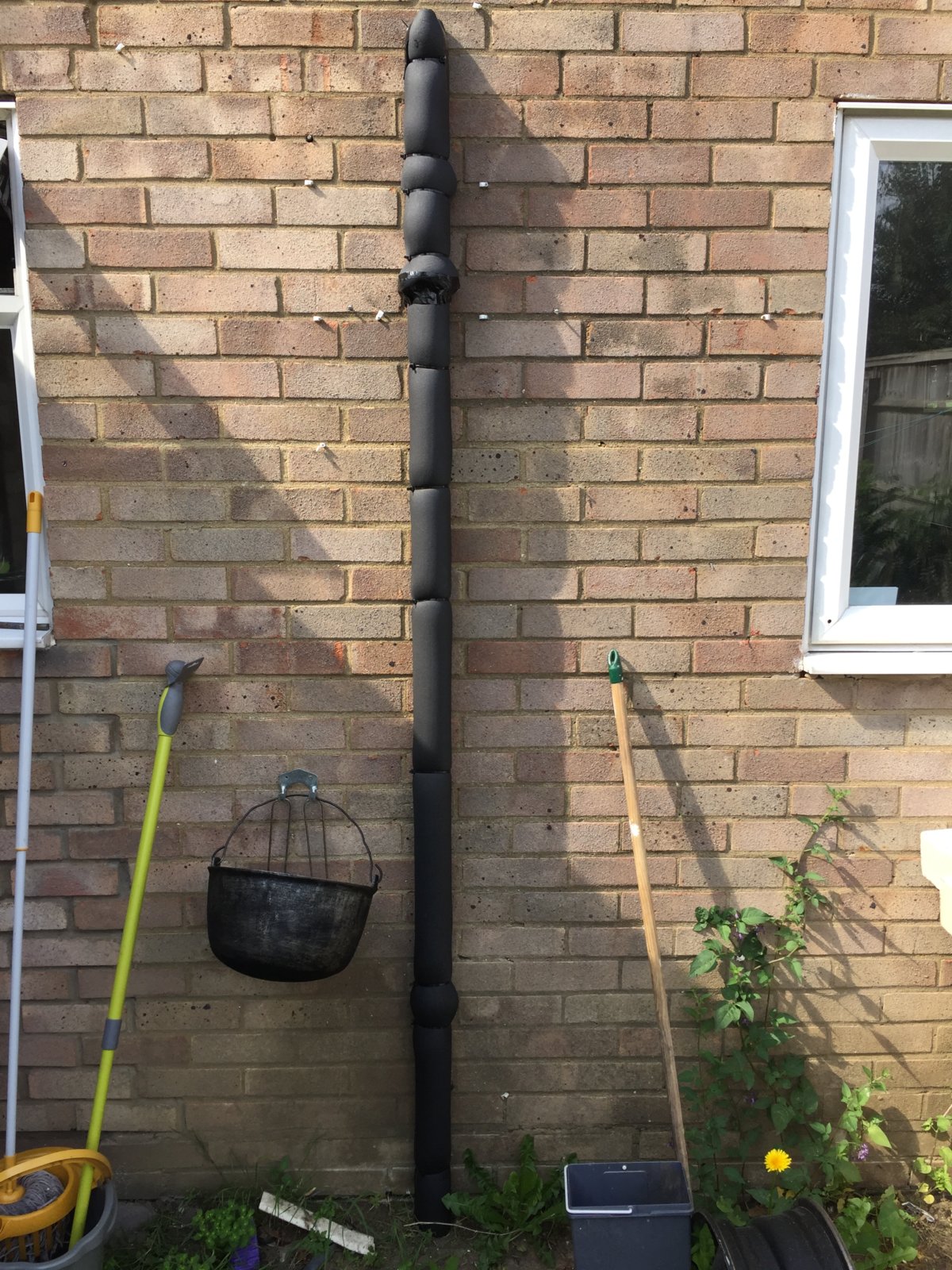

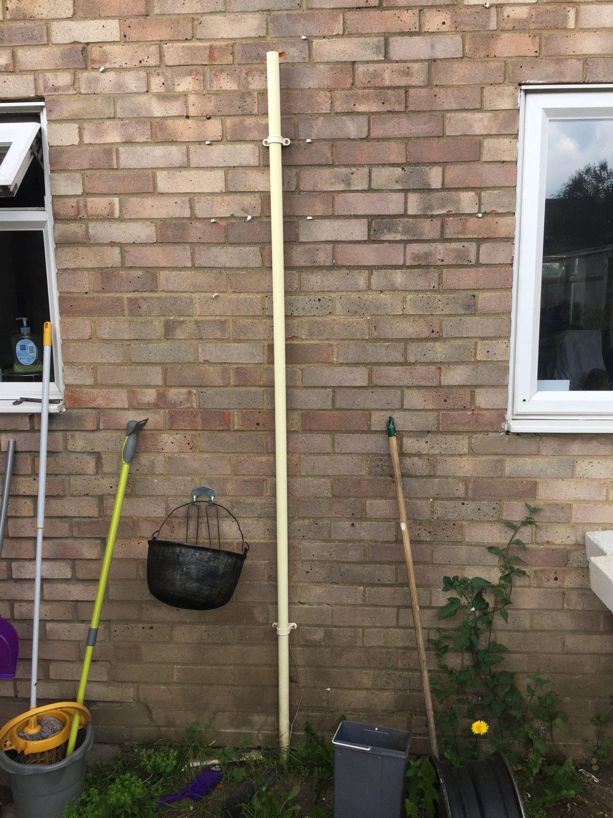

UPDATE: here’s how the pipe was:
I’ve now wrapped the new lagging around it:
Not exactly picture-perfect but, functional I hope

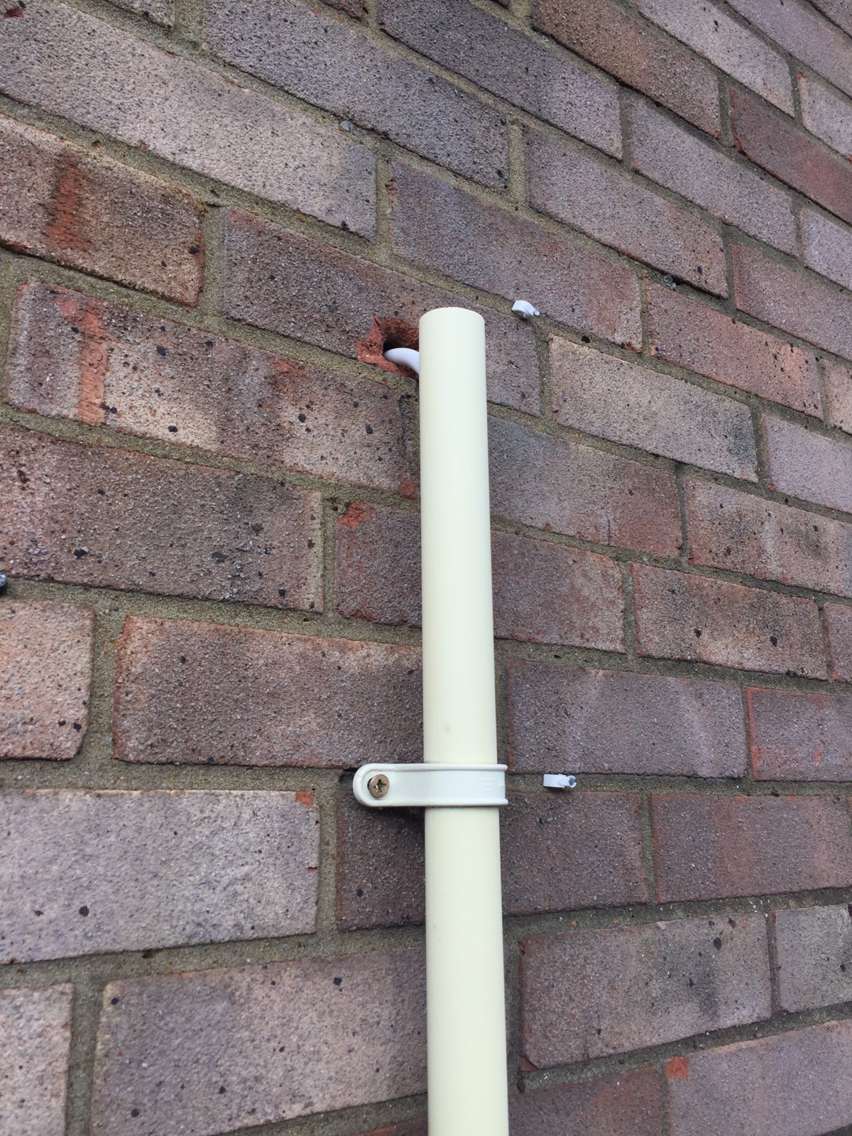

the condensate will not have been freezing inside the vertical pipe, it will have been freezing where the condensate pump tubing goes in to the downward pipe, you need to get that sorted properly and not by the idiot that installed it like that
yup +1. Its not the white 32mm pipe that's the issue. It's the 12mm clear pipe from the condensate pump that is coming through the wall that needs sorted.
The 32mm pipe needs to be cut through the wall and run inside and then the clear plastic pipe is connected to it in there. If it was installed like that I would also be looking to see what the 32mm pipe runs into at ground level. It shouldn't just be stuck into the ground, it should be fitted into a plastic soakaway tub that is filled with limestone chips.
