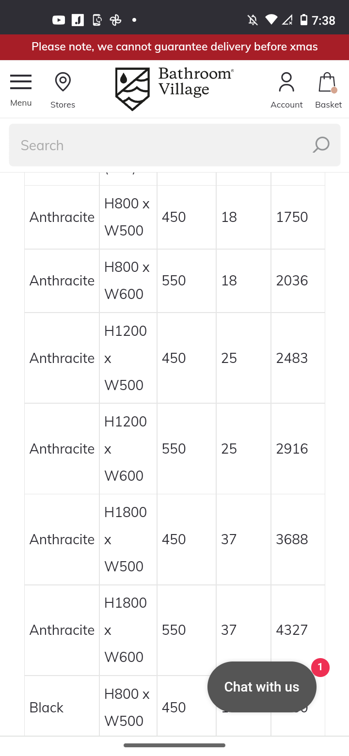

I've been getting conflicting advice on towel rad for an ensuite. The ensuite is 1.9square x 2.5m high.
Online I'm getting it's coming in at 1600btus for a bathroom thst size with one exterior block wall and a room above it. The ensuite has an insulated plasterboard ceiling also.
In store they are telling me I need 2500btus but also telling me this towel rad is very small for it. It's a 1200x500 black towel rad and in the broucher it's saying 1974 - 2483 btus .
Personally I oversiz towel rails as people block the heat with guess what ?Correct towels
Maybe this is what they where on about in store. This rad is in my budget. Anything else in that color is difficult to get before xmass with them btus for my budget. If it was ok to use, I'd purchase it.
As above. Get one big enough to hold one or two bath towels and still give out a bit of heat
