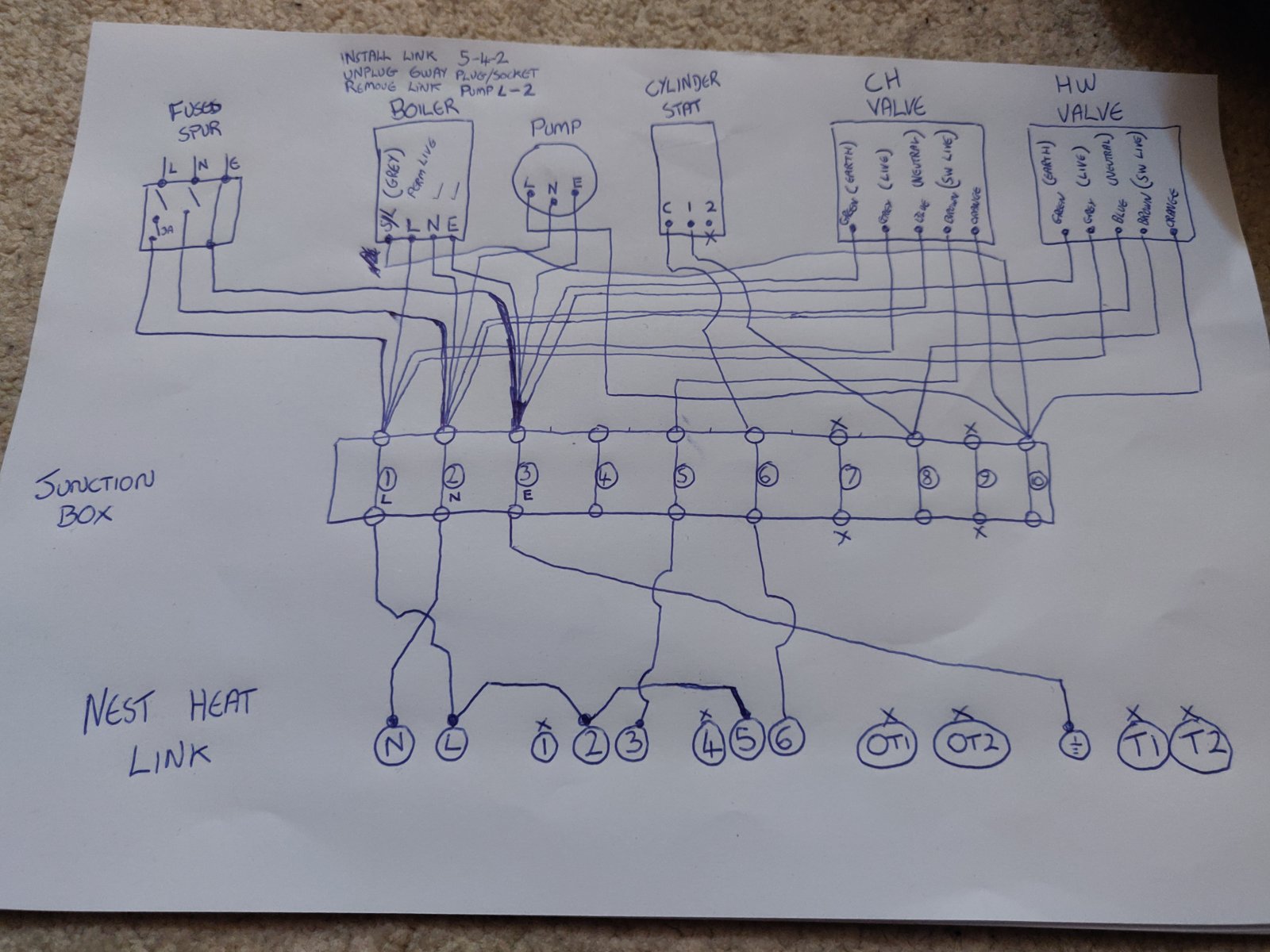

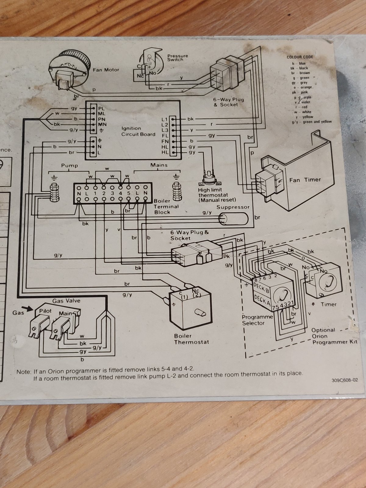

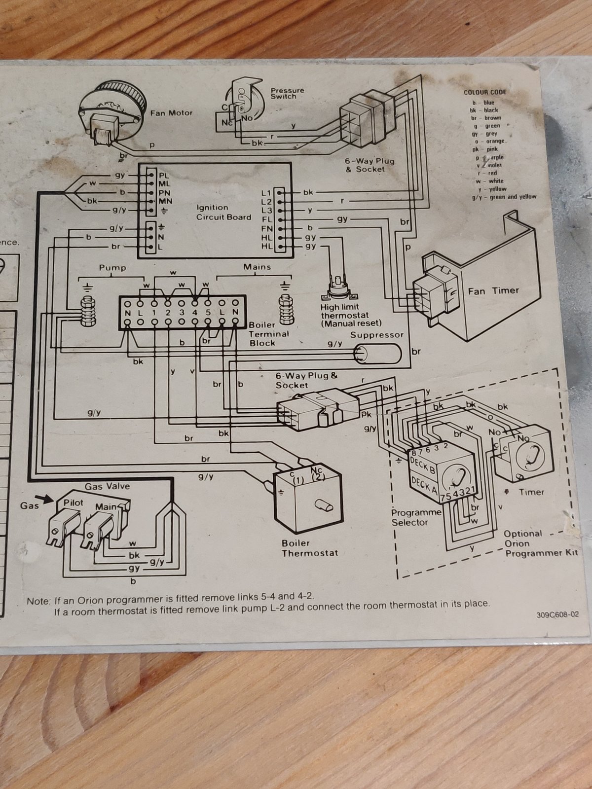

That's where I am struggling I'm unsure on what connections I pickup on the boiler. Refering to the boiler instructions.

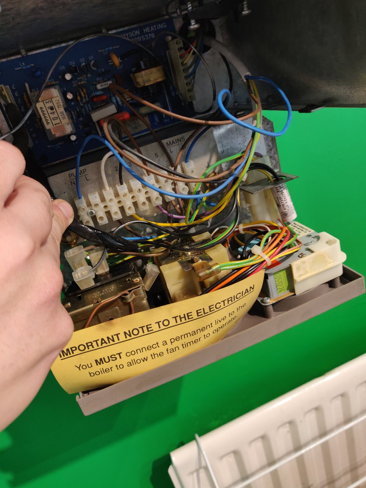

you will need to say which boiler you have, it will definitely need at least one live and possibly a secondary, most boilers need a permanent live and a switched live, but not all, yours will need at least one
Not sure if need overrun can't see from that manual I posted

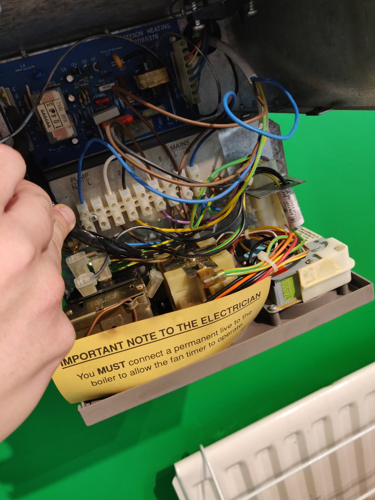

Boiler terminal block... Wiring and alterations can you confirm what's needed here.
Spur is next to boiler and nest junction box is upstairs.
Hope this info helps

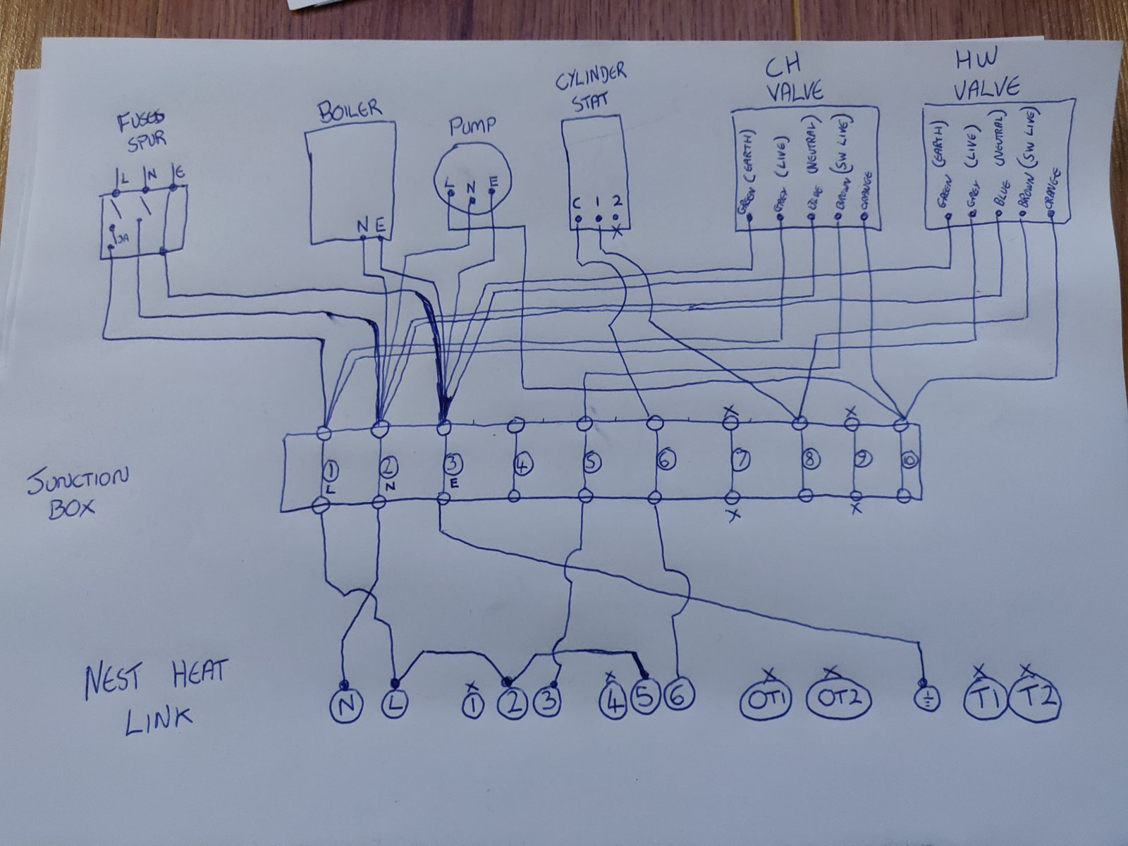

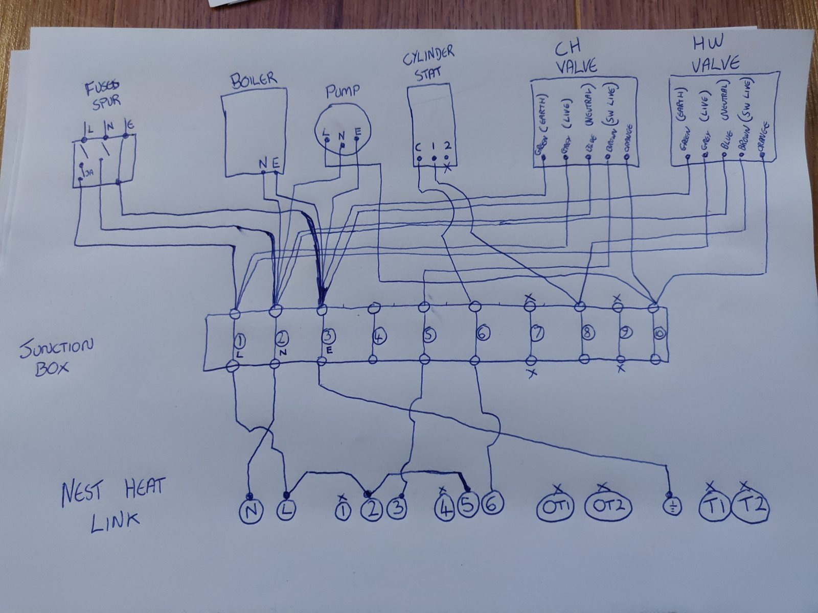

Here's how it's currently wired

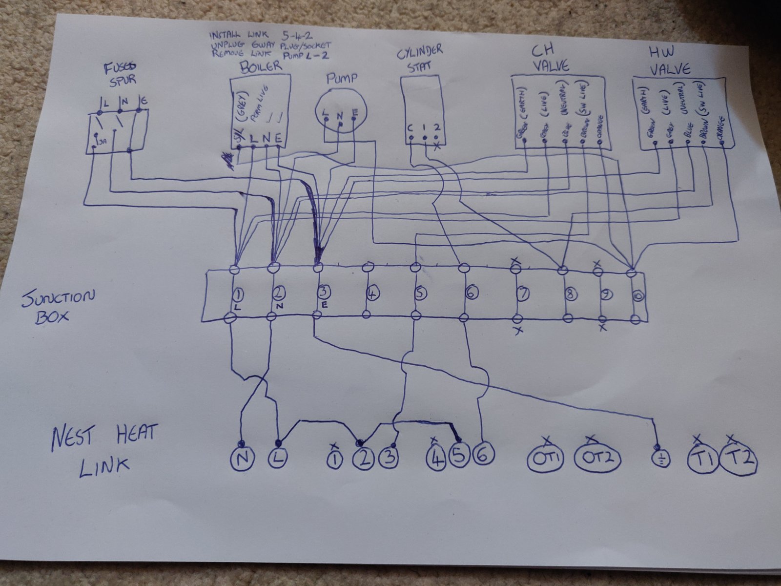

As far as I can tell, it's currently wired without pump overrun but whether that's correct I couldn't tell you, I don't know this boiler.
I don't think it is. I recently had a plumber over and he said if I was to change boiler then I would need to look at wiring for pump overrun so seems to suggest at present it isn't.
Just need to confirm which connector on my boiler my switched live will need to go into then I think I have done it... As well as the link adding and removal on boiler
