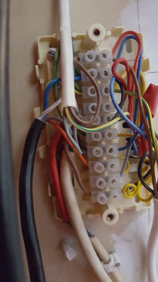

I've had our Worcester Bosch 24Ri boiler moved out of the kitchen into the utility room. It was connected to a British Gas programmer model UP 2, with a remote thermostat and a WT wireless receiver (next to the hot water tank), wired up to the wiring loom (photo attached). The engineer who moved it doesn't do the electrics and I'm waiting for his electrician to get back to me.
To move the boiler its 5 core cable was snipped: live, neutral, earth plus a black and grey.
I believe its a y-plan system, and on the programmer plate 1,3 and 4 were connected.
The wireless receiver, which is above the wiring loom, has 4 cables which come into the loom to these numbers
Brown - 1 (Live)
Black - 2 (Neutral)
Grey - 4 (opposite programmer heating on)
Earth - 5 (opposite the valve white)
I'll try and explain how the loom's wired up, apologies for the basic-ness and wrong terminology.
WT = Wireless Thermostat (edited to add I mean receiver here!)
HP = Heater pump
D = Diverter
B = Boiler
TT = Tank thermostat
MP = Mains power
1 - WT, B, MP Live
2 - HP, D, B, WT, MP Neutral
3 - HP, D, B, MP Earth
4 - WT Grey + Prog heating on
5 - D white and WT Earth (green/yellow)
6 - TT Blue + Prog HW on
7 - D Grey, TT Brown and HW off
8 - TT sheathed earth(?), D orange bridged to 9 - B grey
10 - HP brown and B black
The new thermostat (a Hive) doesn't transmit to the BT wireless receiver, and all the wiring plans I see all show a room stat in them however I won't have one wired in. Of course there's a room stat but that only talks to the received which is by the boiler and wired up to the loom.
So how do you wire the loom without room stat coming directly into it? Should I now use all 4 connections on the backing plate, previously 2 (heating off wasn't used)? If so what does that wire into?
I've searched high and low for a diagram without a room stat but I can't find one. Can anyone shed any light?
Thanks in advance
Mark

The Hive receiver will just go onto the same back plate that the UP2 programmer was on.
You don't need a connection to number 2.
The wireless receiver should be completely disconnected and a link put in between terminals 4 and 5.

You don't need a connection to number 2 on the Hive receiver (heating off)
Just completely disconnect all the wires going to the old room stat receiver and put a link in between terminals 4 and 5 in you wiring "loom" (or centre as we call it)
The hive needs a new wireless receiver which replaces your UP2.
Wireless stat receiver WR1? Gets totally removed. White wire from MPV goes to 4 on back plate.
