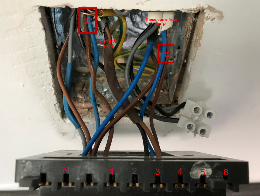

Hi All,
First of all, thanks to all who can assist in my project of replacing current controller/thermostat with Nest.
To set the scene
- New build house which has an Ideal Logic Heat H24 Boiler (OpenTherm compliant)
- Danfoss FP715 controller at the boiler
- Wired Thermostat in the hall way
- Wireless Danfoss thermostat on the second floor master bedroom
- Megaflo tank in airing cupboard
I think i understand what i need to do, however, i wanted to clarify before i run in to trouble :D
Wiring at the controller (As is)
L - Live - 3 wires (3 brown)
N - Neutral - 3 wires (2 blue and 1 grey)
1 - DHW Off - No wires
2 - HTG Off - No wires
3 - DHW On - 1 Black wire
4 - DHTG On - 1 Brown wire
5 - Remote sensor - 1 wire (blue)
6 - Remote sensor - 1 wire (brown)
Assumptions
- 5 and 6 - are the 2 wires that go to the thermostat in the hallway.
- L - has 1 wire from boiler, 1 from fused main, 1 from upstairs Megaflo?
- Wires (Grey and black) combine in terminal block
Wiring at the Nest Link (To Be)
L - Live - All Live wires
N - Neutral - All Neutral wires
1- DHW Off - Nothing
2- HTG Off - Nothing
3 - DHW On - Nothing
4 - DHTG On - Nothing
OT1 - OpenTherm wire 1 - Black wire from old connection 3
OT2 - OpenTherm wire 2 - Brown wire from old connection 4
Earth - for T1 and T2 (If used) - Add a earth cable and wire to back box
T1 - 12V DC Power - Wire from connection 5
T2 - 12V DC Power - Wire from connection 6
I have attached a image of the current wires, sorry if it not too clear but i have tried to provide as much information as possible. Going of the manuals, since the system is OpenTherm i have assumed since i only have 2 possible wires (Negating Live, Neutral and Thermo stat) that i need to wire in to the OT1 and OT2 connections on the Nest.
Also, i guess the wireless thermostat i have on the second floor would need to be replaced with another nest thermostat and becomes redundant.
Thanks in advance again to anyone that can help.
Much appreciated.
Bob.
ok guys....so have done more reading...
Looks like i connect as below....
1- Satisfied (Heating) - Nothing
2- Common (Heating) - Loop Live to here
3 - Call for Heat (Heating) - Wire from old connection 4
4 - Satisfied (Hot Water) - Nothing
5 - Common - (Hot Water) - Loop Live to here
6 - Call for Heat - (Hot Water) - Wire from old connection 3
OT1 - OpenTherm wire 1 - Nothing
OT2 - OpenTherm wire 2 - Nothing
Hopefully someone is able to confirm..thanks all.
Be very very careful what you are doing as a lot of new build fitting logics have outside temp sensors and HW off from cyl stat needs to be wired to boiler switch live 2.
If you are removing the boiler cover to alter wires you need to take a gas rate, an inlet pressure, test FSD and carry out a high and low flue performance test.

Why are there two thermostats?
Is the house zoned?
If so, you need two nests, one for each zone. (See the Tip on page 10.)
Why no connections to OT1 and OT2? Have you decided not to use Opentherm?
Is the house zoned?

Page 10 of the Nest Installation instructions.
Opentherm cannot be used if you have more than one zone as they could be asking for different flow temperatures from the same boiler!

I guess that clears it then. Will connect to 6 and 3. And link live in to 2 and 5.
I think the second thermostat is wirelessly connected to the original controller so don't know (battery power) so don't know whether it is a true 2 zone? Not sure how to check.
