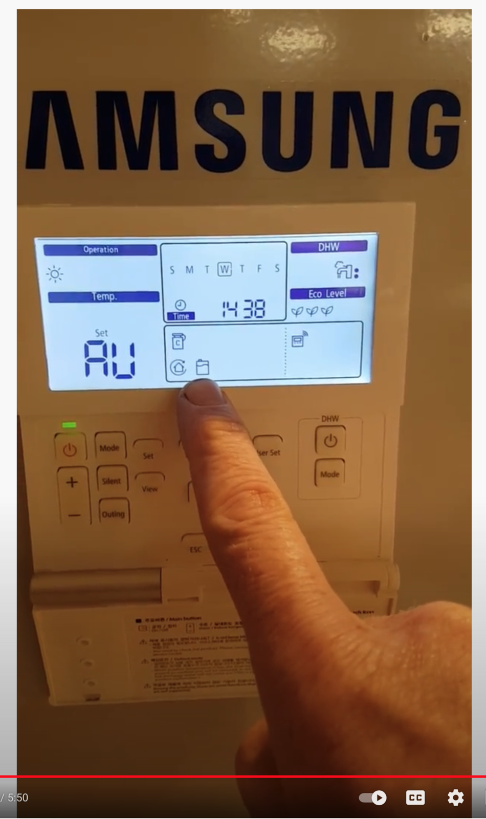

I'm trying to figure out how to use the Samsung controllers that run our heat pumps. Confusingly we have 2 controllers and 2 inverters outside. It seems to me that one is for heating and the other for hot water? Does that even make sense? In any case we inherited this system from the previous owner with zero documentation.
I watched this video to try and understand it:
In the video they state that the control unit should be displaying 'AU' for automatic mode (attached screenshot). However, our controllers display a temperature value, one (which also has the hot water symbol) shows 50.0C while the other shows 0.0C (attached photo).
Anyone knows if that's a problem?

Just time your DHW for 00:30 to 04:30, but heat pump HW is probably set to around 50C with a daily cycle to kill legion.
It's unlikely that your COP at 70C will be better than what you are saving on the go rate.
