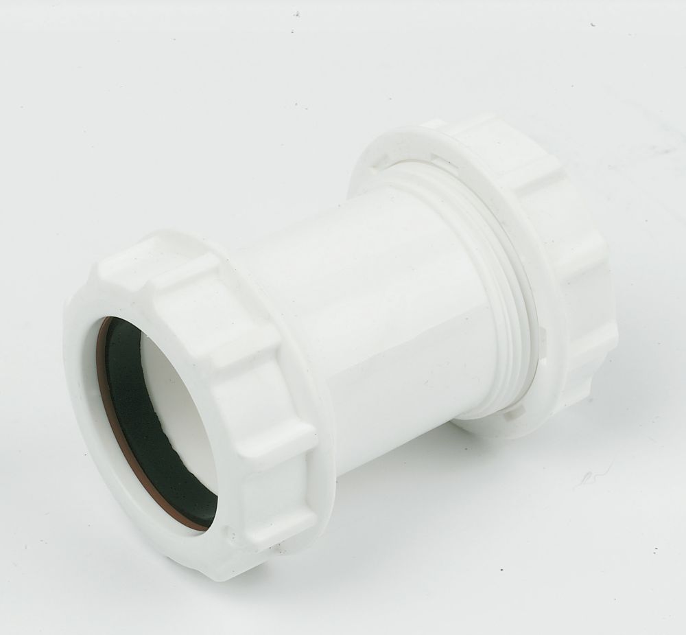

Can I buy a step down adaptor to connect new piping to old?
A universal compression coupler should do the job...

I will give the suggested universal compression fitting a go. Thanks for the suggestions.
I bought the Floplast compression coupler from Screwfix - obviously it's a lot tighter on the new pipe than the old. Even with it done up as tightly as possible I can force the old thinner pipe to move albeit it's not loose as such - think it's going to be watertight?!!
