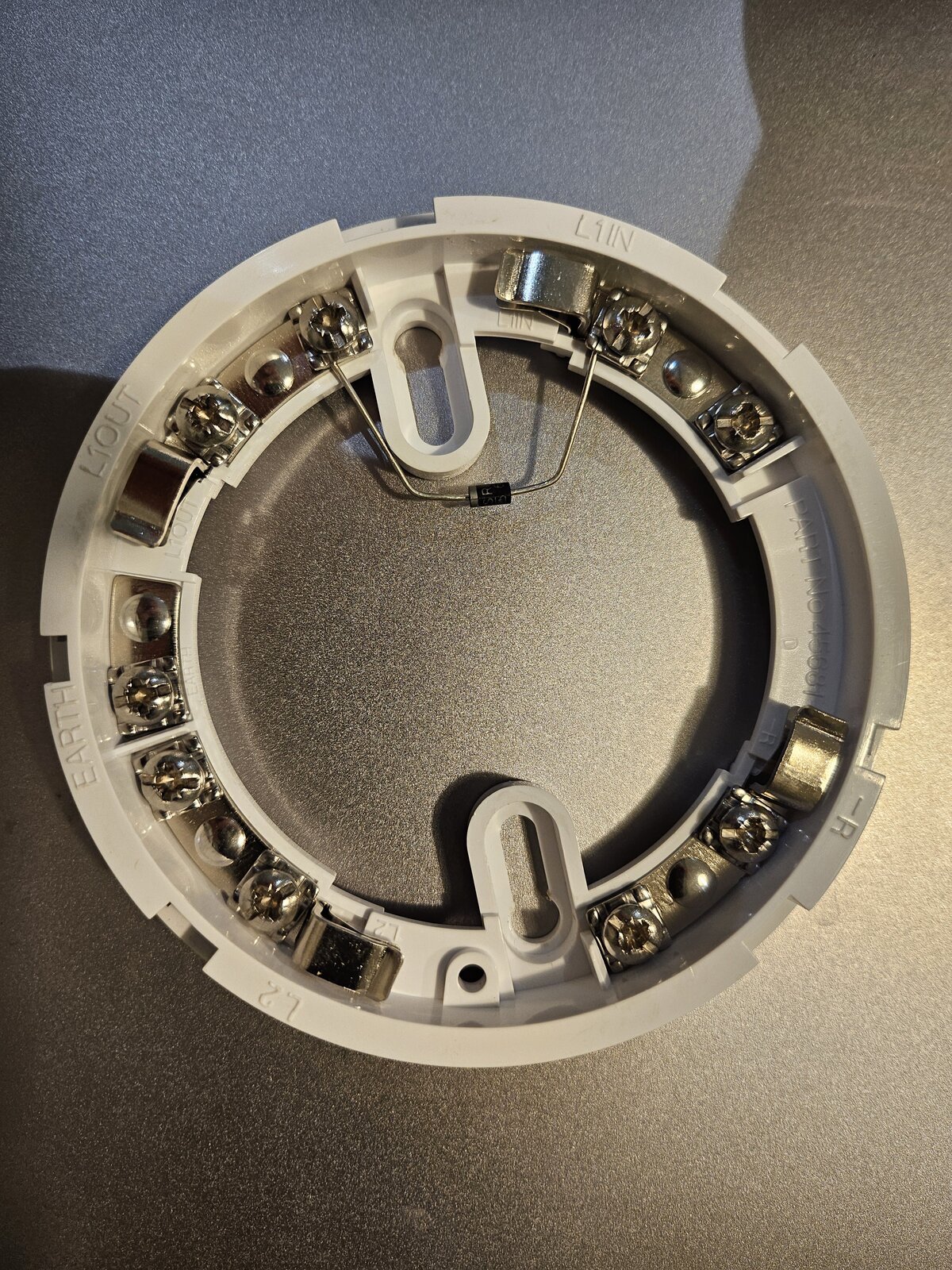

Hi there
I have installed two Texecom Elite systems, one in the house, the other in the garage. I want to add 2x Apollo 65 Series optical smoke detectors, I've installed two separate 6x core cables, but need help on how to connect each up to zone, and whether I need to wire in resistors.
Hopefully someone can advise which terminals I need to connect for power and the NC wires.
I've attached a photo of the base.
Pete

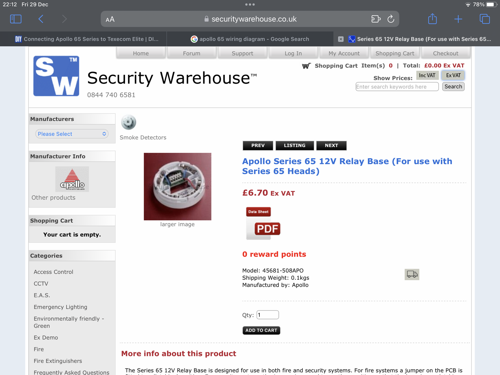

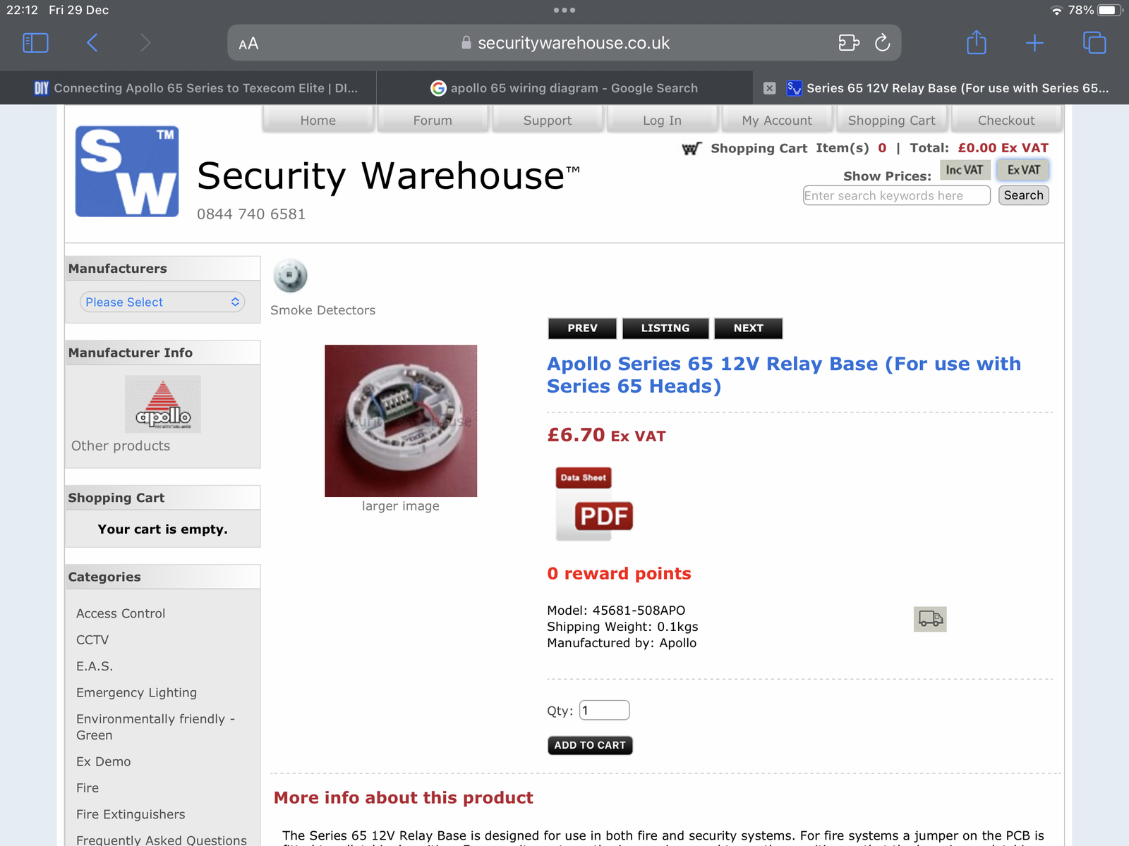

You can’t without the correct 12v relay base …..would have been cheaper buying the correct device in the first place ….

I've had these for a long while and wanted to see if they could be installed. Thanks for the info on the base, that is helpful.
