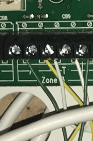

Hello,
I have an Elite 48 setup with working PIR zones which are wired EOL.

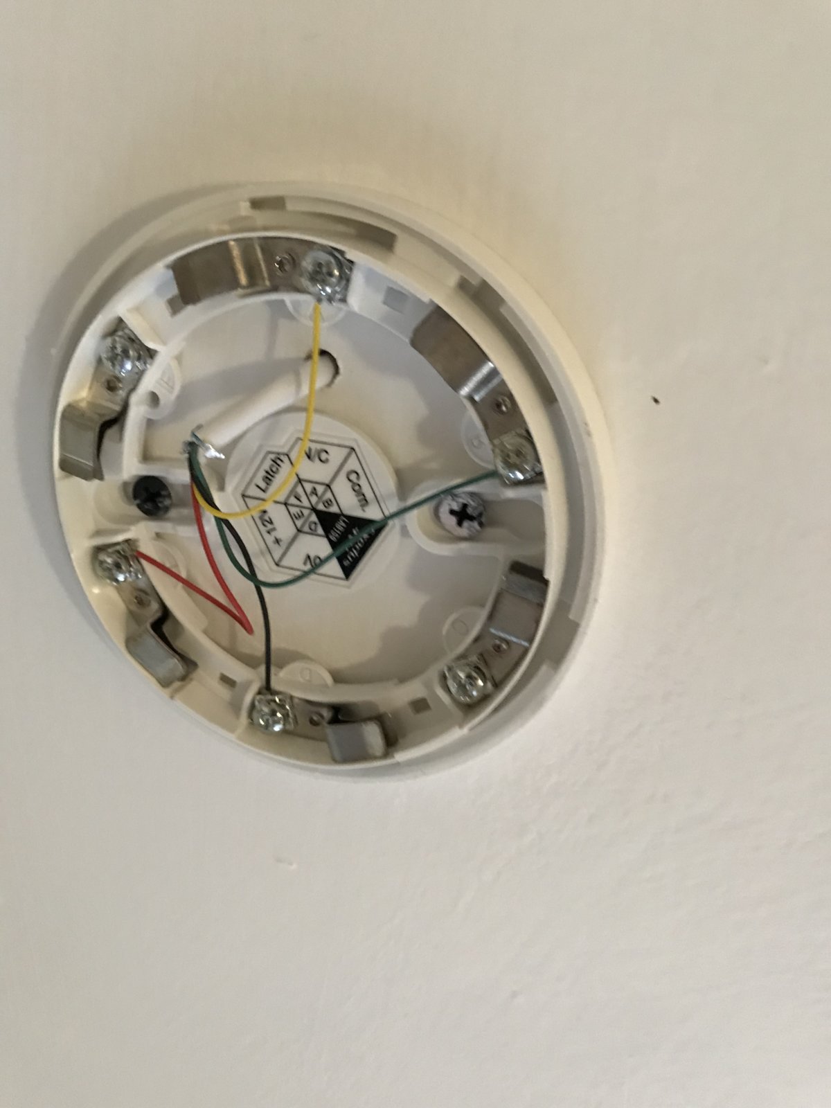

I have 2 zones which are Fire zones connected each to a Texecom 4W smoke detector.
My current wiring is:
Panel Smoke detector
Zone A (N/C)
Zone B Com.
The tamper terminals for the zone in question are linked together.
The 12V & 0V are wired in as well.
In Wintex I have the zone set to 'Normally Closed'
The problem is the zone never detects, it is always Secure and never activates.
Any suggestions much appreciated!
Apologies, it was better spaced out when I typed it! The A & B refer to the terminals on the smoke detector.
Here’s the photo of the smoke:
here’s the panel:
The tamper terminals are linked together with the white wire.
Ok that looks ok ...you shouldn’t have to set the zone to normally closed when using a premier 48 just leave at EOL and wire as picture , have you set that zone as fire ? And set to a Area ... have you tried the test button on the unit ? Or just twist the head out in unset mode ?
Thanks @sparkymarka , that was it, I changed the setting this morning and all now works as expected. Couldn't see the wood for the trees!!
