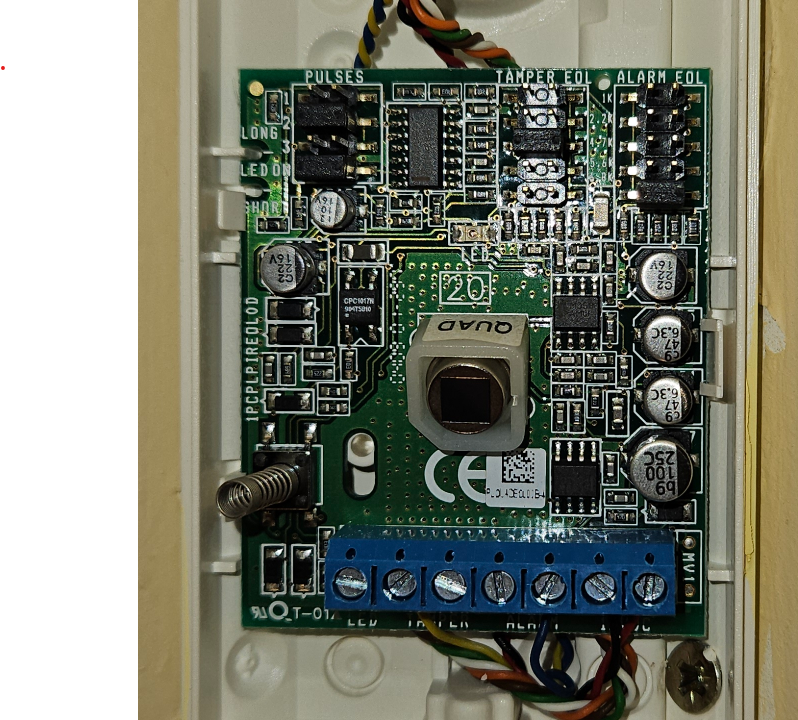

Hi,
I'm looking to connect existing wired PIRs in to a new Texecom Premier Elite 48 panel. The current PIRs have resistors which can be changed with jumpers (currently set as 4k7 for Tamper and 6k8 for Alarm - see attached).
When connected to the Texecom panel and configuring in Wintex, should I configure the zone as Double Pole/EOL or change the resistor value in the PIR to 2k2 for Tamper and 4k7 for alarm and then set in Wintex as 2k2/4k7/(6k8)?
Thanks in advance.
