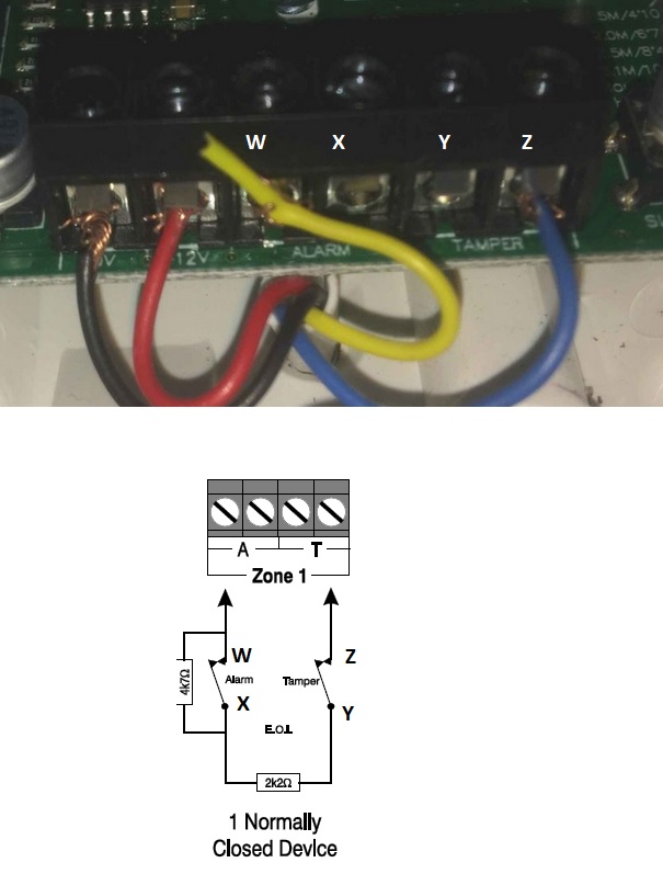

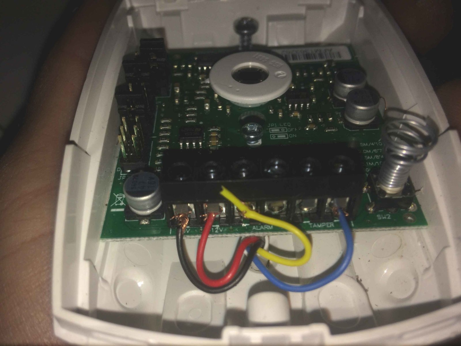

So, i need your help on setting up a wired PIR for my Texecom Premier Elite 64 wireless.
The wireless zones are working perfectly, but a month or so, i am trying to connect a wired PIR in the system but i get the ''Zone 001, Tamper'', i have tried everything but still doesn't work properly.
I use EOL wiring,I set the resistor jumpers to 4k2 for alarm and 2k2 for tamper. The zone 001 on keypad is well assigned to the Z-1 on panel, the configuration on keypad is set to EOL/Double Pole wiring.
I even put real resistors in the circuit and changed the cables,changed system config. on wiring but still nothing happens.
Do you have any idea how this could be fixed? Thanks in advance.

I think you may have left out a connection at the PIR's terminal block.
Cannot be sure without a circuit diagram of the PIR but I think on the PIR circuit board the alarm switch and it's resistor are connected to W and X and the tamper switch to Y and Z
The Alarm switch and Tamper switch circuits are not connected together on the PCB. This means a link or the 2k2 EOL resistor is necessary between X & Y on the terminal block.
The 2k2 resistor may be on the PCB connected in series with either Y or Z in which case a link is all that is needed
The Alarm and Tamper circuits are separate on the PCB to allow for a 4 wire configuration ( 2 for alarm and 2 for tamper )
I would re-make the connections to get rid of those stray bits of exposed copper and the risk of shorting out the 12 volt supply
Thanks bernardgreen for your quick reply.
Do you think this diagram helps?
The problem is that on the panel there is only Z1 for alarm (as shown previously) and can't find the seperate tamper circuit
for a 4-wire connections (panel).
As shown on diagram attached,i think my wiring at PIR's end is ok and the jumpers are correctly set.
It is not the diagram for the PIR. ( diagram has 7 terminals, image of sensor has 6 terminals )
A circuit diagram of the sensor would be more help

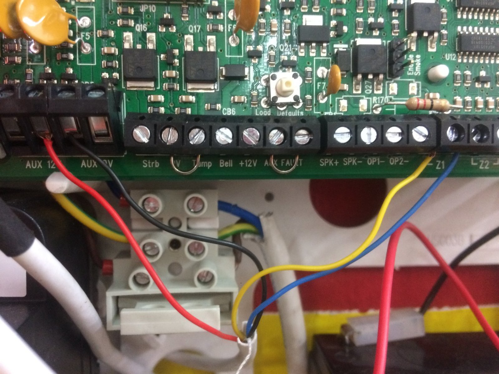

Z1 is alarm and tamper combined on a single pair of wire. The panel reads the resistance between the blue and yellow wires at the sensor.
If resistance is :-
< 2k2 then fault or cable short = requires repair
2k2 then both switches are closed = no alarm or tamper
6k9 then Alarm switch is open = alarm
> than 6k9 then tamper switch is open = tamper or cable cut
Wiring looks ok

So i believe i am corectly wired into the PCB (2x power + 2x zone - since Z1 is alarm and tamper combined)
Unfortunately can not find any circuit diagram of that PIR
The resistance i get when i did the system diagnostics is that '' Zone 001 Tamper > 65 Κ'' (tamper or cable cut as mentioned)
so again,i re-tried changing cables (they work) and closing tamper switch on pir (+manually) but nothing!
i still miss something!

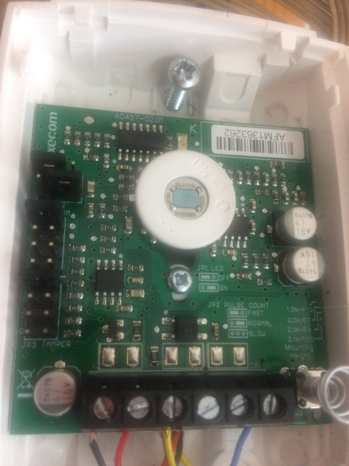

(i also attach the pic with the jumpers on pir (both on A place...4k7 for alarm, 2k2 for tamper)

Make sure blue and yellow wires are in zone 1 correctly
The blue and yellow wire need to be on the outer connections of the pir as you have already got
Check the spring on the pir.
If you are in zone status as I have suggested get someone to hold the spring in on the pir while some also looks at keypad to see what is displaying

Did you get a resistor pack with your control panel?
Put a 2.2k resistor in zone 1 on control panel
If tamper fault clears it is a problem with pir jumpers,tamper spring ,fault on cable.
