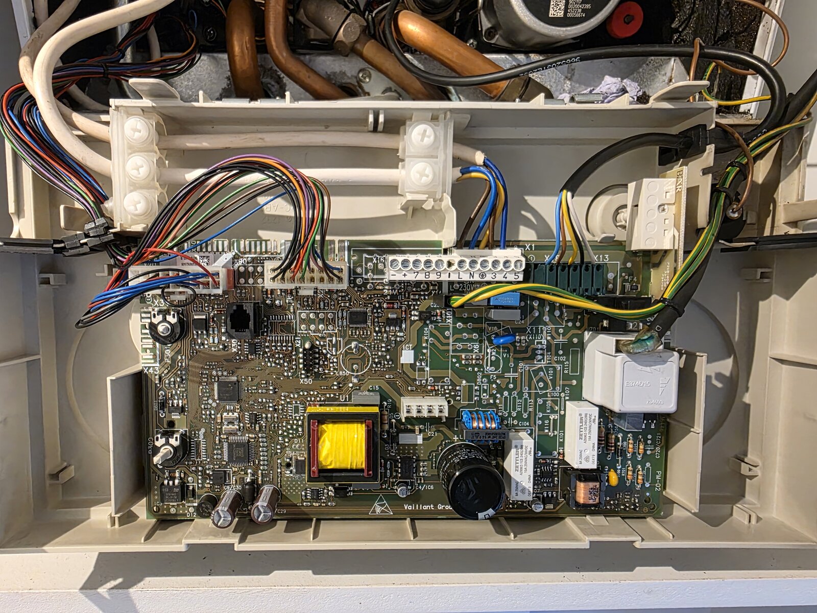

Hi all,
Hopefully someone can help:
I've bought the Drayton Wiser multi-zone kit 1 (single channel) and need to wire the wireless receiver to a Vaillant Ecotec Plus 837 combi boiler.

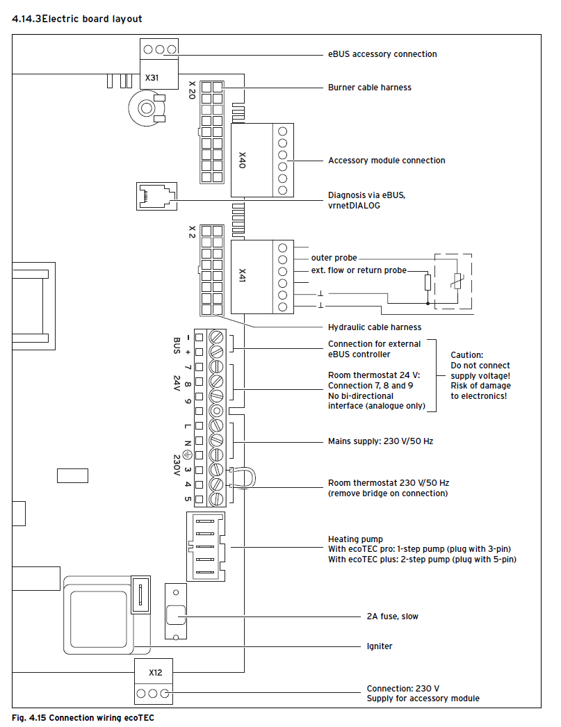

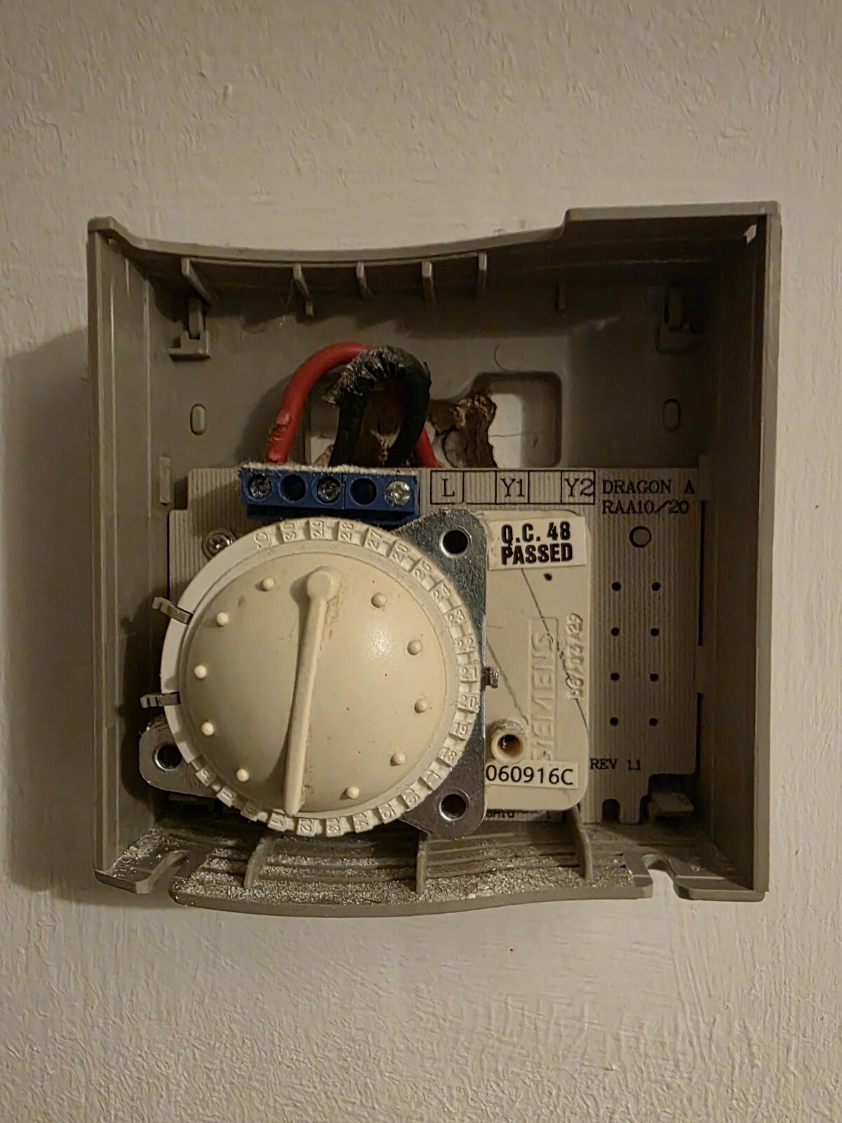

The boiler is currently connected to a manual thermostat (Siemens RAA20) by a live and neutral. I assume these connect to 3 & 4 on the boiler, though I'm a little confused as the neutral is black and the live red at the stat end, but where it connects to the 230V on the boiler it's blue and brown? Is there potentially a connection in the middle?

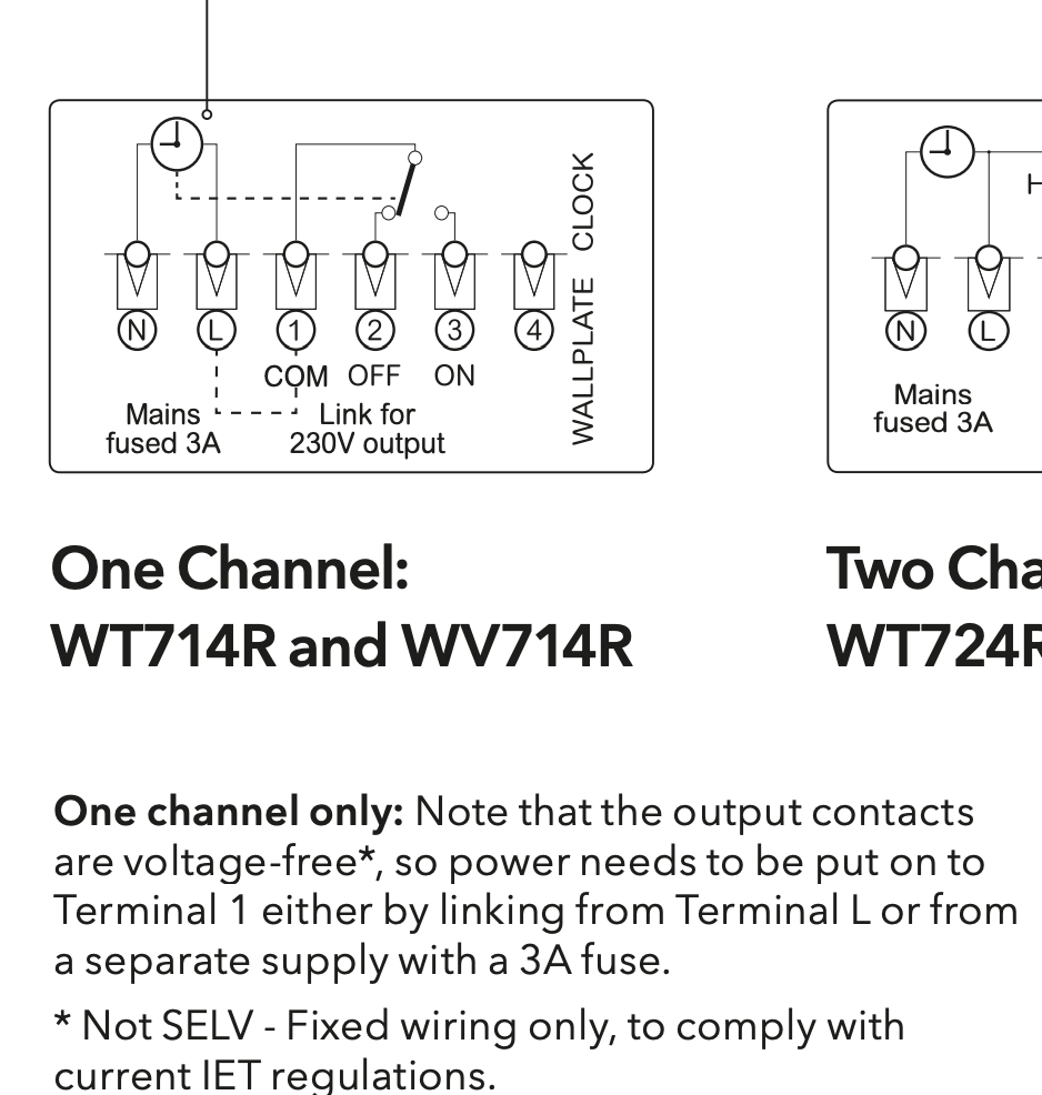

From my research am I right in thinking I can just connect the wireless receiver from L/N/3/4 on the boiler to L/N/1 (common)/3(Heating on) on the receiver using a new heat resistant 4 core?
Can I leave the thermostat connection in place to use as an override and double up the wires connected to 3 & 4 on the boiler? (1 wire from stat and 1 from receiver on each). My concern here is that the two existing cables are using up the only two cable slots inside the power case, so I'm not sure where I would run a third cable while preserving the integrity of the case.
If I wanted to remove the manual thermostat what would be the process for making it safe, as the wiring runs through the house so no chance of pulling the cable out.
Thanks in advance!

It depends on what you want to do? I think there are conversion modules to link the Wiser OpenTherm to Valiant system. But one could also use on/off control.
The single channel Wiser hub is volt free, so it can be powered from another source, personally I would not want to do that, as my boiler is battery backed, so want the thermostat either battery or UPS supplied, and would advise you consider the future and keep all parts of central heating off the same supply.

If the wires change colour, I would guess there is a motorised valve. The old idea was the thermostat controls the valve, and then the valve controls the boiler, with a combi boiler not required, but may be a junction box where the valve once was.

Vaillant doesn't support open therm so no point taking that on board. My guess for the colour change is that the existing thermostat wiring goes to the FCU and is picked up using harmonised colouring now. You could disconnect 3&4 at the boiler and FCU accordingly and change the cable for 5 core heat resistant flex and piggyback LNE and then just the switching wires of live out and live return, not L and N as you previously called them. Yes the boiler forms part of the combustion circuit, however after reading a recent paragraph again in the gas regs, advise may have been given incorrectly previously.
