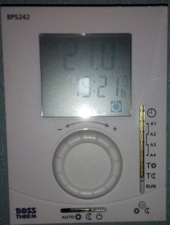

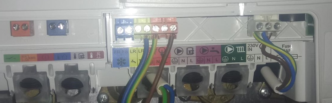

Hi,
I am trying to connect a single channel hive to my boiler. Its replacing a BOSS Therm BPS242 none wireless which only has two connections. Boiler power provided by fused spur . See pics
Please advise connections required from Hive to Boiler.
Thanks in advance
The two existing wires are 1 & 3 in the Hive, additionally the Hive requires a power supply L,N,E also taken from the boiler.
Usually done by a 5 core flex from the boiler to the Hive receiver, which will replace the existing cable.
Hi Flameport,
Does the blue wire on the boiler picture go to the 1 common in the Hive and brown to 3 heating on.
