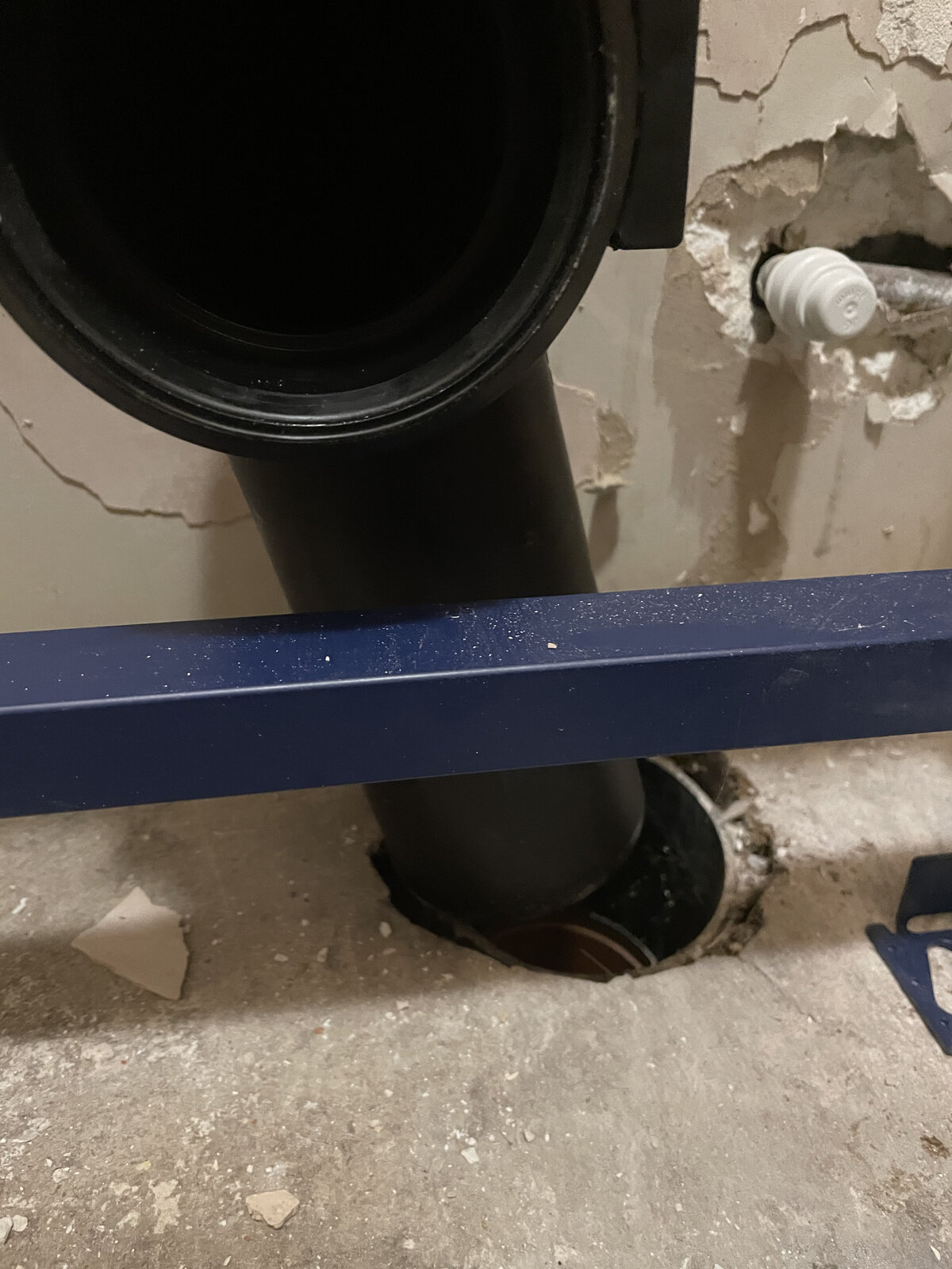

I’m still not convinced tho. I’m very tight for space.
just looked again and the pipe that comes out the floor is just a piece of Badly cut 110mm and I’m guessing the orange bit that it goes into is a socket and is just pushed in? Haven’t tried to pull
It out but it moves with a bit of force so i suppose if this comes out I’ll have a bit more to play with
I’ve just enlarged the photo myself, and what may be possible is: a drain connector and 2 45 degree elbows and your 90 degree elbow with a piece of pipe in between.

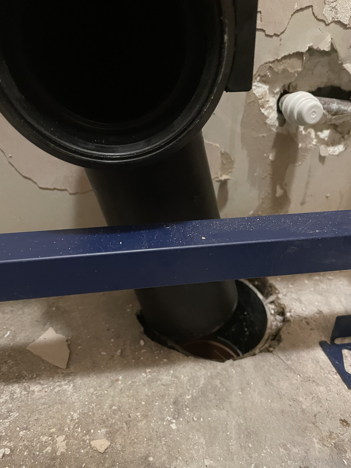

Well the frame is in, would have preferred less joints in the pipe. But it is what it is I think. It’s all very tight and can’t really go anywhere. No iffy smells and seals all seem really tight.
I know the angle that it comes out of the floor looks wrong like there is strain on the pipe but it isn’t! That’s the angle the pipe comes out of the floor......
