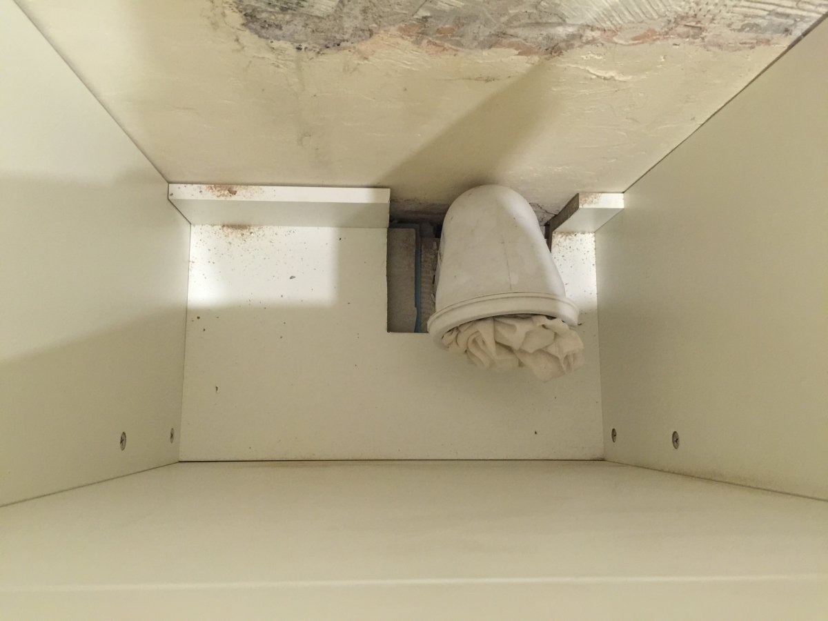

Can anyone suggest the best way to connect my toilet pan to the soil pipe when the two do not align correctly.
Toilet pan and soil pipe centres misaligned by 10cm approx
Cabinet depth is 30cm
Gap between front of cabinet and soil pipe 15cm approx
Would one of these offset connectors work ?
https://www.mrcentralheating.co.uk/...gclid=CLTcnavzyMwCFcO4Gwodq5IEfg#.Vy5dOVUrK00
Or could I cut the bell off the top of the soil pipe and use a flexible connector
http://www.victorianplumbing.co.uk/...n=googlebase&gclid=CN2_tYz0yMwCFfAy0wodCFQKcQ
Any advice greatly appreciated

I did think the pipe sticking up out of the floor was possibly a connector but as disappears under a tiled floor I didn't want to risk yanking it to see, for fear of breaking something.
Assuming then it is a pipe connector do I just pull it out and connect the flexi pipe directly into the pipe which will allow me the angle difference ?
thanks
if you can't extend the 4" up out of that hole and along to meet the spigot and you have a back to the wall/cabinet pan and you are stuck with what you have, then my choice would be to use a fixed flexi pan connector as Nige mentions. Means you can jubilee it on to the spigot and push back without risk of it disconnecting. The current connector should just pull out of the 4" pipe below.

If it's a wood floor Mac I'd cut around the vertical soil pipe & fit a standard 110mm collar. If it's concrete fit one of these into the vertical pipe at floor level;
http://www.plastics-express.co.uk/u...JigU8l_sBLDYYQx063rUaCeNozXr4-w74IaAkRI8P8HAQ
A cutting of 110mm pipe, 2 bends(90s or a 90 + 45) & a standard WC connector.
