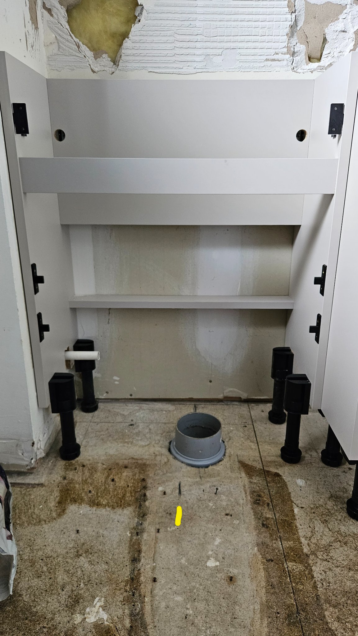

Hello all,
Fitting up for my new toilet and pan connectors are a new one for me.
The Vanity unit for the concealed cistern with the toilet central has the soil pipe 50mm out of centre.
I can see you get offset Pan connectors but it looks like I need a vertical to horizontal (90 degree) pan connector.
Can this be modified with some pipework or am I looking at needing a flexible pan connector?
Iv included an image as this will probably explain the problem better than I have above haha
There will be enough leeway in a normal long tailed bent pan connector, the top will move over enough to accommodate that.

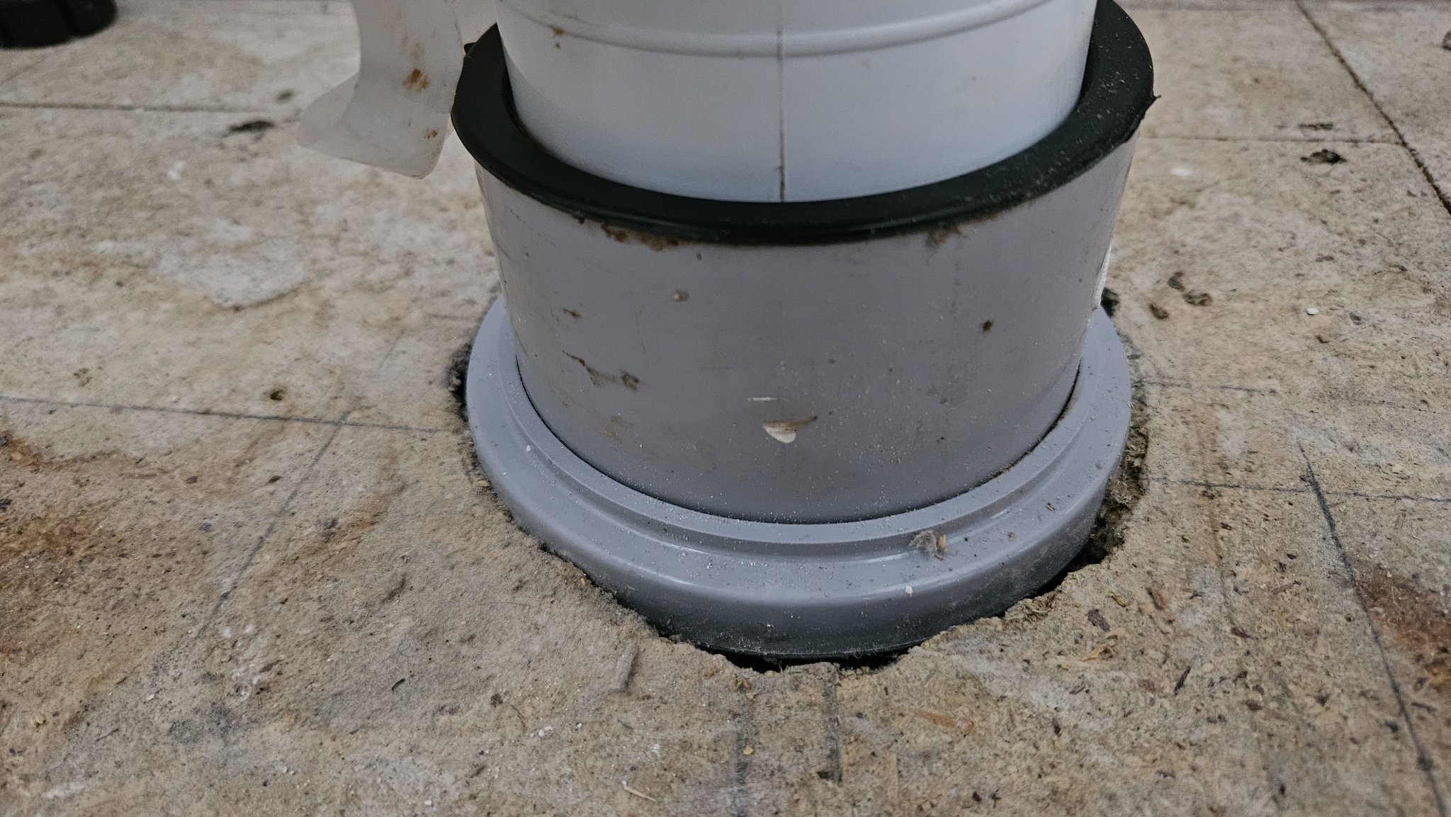

Also, is there any reason his soil pipe would be so tight to the t+g floor? I'm sure I get creaking from this when got water is flowing through.
I can cut some material away and silicone to stope any stress?
If you want to go whole hog... Uplift the boards and extend the soil pipe to where it needs to be.

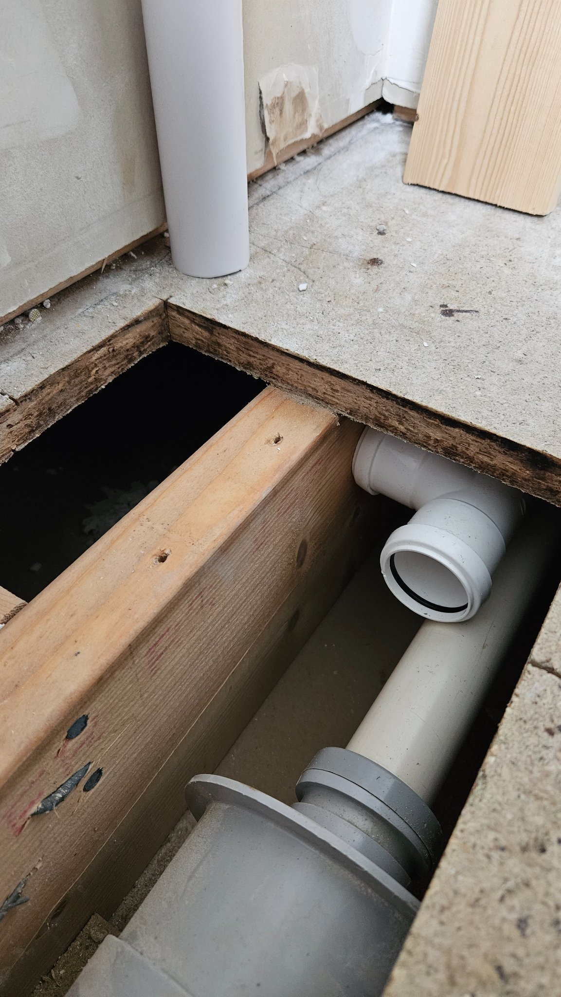

The other end is just the shower waste running in to it, so if I get lucky and it's all push fit, I should be able to just disconnect, cut 50mm off the toilet soil pipe end and then extend the shower waste to reach.

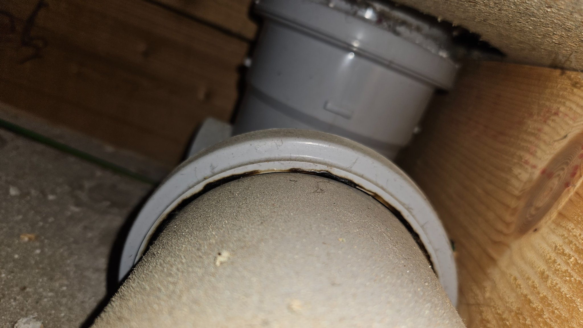

So it is push fit which is good. Is this just old grease/fairy or whatever they used when they originally put the soil stack together? (Image 1)

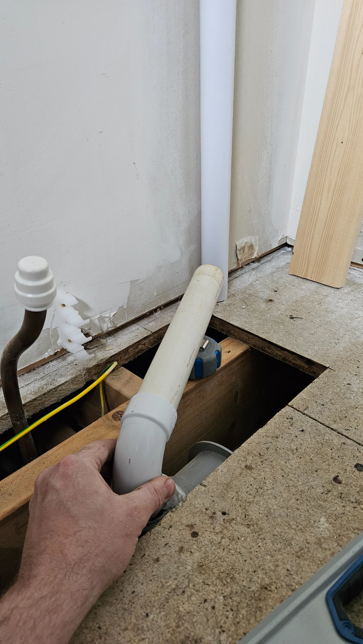

Am I better to route this above the floor boards/under the cabinets (Image 2) or should I cut into the 1.5" just before it goes into the 4" and then up through the floor boards where it needs to be? (Image 3)
It's quite tight with the joists there but probably manageable.

Image 2, below the cabinets. You don't want to be cutting too much out of the joists.
Could me marmite for all I know ;)
Taste it maybe :)
Twist and pull and maybe some washing up liquid to help push n pull.
Taste it maybe :)
Most things I probably would, as the first joint out of a poop pipe, maybe pass
It looks sludgy but there's no evidence of water or leaking so unlikely oozing poo. Basicly what I was seeing if I got answered back
Please please please don't use pushfit waste pipe fittings. They can be a problem just waiting to happen. If you are going to that trouble doing the work then always best to use solvent weld under floors.
If it's 32mm waste then usually no issue to core a hole, with the depth of those joists. You are allowed a hole up to a 1/4 of the depth of the joist, in mm (e.g - 50mm in a 200mm deep joist)
