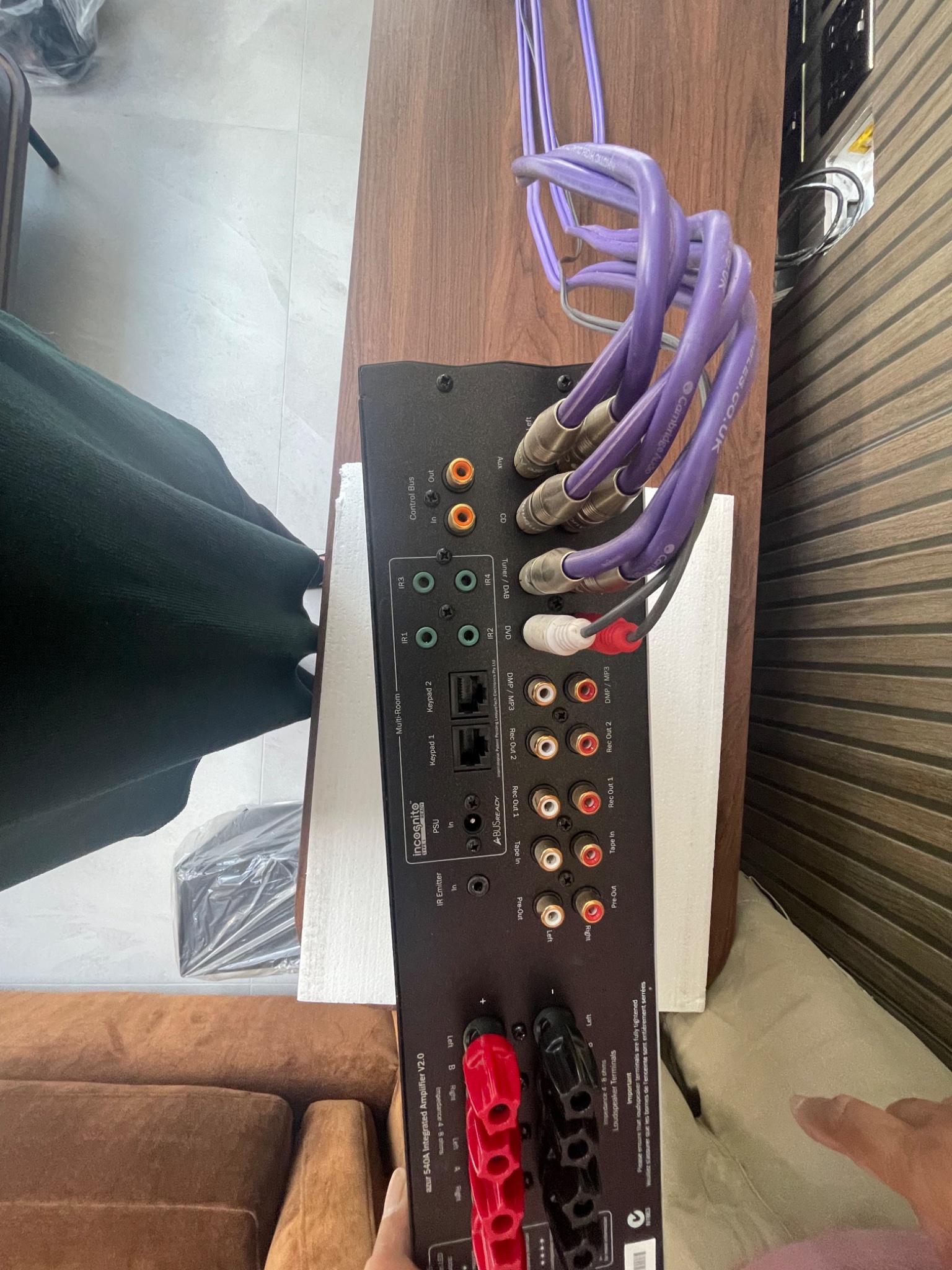

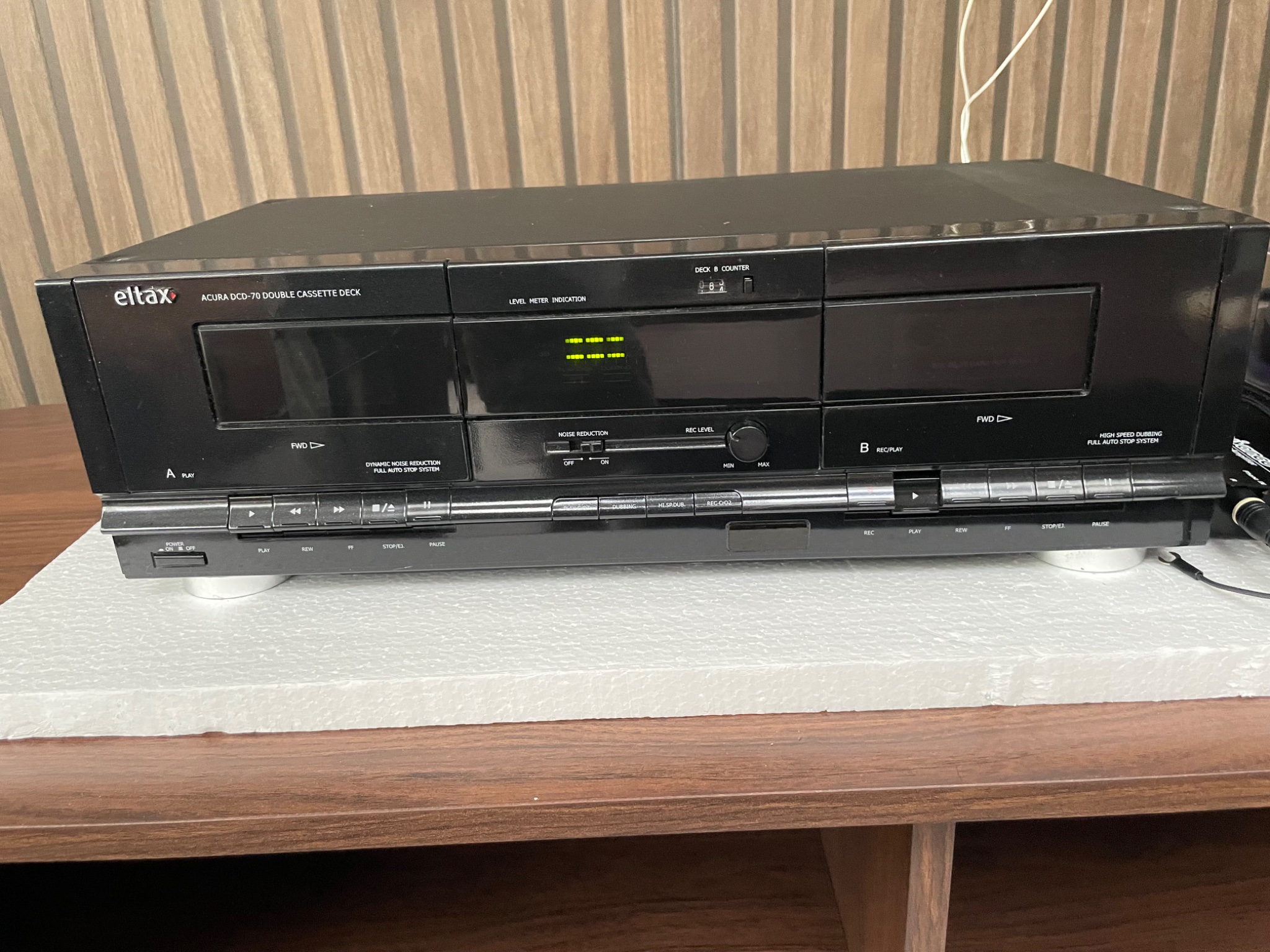

Hi All
How do i connect my Eltax tape deck to an Cambridge Audio Amp?
Pics as attached.
Thank you

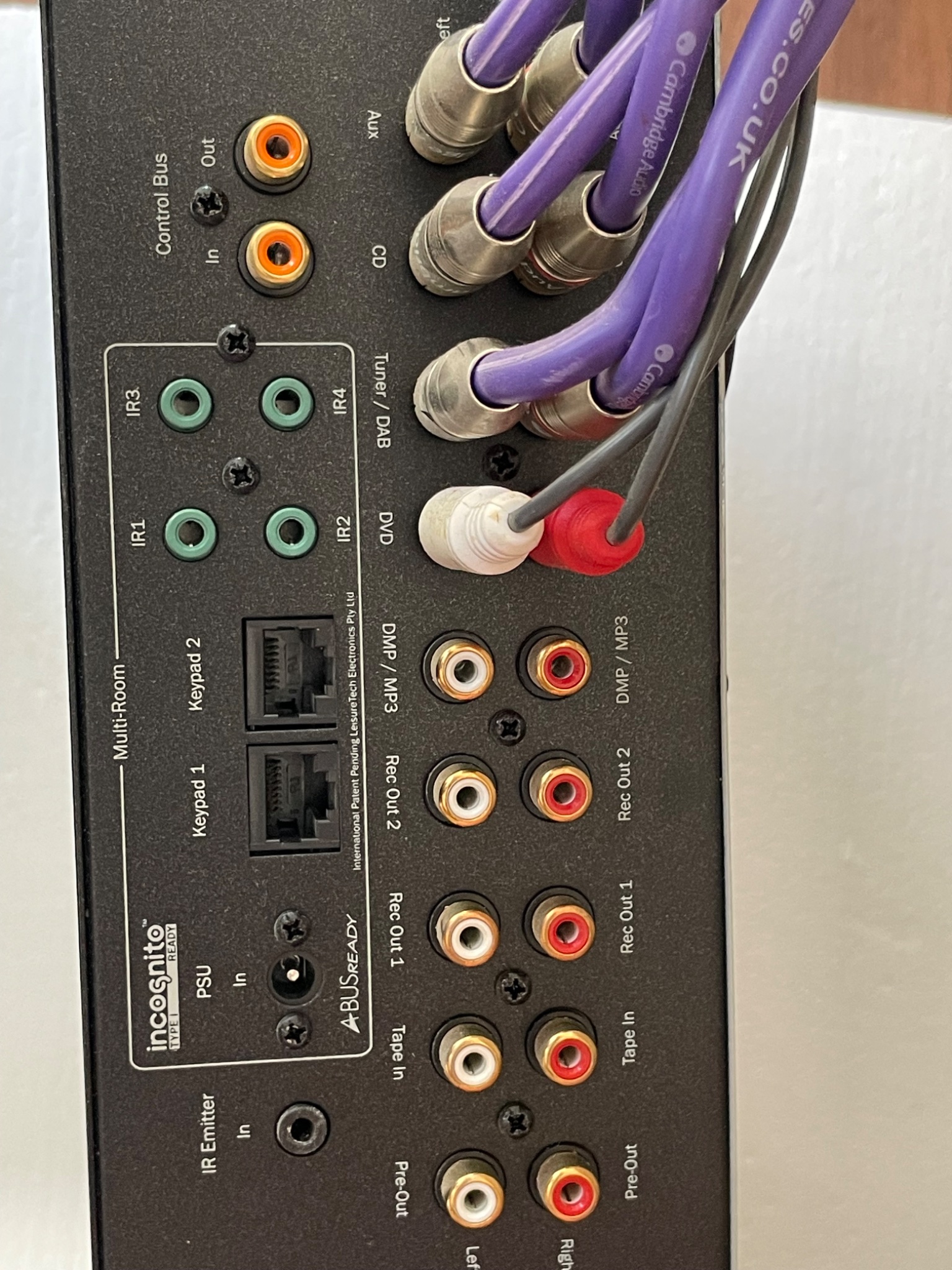

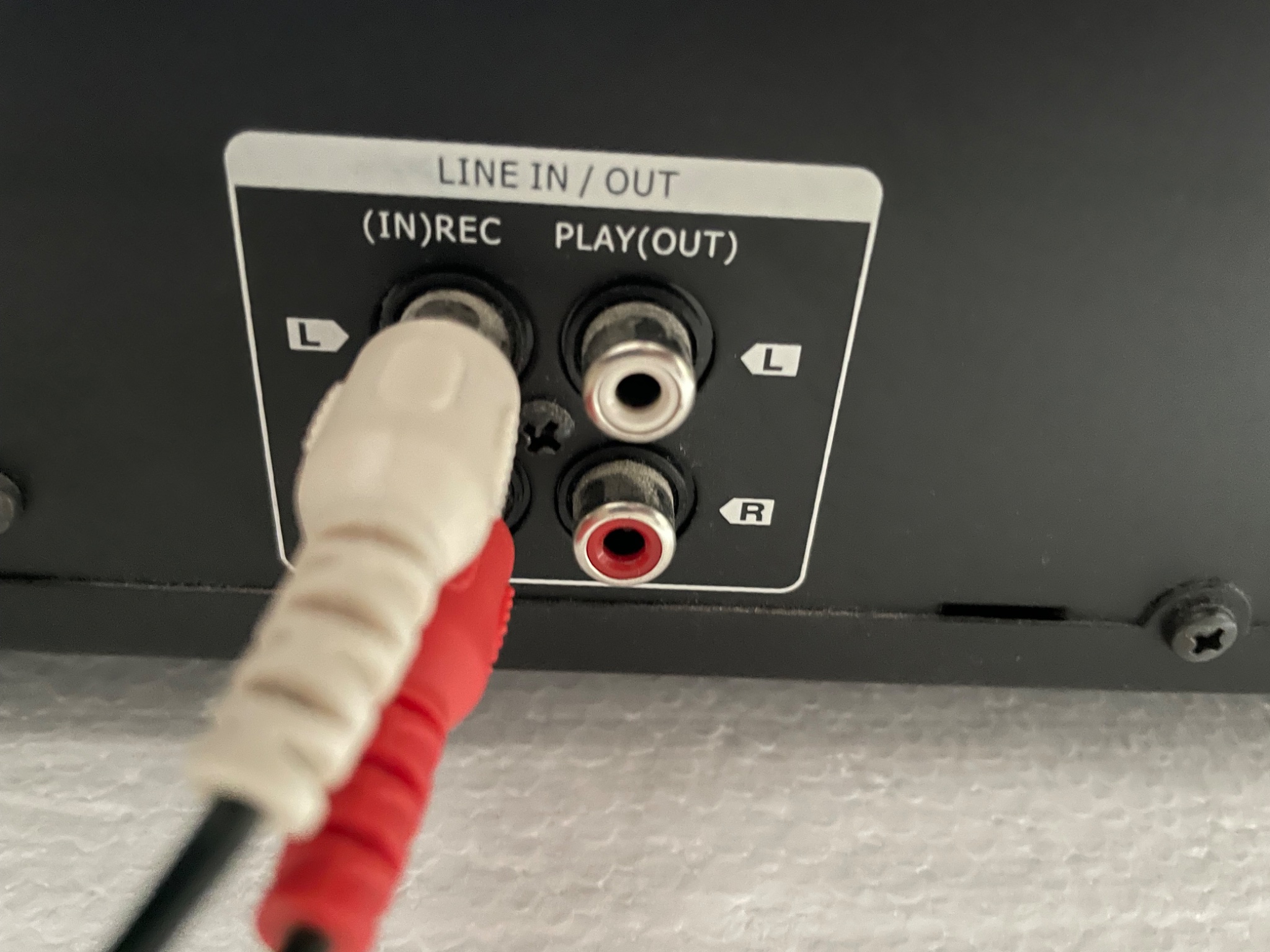

First connect the "PLAY(OUT)" sockets on the tape deck (in your first photo) to the "Tape In" sockets on the Amp.
Check that you can play a tape.
If that works, connect the "(IN)REC" sockets on the tape deck to .... probably "Rec Out 1" ??? on the Amp, and see if you can record anything.
Connect play out on tape Dec.
Amp is marked for tape in.
Then on amp you switch to tape so any feed in on the tape channel gets put through to speakers

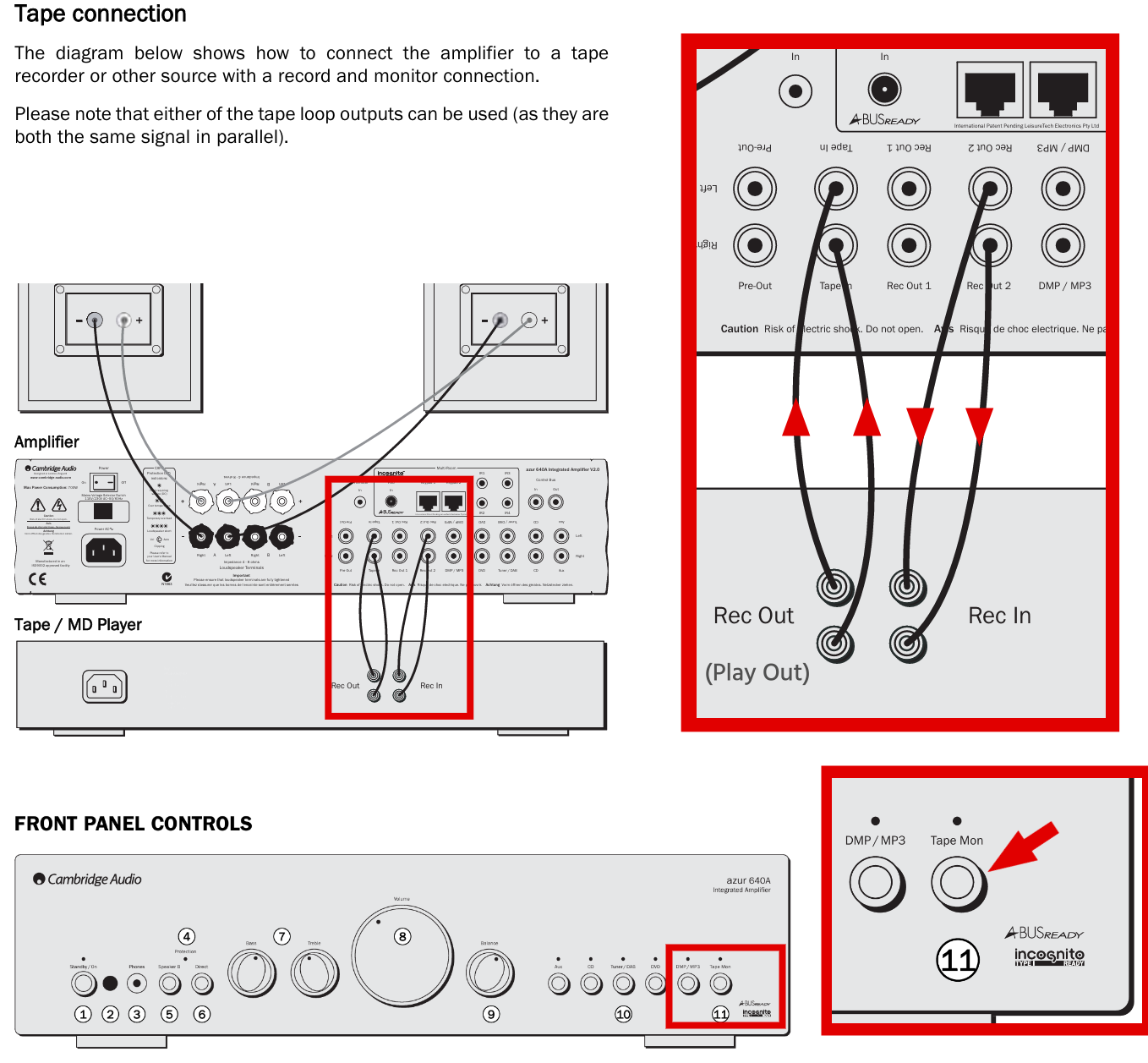

This is also covered in the user manual. https://www.cambridgeaudio.com/sites/default/files/compliance/doc/Azur 540A-640A User Manual - English.pdf
As others said, start with the Tape Deck PLAY OUT connected to the Azur's TAPE IN connection. To hear what's playing from the cassette deck, go to the Azure front panel and press the TAPE MONITOR button.
The recording connection for when/if you make new recordings to cassette can be either REC OUT 1 or REC OUT 2. They both give the same signal.
Whichever source button you select (AUX, CD, Tuner, DAB etc) sends that signal to both REC OUT sockets. That's how a signal gets to your cassette deck for recording.
Here's the same info in pictures from the manual. I have highlighted the main bits.
