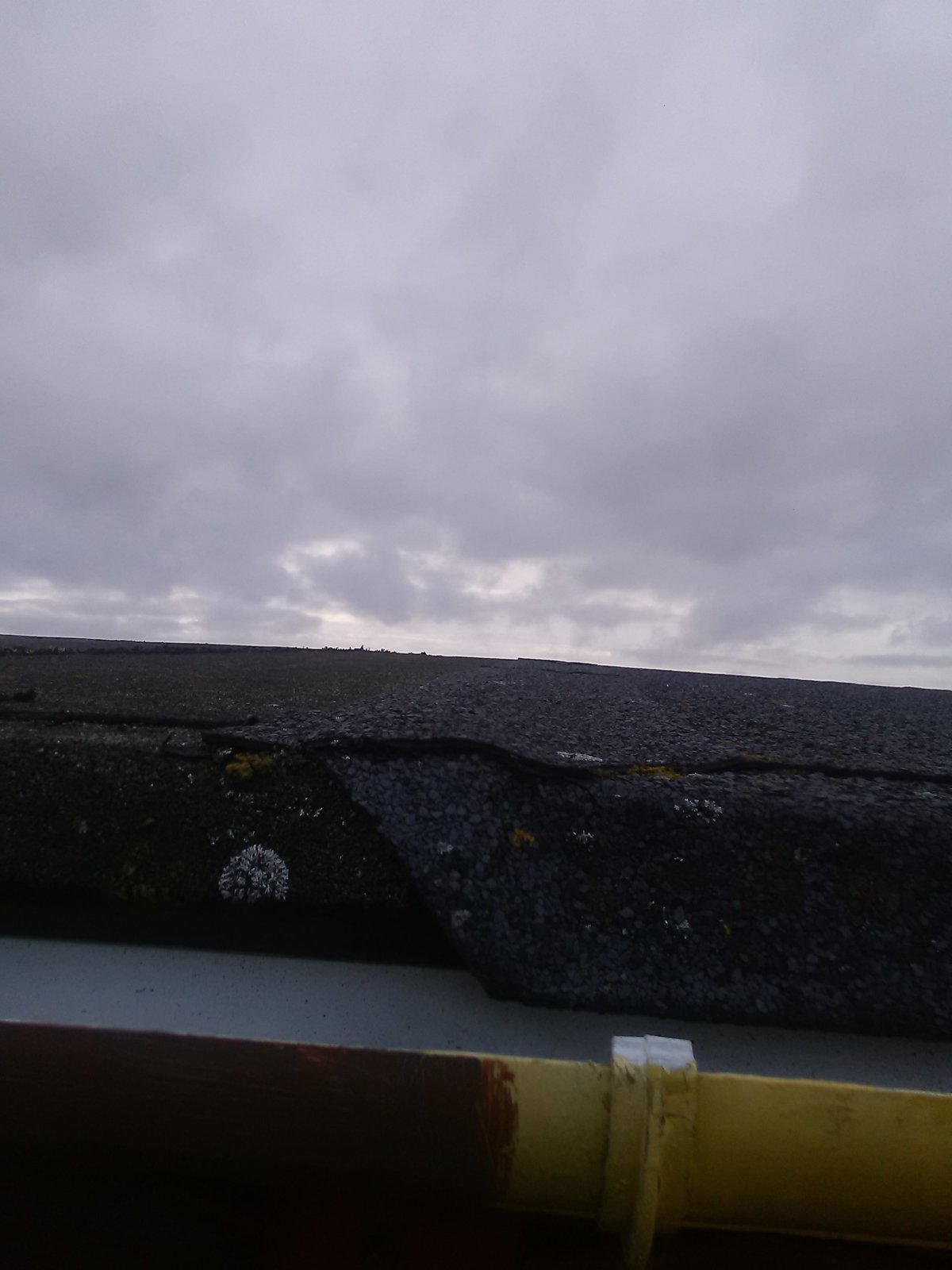

Hi all,
I intend to connect to an adjacent flat roof using EPDM, using all recommended materials IE. Termination bars ect. Where exactly is best to cut back to?
The roof felt to be taken off is on the left hand side in the pictures.
Thanks, Richard
Best place is to cut off now while you are still pondering it.. get a good felter in. It is likely to bite you
Prise up the new felt using a heat gun and a large paint stripper to expose the old felt.
