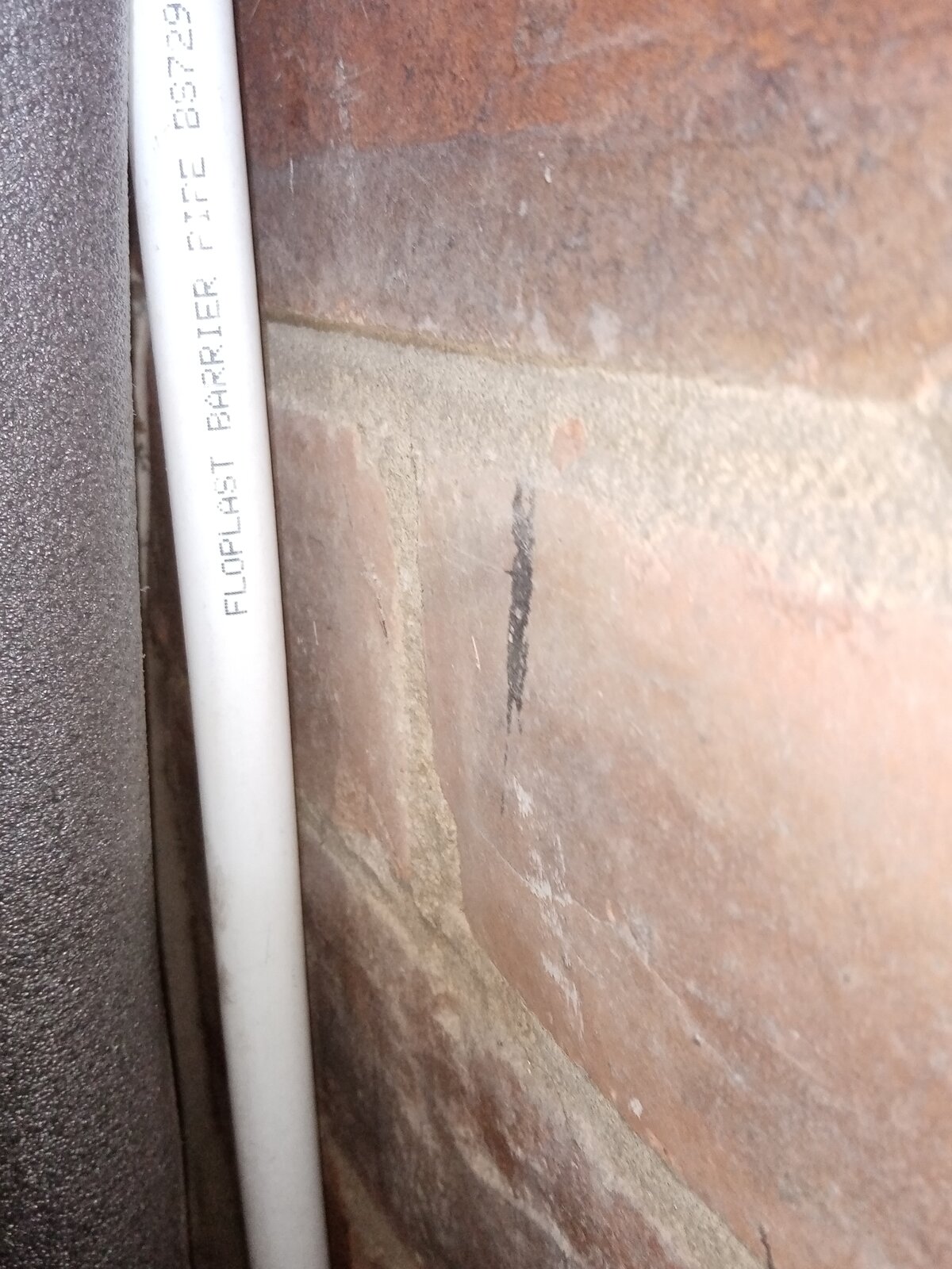

Can I use polyplumb fittings and liners to Connect to floplast pipe?
I prefer to use the same make for pipe and inserts, the fitting don't matter so much.
I could try to get two floplast liners for the 2 tee'd connections on to that. Then a poly liner and tee for the branch. May end up being speedfit pipe I use. So would floplast pipe exempt super seal liners?
I did hear a manager in the merchants say once there OK with using different fittings on there pipes. But try keep the liners the same as the pipe.
It appears that ALL the various makes are compatible with copper. When forced to change makes, you could start the new run with a very short copper infil. Or is that a bad idea?
