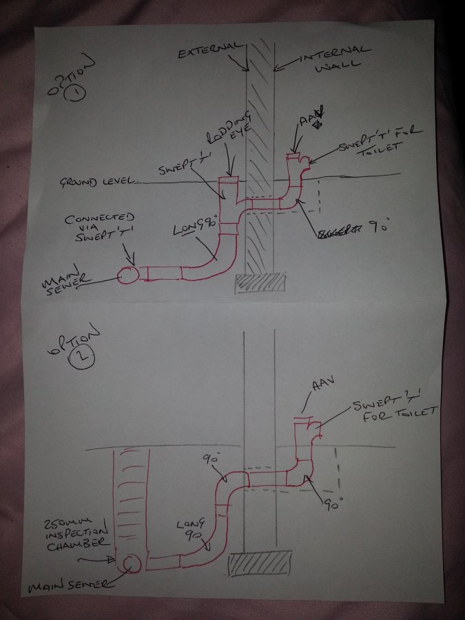

    I am in the process of finishing off my house
    Renovations.
    The last job is to connect the downstairs toilet up to the main sewer.
    The existing vent stack in to far away to connect upto and i dont really want to erect another
    so I think my best options are these

    My thoughts are that option 2 is better but what are the regs in your area? Might be better for you to speak to building control, they are usually helpful!

    How deep is the existing sewer? The smaller diameter chambers are only suitable for shallow access, up to 600mm deep. Anything deeper than that and you'll need a 450mm dia chamber.

    Thanks you Hugh. It's at least a meter deep if not more
    im restricted with space so won't be able to put a 450 in

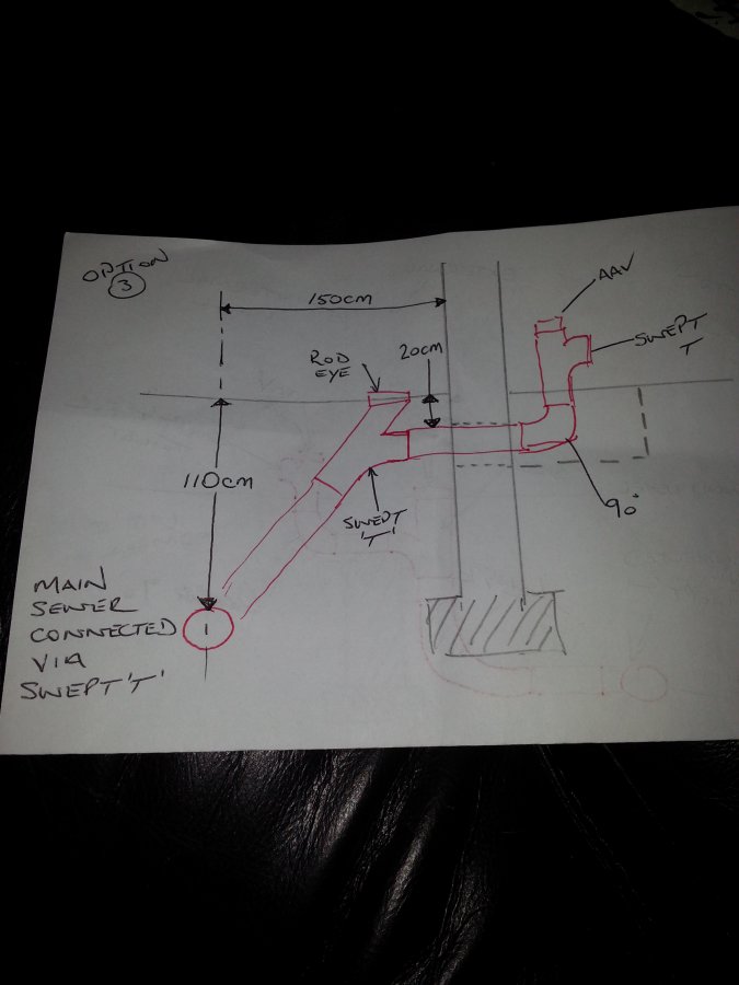

    1465900485097.jpg As people say there's allways more than one option
    here is another however I'm unsure of what fall angles id be allowed to get away with
    here are dims and pipe work arrangements

    I will echo others views, you need to involve Building Control before proceeding. With the depth you have mentioned, regs will not permit anything smaller than a 450mm chamber, for the simple reason, you will not be able to work from a smaller diameter chamber at that depth, to clean the pipework!
    Your solution to drop onto the top of the pipe with a saddle or junction may be ok, but it will depend on the views of the BCO looking at the job. Alternatively, use of a shallow chamber at the appropriate level, then a bend on the outlet to take the pipe down to connect onto the existing sewer may also be an option. Lastly, the 'Marscar Bowl' gives another option, although possibly not suitable in this instance due to space constraints.

    As advised here ive had council out he was under standing of my restraints and was happy to go with option 1
    I've connected clay to plastic several times in past but only butting up to it not physically splicing into clay and fitting a 'T' or 'Y'.
    So my question is, same principle? Remove section, use pvc T with rubber adaptors with jubilee clips, job done?

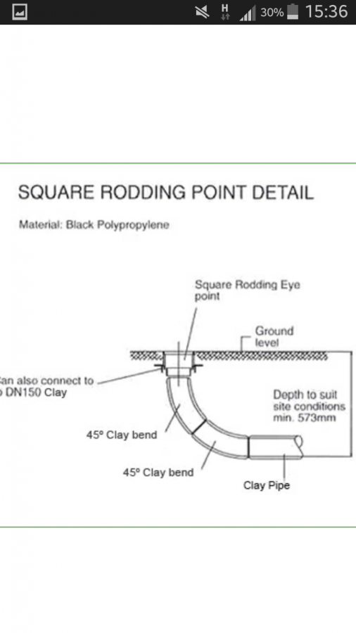

    im in need of a square rodding point like this (which goes straight down) however im having trouble sourcing one. All that I have found are angled which won't work with my layout.

    Osma do a straight rodding eye AFAIK. Alternatively, fit a standard square gulley hopper and swap the grid for a screw down, sealed cover.
