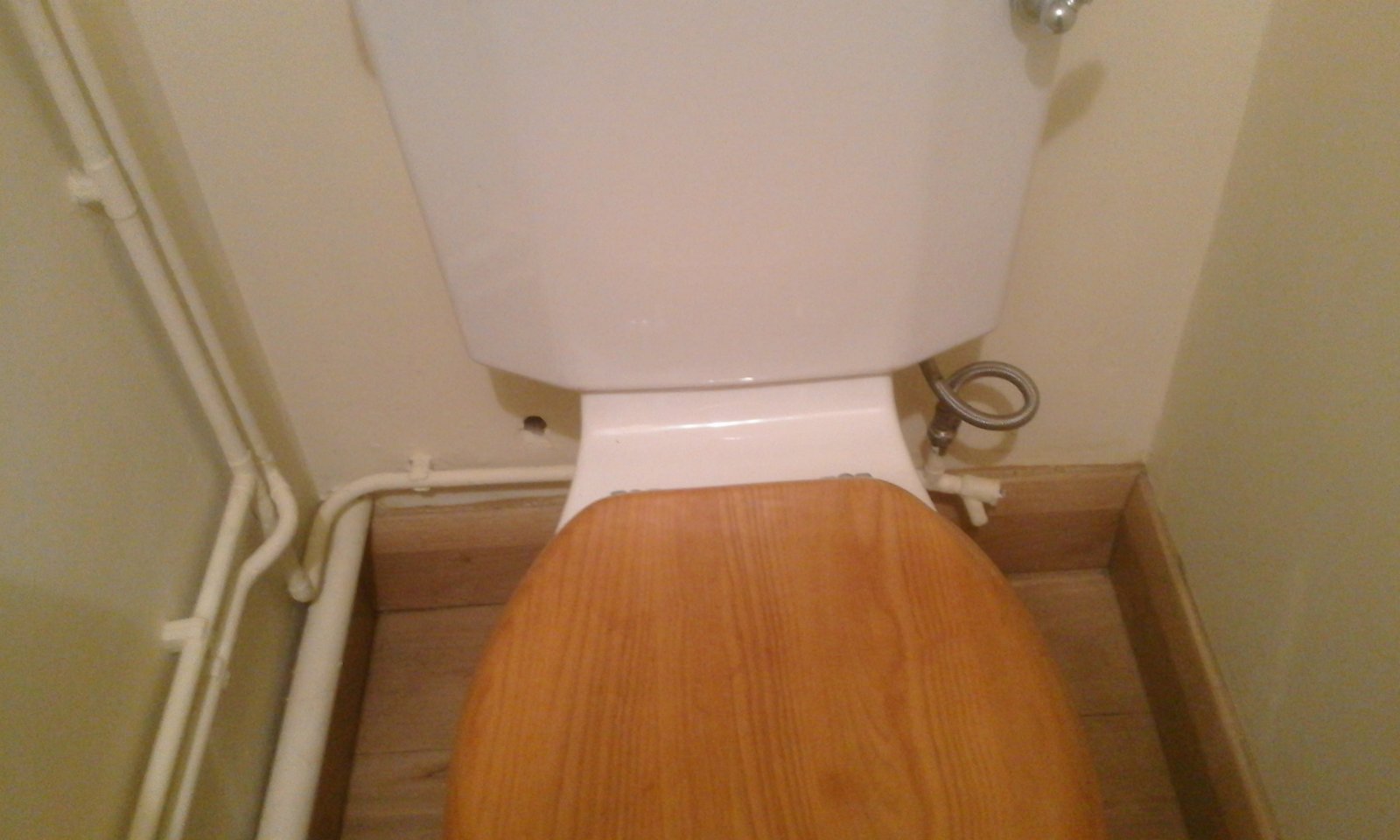

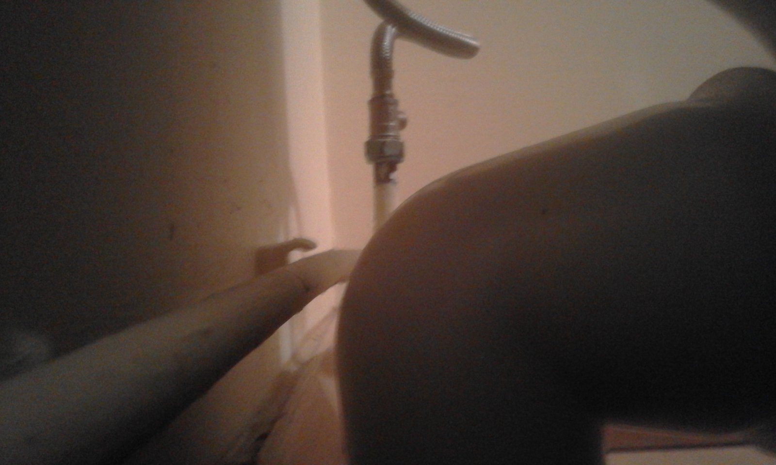

Before you get too excited though, can you put a pic up of the existing setup behind the pan? There may be an alternative method we can advise on.
OK, here's a couple of pics. The first of the whole of the end of the room; the pipe from the washing m/c would come in from the right-hand wall:
The second is taken from the left side looking towards the pan connector and right-hand wall:
Do these show what you need to see?
Not a lot of room there, to use the connector with the 40mm boss, may put you too high to use a 90 on top to connect the pan. Why they dont make them all with a 40mm as standard I dont know, can easily reduce to 32mm if needed. Think the only option may be to use the 32mm and reduce at last moment from 40-32mm.
You're right, the space between the top of the pan connector and the underside of the cistern is quite limited. I think the W8CONV would just about give room for the 90° connection, and I may have to reroute the supply connection to the cistern. Otherwise, I might try connecting to the waste pipe from the handbasin (above the skirting board, on the left of the first photo), perhaps after changing it from 32mm to 40mm. I'm going to have to plan it carefully.
