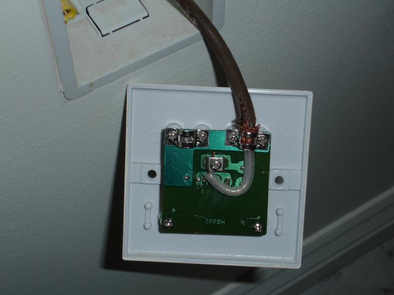

I've had a look at the back of one of the co-ax points in the room, and it looks fine...in fact looks quite a nice job to me...copper central wire is still fully insulated, and outer thread is completely separate...

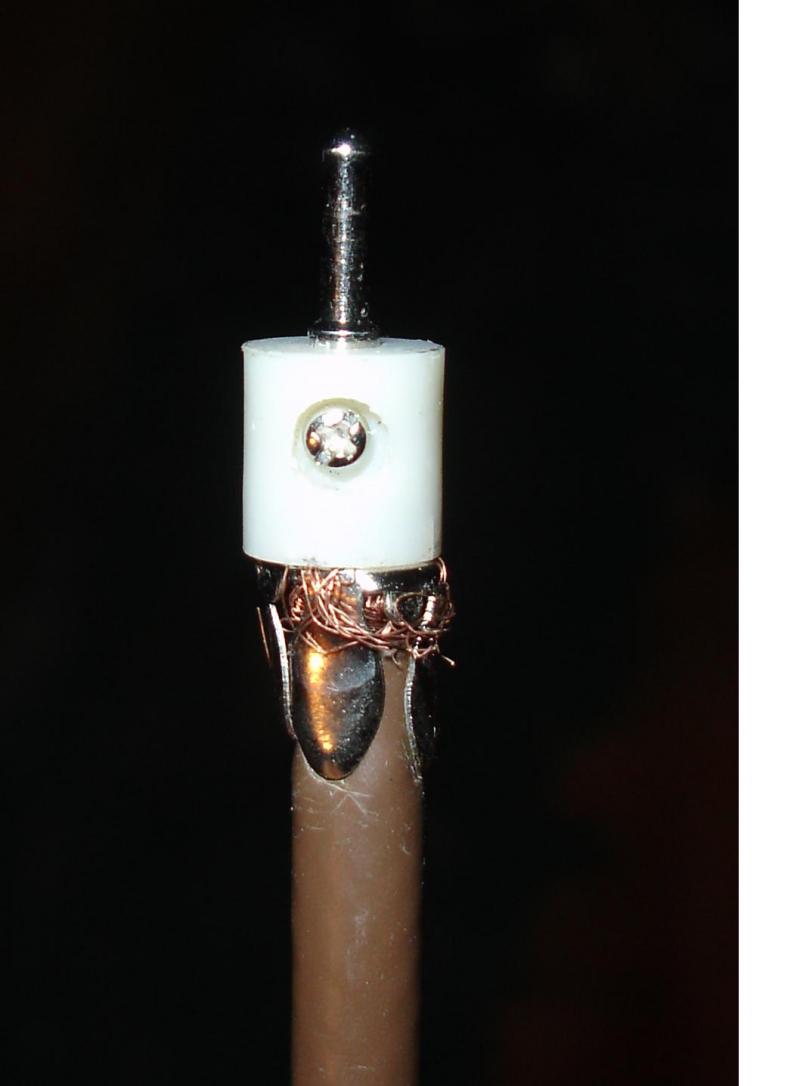

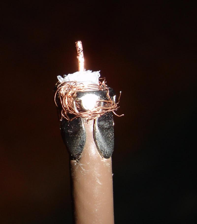

So I had a look at the loft connection:
Should I strip this down a bit, and try and re-attach the connector or a new one? Or am I barking up the wrong tree (again)?
From the pics, all seems ok, nothing obvious. I was hoping that you'd take the front plates off and find the coax not even connected or something, then it would have been case solved.
So, am I right in thinking that you are able to connect from aerial/loft to those sockets in rooms below with just one connection? If so, it might be worth disconnecting from the socket in the room, and removing the plug/connector in the loft, and simply holding, or 'balancing' the inner copper wire of the coax in place both at the loft end and the room below, straight into your test TV. See what that picture is like. It would rule out any problems with any connectors/sockets as there won't be any in use. Make sure the outer copper of the coax is nowhere near the inner wire, as if that happens you'll get loads of snow, they can't come into contact. Just an experiment to try and rule out as much as possible. I've been in this situation a number of times, and it's usually the coax plugs or the sockets. Holding the inner wire of the coax into the TV giving a perfect picture, putting the coax plug back on giving a crap picture. They can be finnicky to get right. If it's impossible to get a reasonable picture with no plugs/connectors/sockets involved then it can't be anything but the cable, although I still find it hard to believe that all three could be faulty or suffering from the same interference.
Having re-looked at the pics, the inner copper wire does look a little short, that should reach to the end of the coax plug.

- I'm connecting the wallplates wrongly (although I'm not sure how else to do it - see picture above). The core connects (I know as the digital reception is fine)
