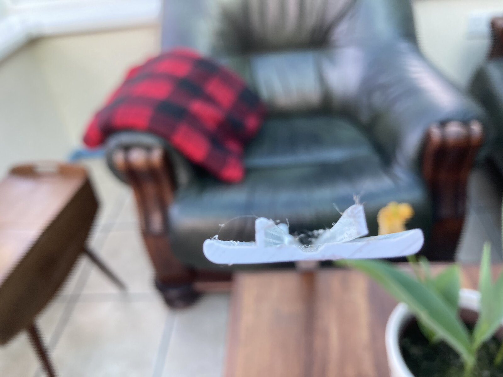

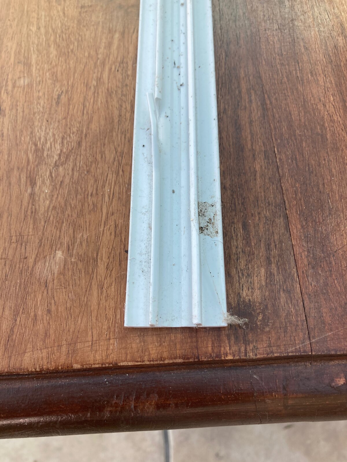

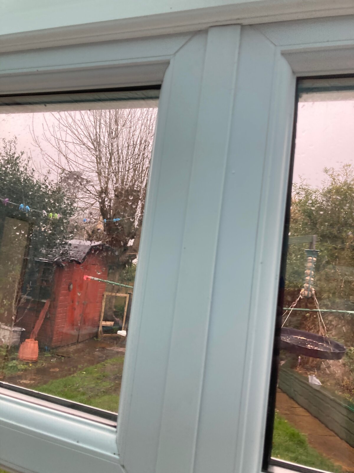

I have searched high & Low for these, evan been back to where I bought the Conservatory, but they were no help. Can any one suggest where I can get them please.

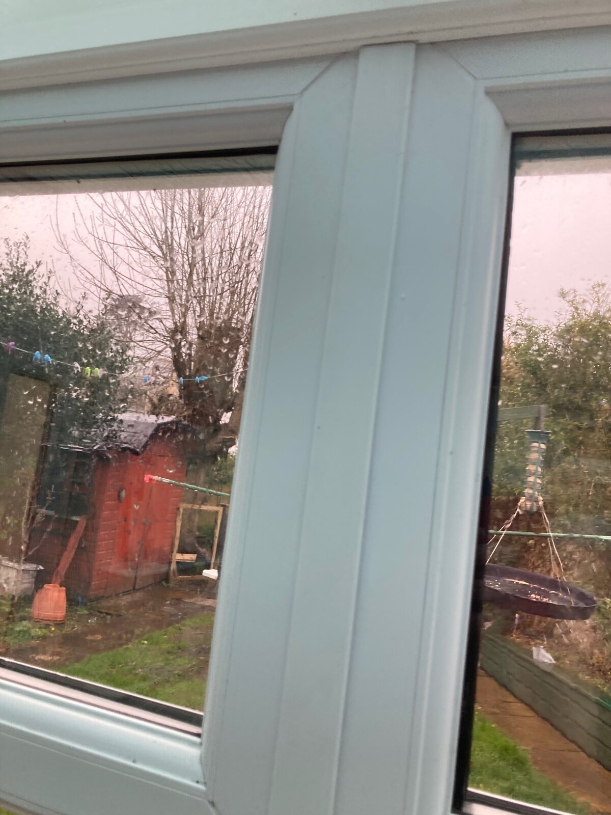

Really need to know what profile system it is, beads look like WHS Halo rustique but could be wrong

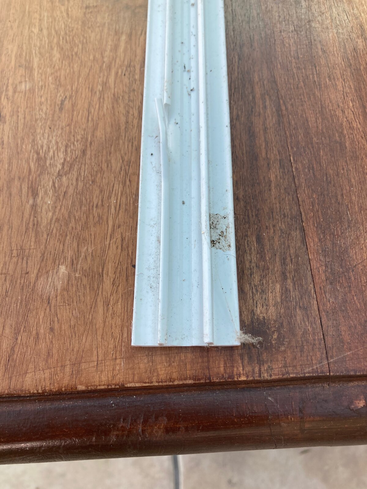

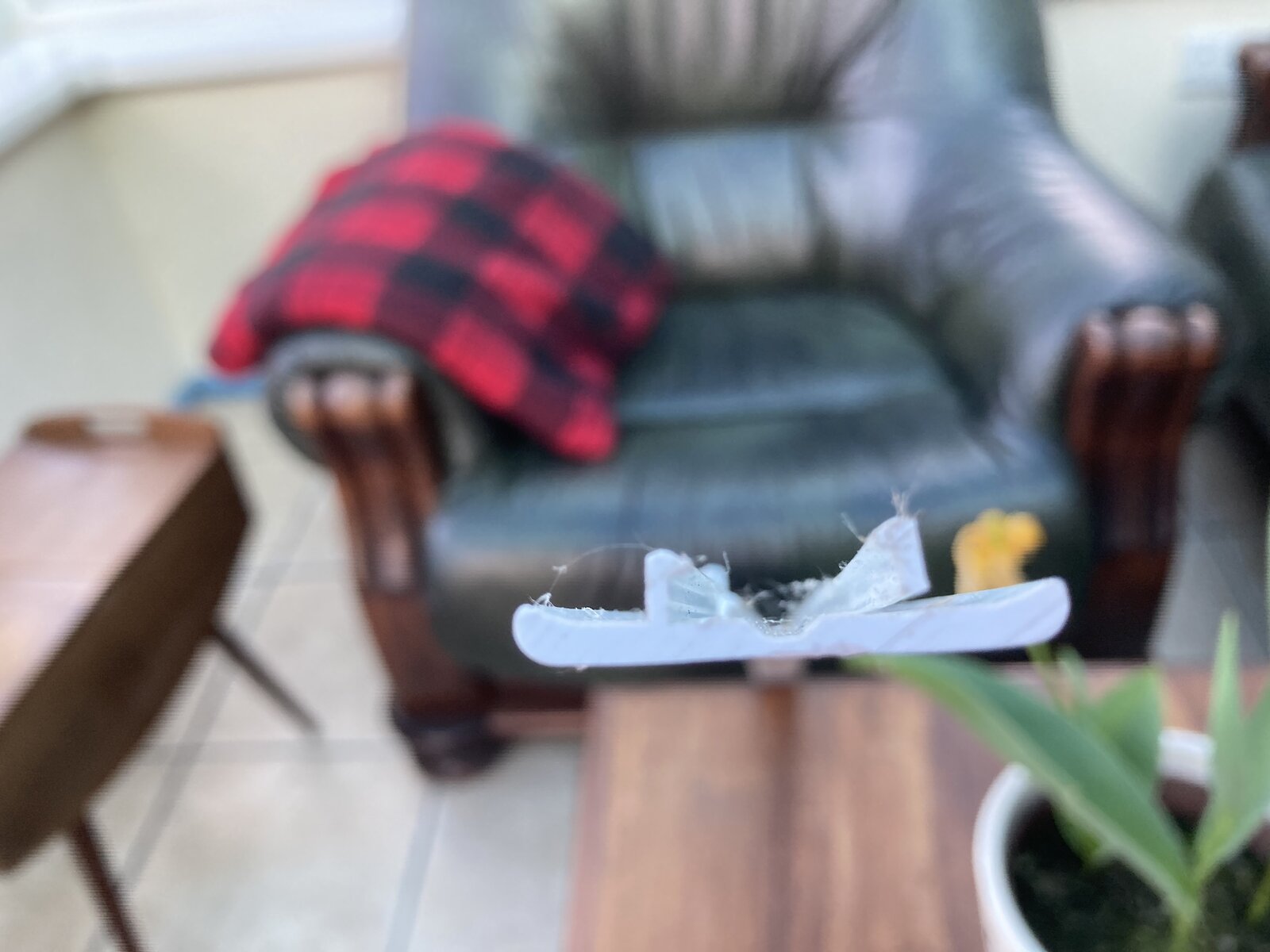

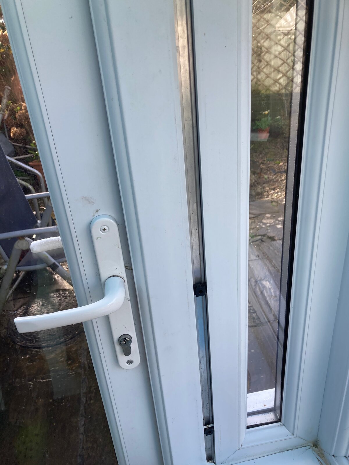

They are very difficult to remove, they come apart at the back

What are you actually trying to achieve as a matter of interest? If its just to replace the covers then maybe ' trim ' would work, or if joining another frame, may be a different joiner but again use a 20/25/28 mm trim to cover the new joiner and the old ones so they all look the same

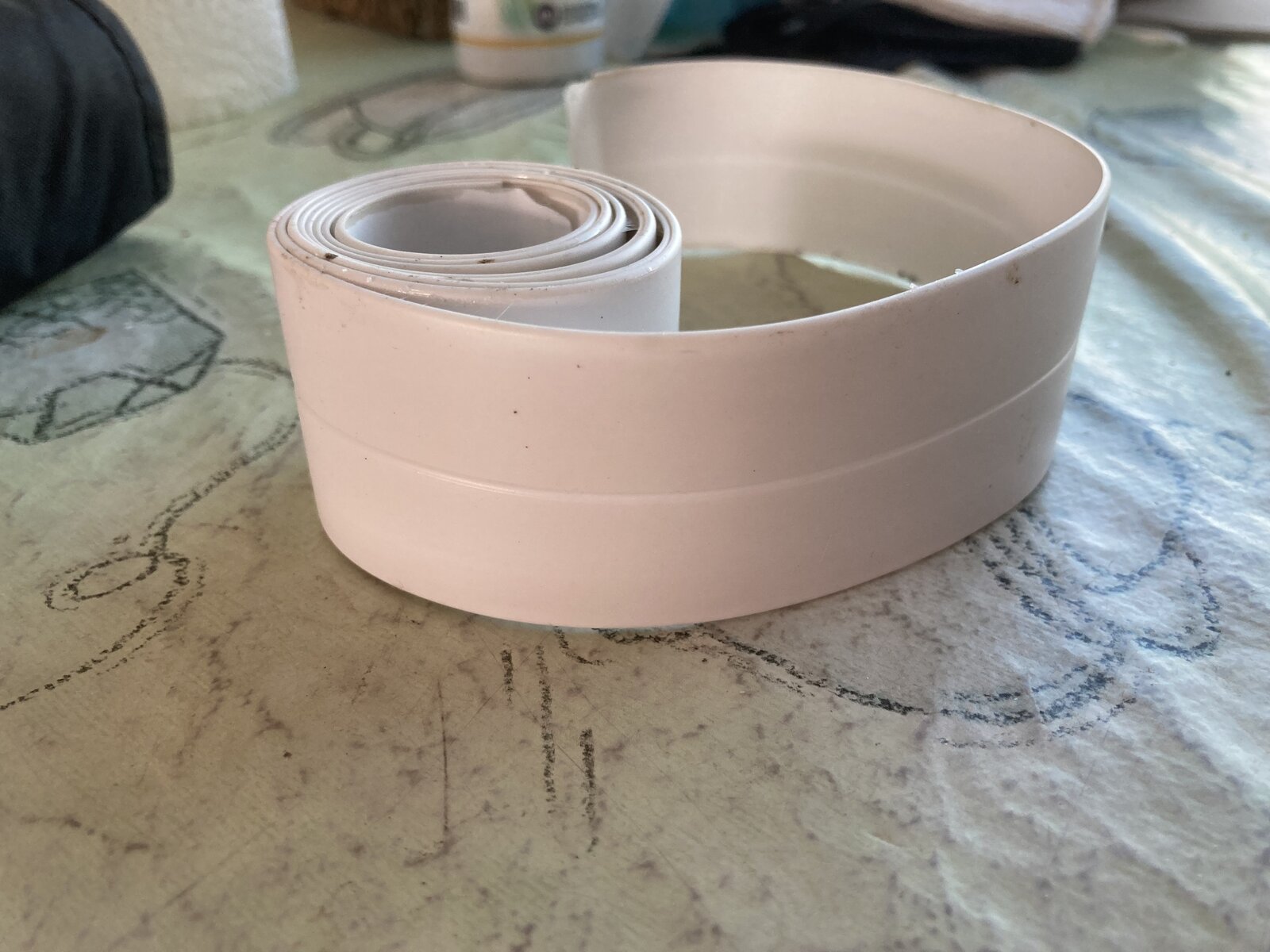

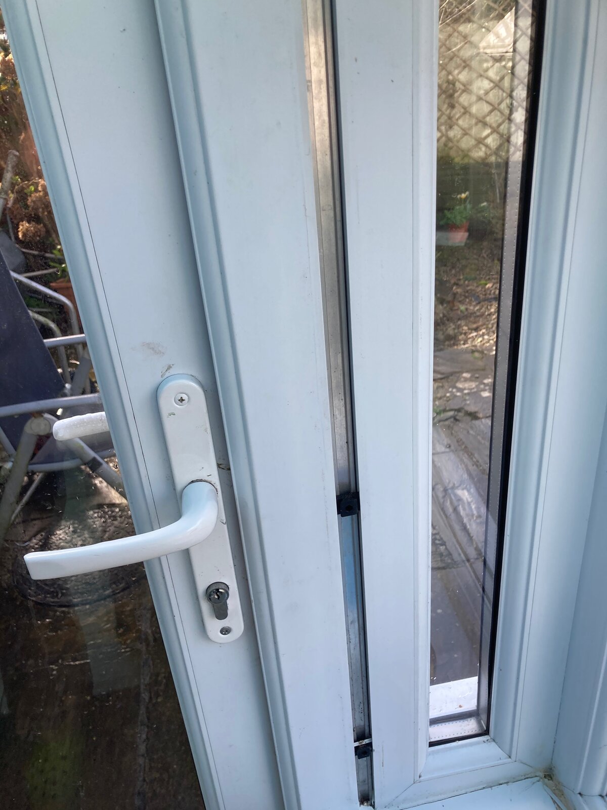

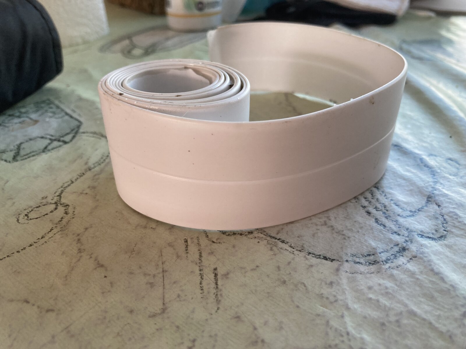

We have had no luck with our choice of Builder. He built a Bathroom extension whig was 8 cm out when he demolished inner wall. He also built the Dwarf walls for the Conservatory, and managed to break a sewer pipe. We found out too late, he'd gone Bankrupt. We had to demolish the wall to Install new Sewer & got a Blocklayer to rebuild the walls. I then built a DIY conservatory, put the inside Sill on and found a gap of 1 cm. at one end. The walls wern't square. Filled gap with Mastic but it looked terrible. Saw this Angle tape but it meant taking the Strips off. Nearly all damaged. Can possible glue them back on but would prefer new ones. Why are they so difficult to get?

Angle tape works ok, use white 1or 2mm double sided glazing/security tape, much more forgiving than super glue with activator

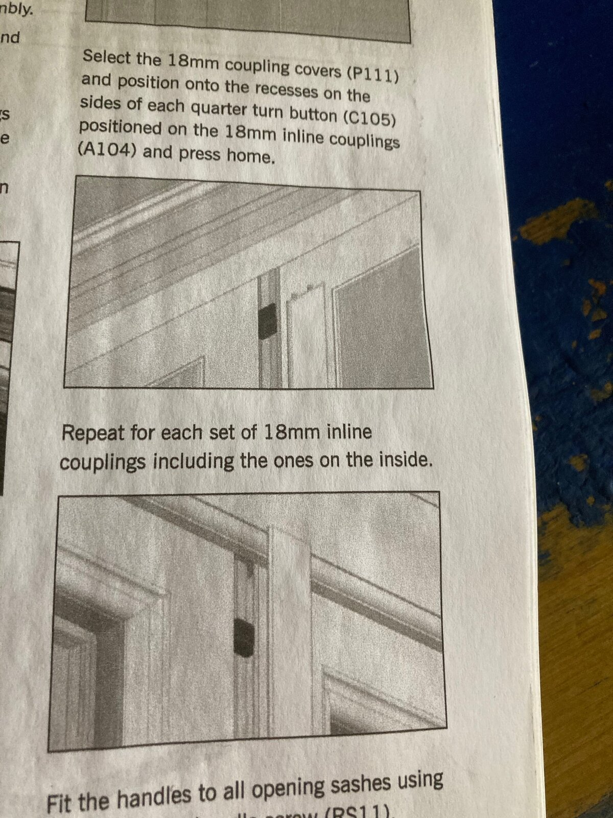

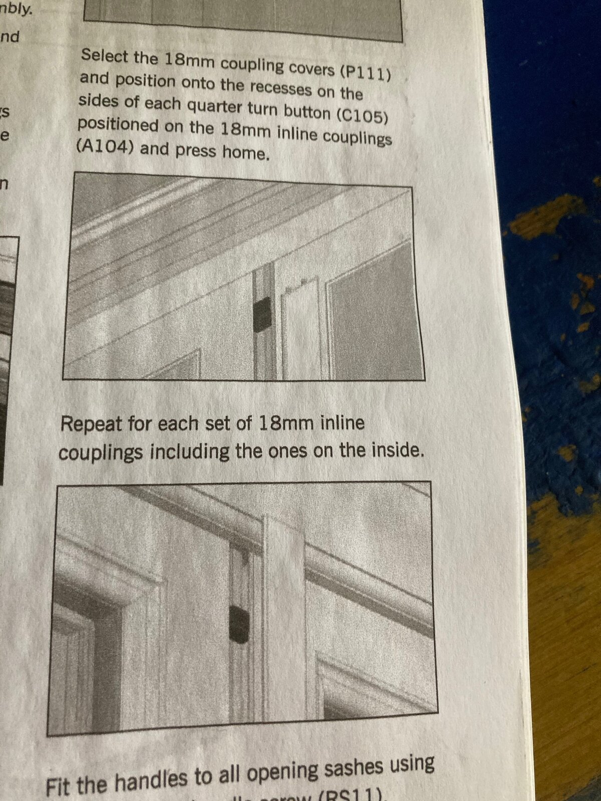

A firm called Conservatories for U, Penzance. Went to them ...no help at all. The only other thing I vcan see is K2 on the installation Booklet, no hint of who made it. It's good , well made, but you'd think it would be possible to get Spares.
K2 is the make of the conservatory roof, K2 also had their own pvc profile but I believe this is now discontinued
