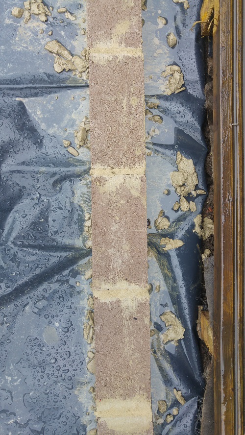

Hello all.
Builder finished laying my conservatory base.
He dug a big hole, put in the hardcore, put sand on, put the Visqeen in up and over the sides then concreted.
Later he pulled the Visqeen back over the concrete and laid the 2 rows of a single wall I wanted. The conservatory is full height glass.
He says to put the Visqeen up inside the bricks but only one brick height, before I put the Kingspan insulation down.
I asked if the Visqeen should be cut away on the outside of the wall.
He said not to, as it was to make the base completely waterproof.
The photo shows the inside on the left of the wall, and on the right is the outside with pools of water in the Visqeen after it rained.
My worry is the rain will soak through the bottom bricks and maybe cause condensation, or worse.
Anyone have any views about whether I'm paranoid once more, or should I cut/leave the Visqeen around the base on the outside.
Thanks.

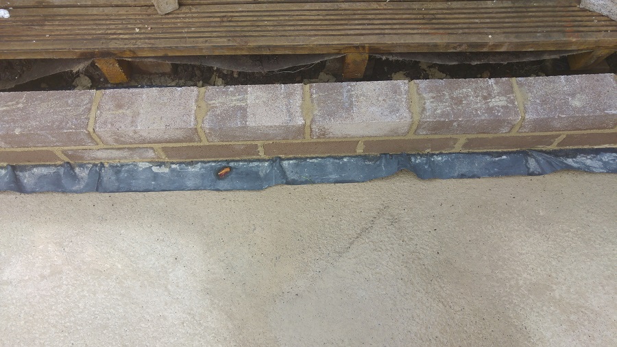

Ok, I'll have another go.
He laid a sheet of visqeen in the hole and filled it with concrete.
When it set, he pulled the excess visqeen back over the sides of the concrete onto the floor.
He then laid bricks on it, using it as a DPC.
He then cut the visqeen to cover the inside of the lower bricks when I put the insulation in.
He left the visqeen on the outside of the bricks and concrete excess intact, as my previous photo shows.
My question is the same as previously.
I've just taken another photo and attached it of the floor and inside of the brickwork.
Thanks.
John

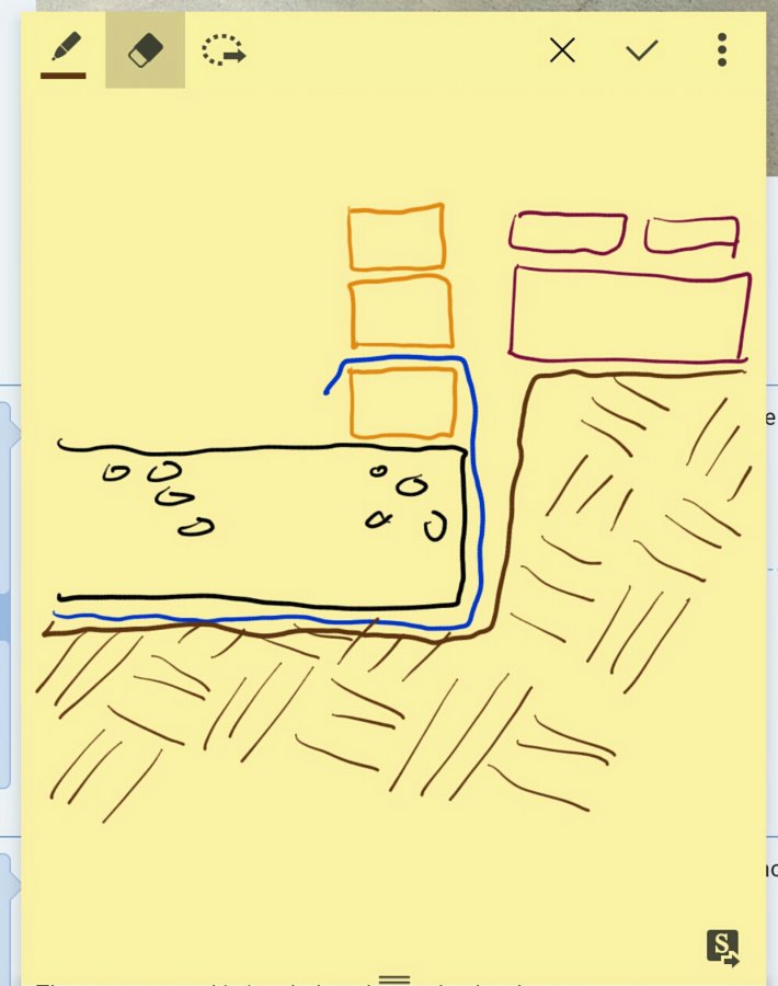

Is this what is going on?
If so it's a bit crap as there is no protection for the DPM, and DPM is not a DPC.

Almost right except the visqeen goes under first brick, then he's cut it off to go up the inside just to the top of the first brick.
He says by doing that the top brick will allow any damp to breathe through it.

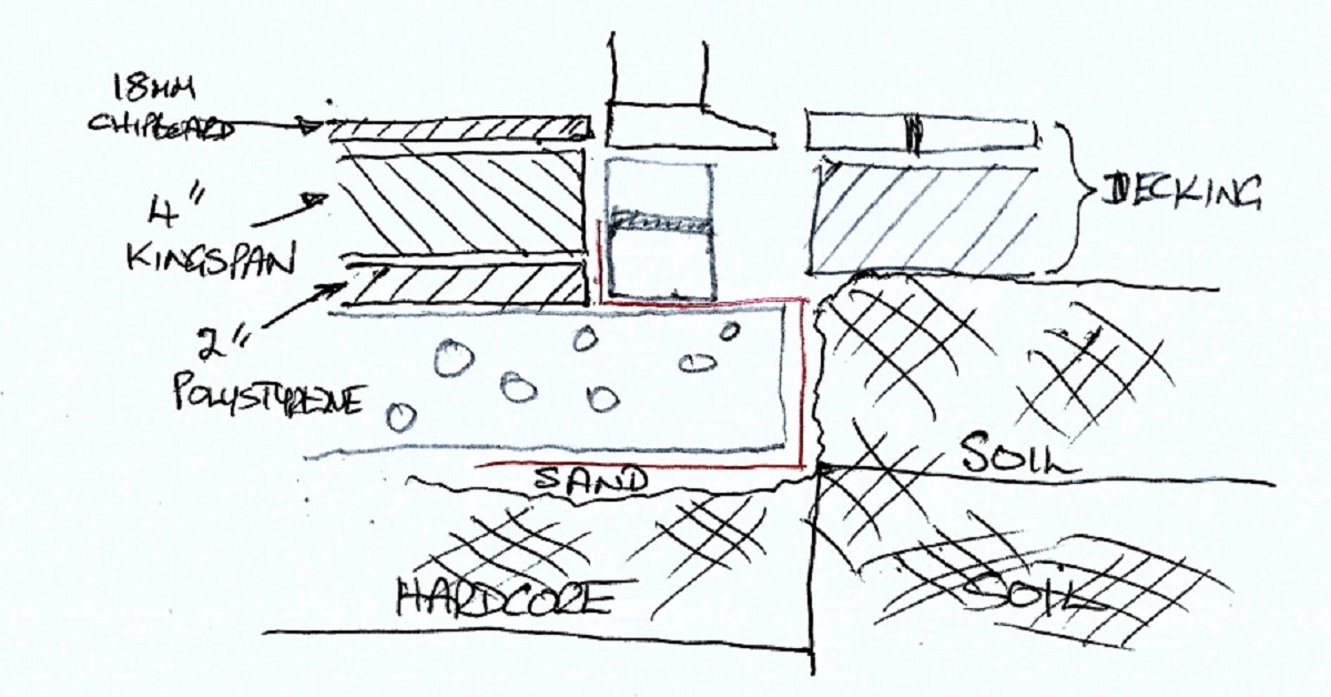

The drawing is how it's supposed to look when finished... or not.

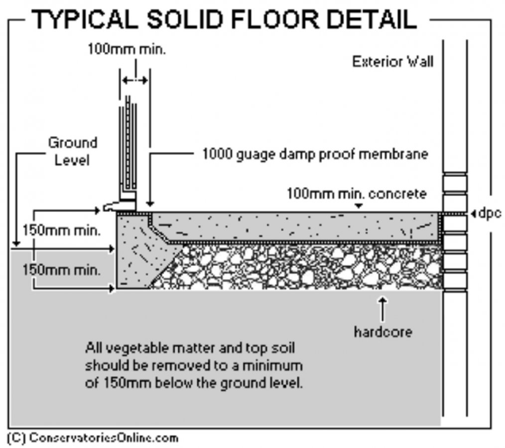

This is what I thought he would do.
Every conservatory site I looked at used the same drawing.
I didn't show him it because I assumed he'd know how to do it.
