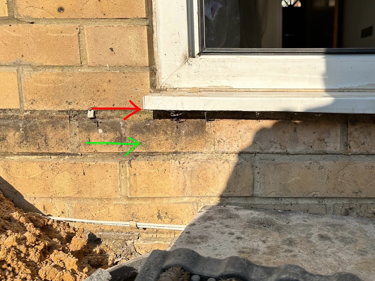

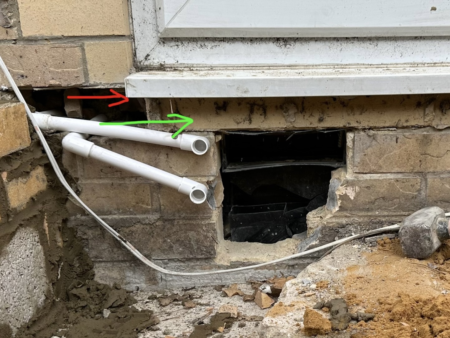

I'm shortly to lay the concrete slab and then screed for my conservatory. Plan is to then her heated electric tiles on top. The access to the conservatory from the house are through two sets of upvc doors on my property which have upvc door sills outside
My question is what height do people normally build a conseravatory floor to.. is it the same height as the house or slightly lower? What do i do about the door sills, how to people normally handle this?? Do they cut them out or pour the concrete around them.
Builder suggests doing screed up to red line, bottom of the UPVC sill attached... But don't I need to leave a gap (green line, say) to prevent a 'step up' into the conservatory? Also tiling around the sills will surely be really tricky.
Any advice really appreciated!
Your floor inside is probably at the height of the pointing, the flooring of whatever type is then on top. So if you do the same you'll end up with the same height either side of the door.

Thank you. I suppose my question is more about what happens to the lip or sill on the doors then? Builder is saying the floorer / tiler will cut them off, but I don't know if that's going to be possible if he half submerges that uPVC lip with screed!
