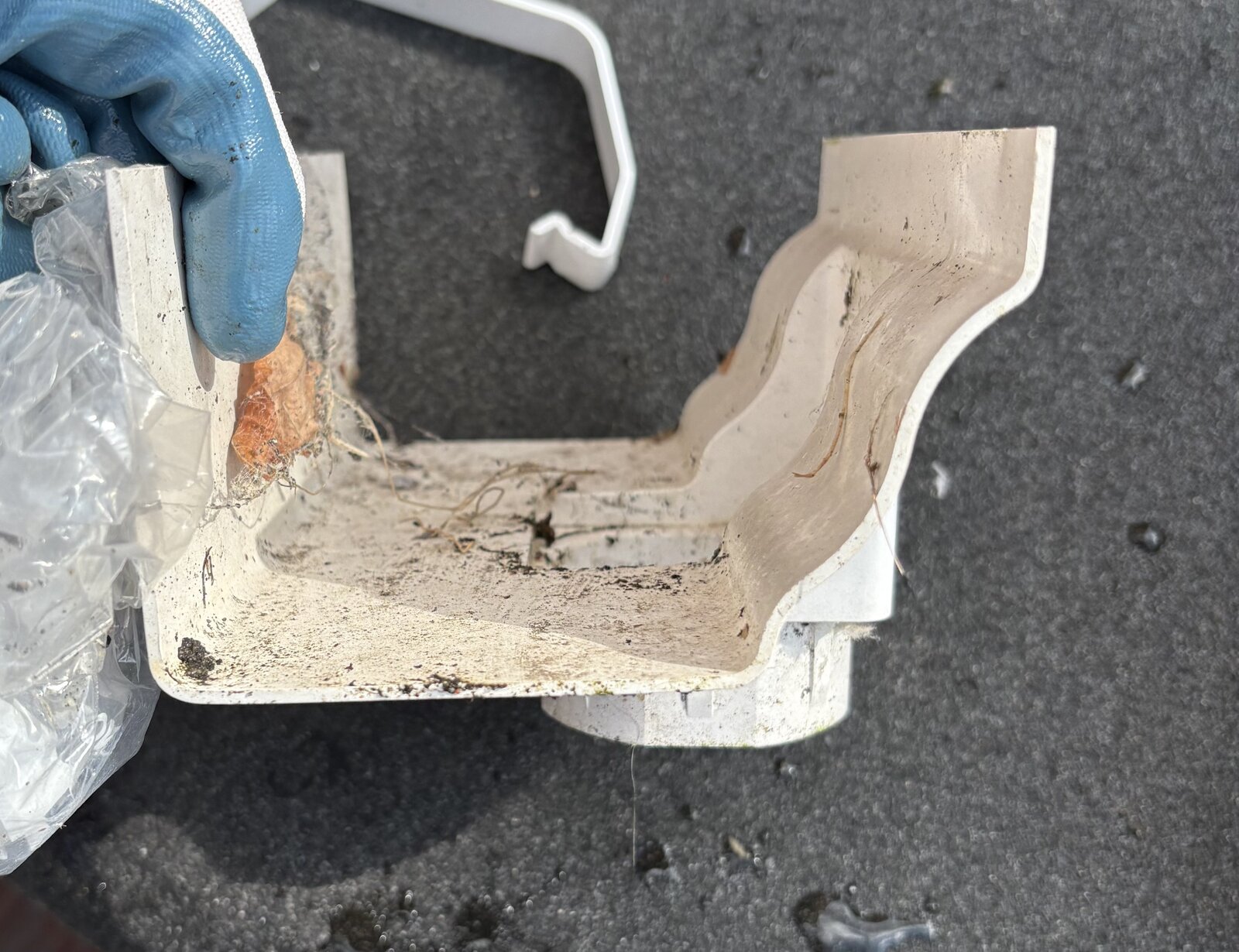

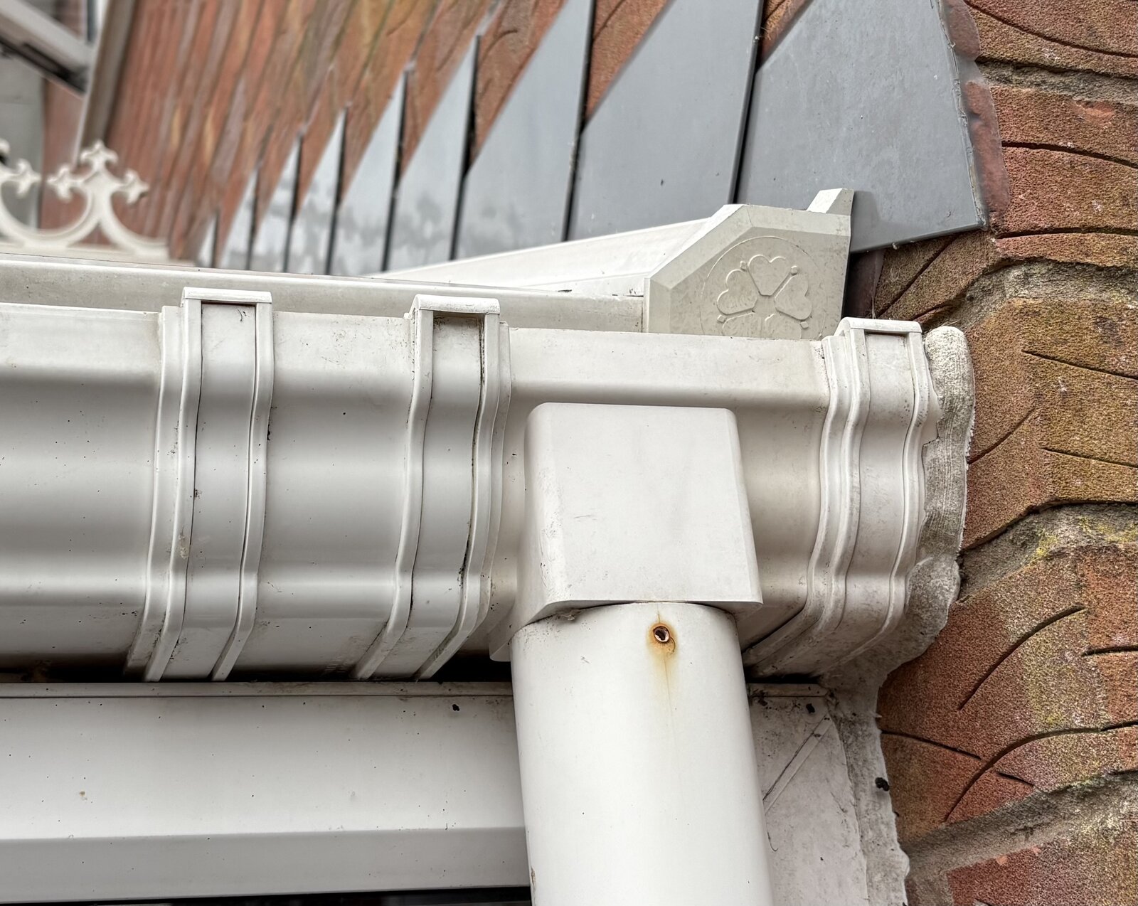

Recently moved to a new house. Guttering goes around the conservatory which is quite big - it's 5 metres wide and goes the whole width of the house. Comes out about 2 metres. On one side the gutter has a downpipe that goes quite deep and joins up with the surface water drainage, On the other side, it's the same set up but the downpipe only goes about a foot into the ground and that's it - no drainage, no soakaway, so all the rainwater is just pouring into the ground. We were getting loads of woodlice in the house and particularly the conservatory, and I wondered if the damp ground was attracting them.
Anyway I've removed the downpipe and just want to cap off the hole in the gutter, and let alll the rainwater drain to the other downpipe instead. However, I'm really struggling to find how to do this. The gutter seems to be a particular shape - the closest I can find is something called Marley and pieces sell online for a fortune. I thought about buying a union joint to replace the piece but apparently it measures 100mm and the gap when the outlet piece is removed is more like 110mm. My missus won't let me cover the hole up unless it blends in (I suggested a jam jar lid with some sealant but she wasn't having it!).

Clean.
180 grade sand.
Use a polymer to stick some plastic over hole. Something like Stixall or CT1.
Where you removed downpipe could you fit an aco drain running away to a drain?
The put downpipe back
I would expect that guttering to fixed to fall to each downpipe on each side of the conservatory roof, so closing one side will compromise the water shedding. It has two outlets for that reason, so the whole lot will have to be reconfigured if you wish to deploy only one downpipe.
