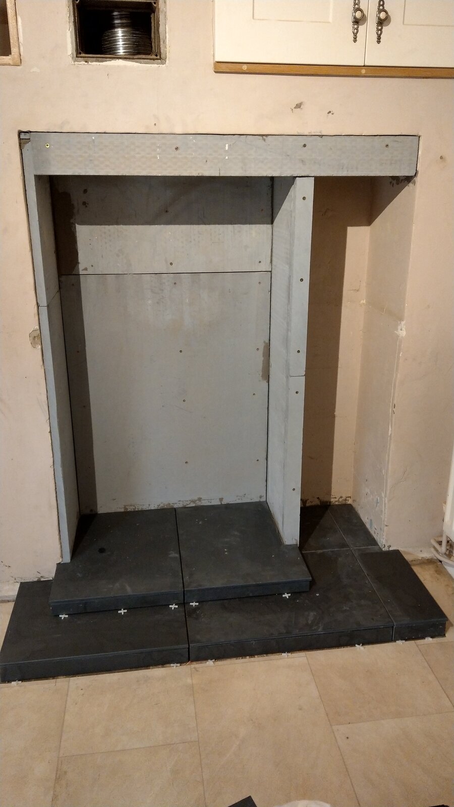

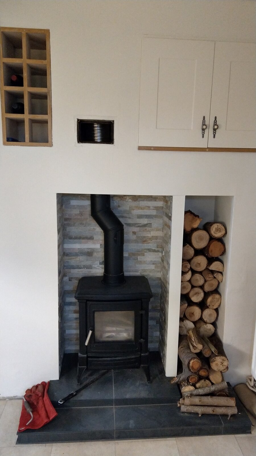

Two things - a majority of modern wood burning stoves don't require a full constructional hearth as they are designed to have cool undersides. Check manufactures requirements.
Second - you really don't need to start pouring concrete with modern materials. I used 90mm of Skamotec underneath mine, sealed with SBR and then tiled. There are other fire boards available, Have a look here - https://stovetech.co.uk/product-category/fire-board/

View attachment 209516 View attachment 209517
Thanks for the info. Are you saying that you can use 90mm of fire board above timber floors as a constructional hearth?
You probably still need to refer to the manufactures spec, but what I can tell you is that the 50mm Skamotec I have to the side of my stove is too hot to touch on the tiled side and completely cool on the other side!
I guess if you wanted to follow the letter of the law and allow for an air gap, you could frame with 50mm Skamotec then put a full board over.
But, in answer to your question, yes, I'd just build over the floor.
