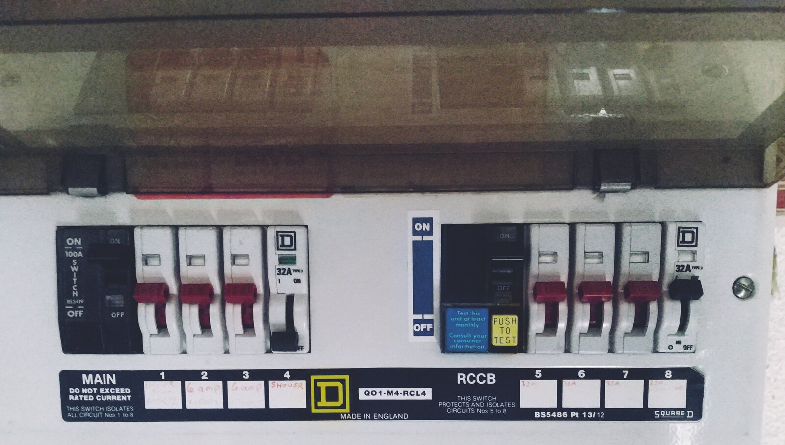

Hi All, I need a new consumer unit - the old one is a Square D, and I need an uprated mcb for a more powerful shower - anyway, the electrician says I need to have the supplier come out and fit an isolator and the work should be free of charge... he also said its illegal for him to pull the main breaker as that involves cutting the seals. The supplier want to charge £100 for this task, does anyone know if this should or should not be a chargeable thing? Thanks for your thoughts!

Hi Adam and Chivers67, Pic of Square D CU as requested!

Ah, original Quikline board / QO-E MCBS. As the shower is on the non-rcd side with no free ways the otherside, you'd need to change the MCB to an RCBO. QO-E was discontinued a while back, there was a retrofit range called QOVS which was compatable with the older QO-E based stuff, but it was more aimed at the commericial sector (only available in C type and had a big price tag). With a small board like that, I have to concur with the original advice that the best way forward is to change it. Ideally you want to be asking for all RCBOs and surge protection.
As to the isolator, who is it you have been in contact with? I think in licestershire you'll be in the old east mids electricity board area, who are serviced by western power* (who have now just renamed themselves to national grid), so it may pay to speak to them instead https://connections.nationalgrid.co.uk/make-a-change/isolation-switch
*privisation - don't ask (it is as fragmented as the railways)!

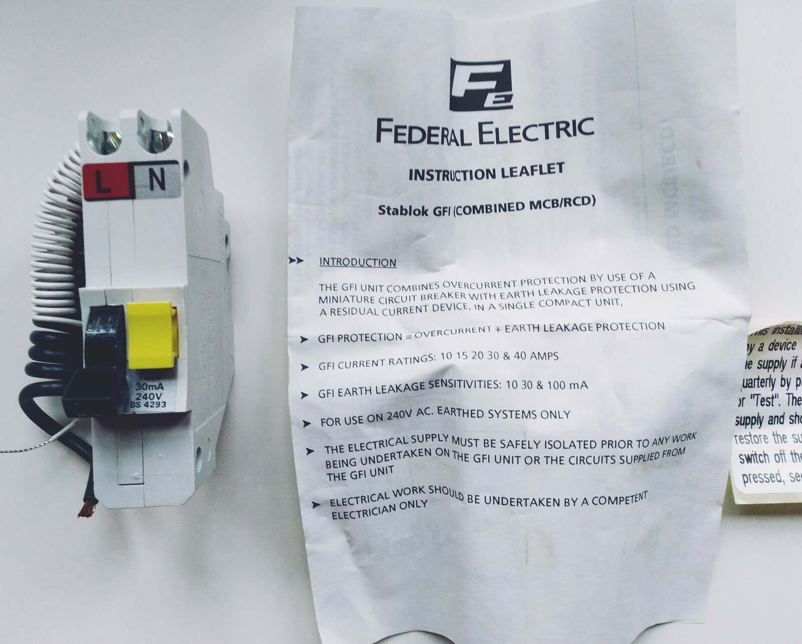

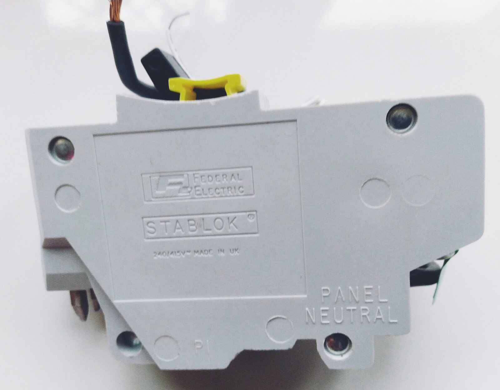

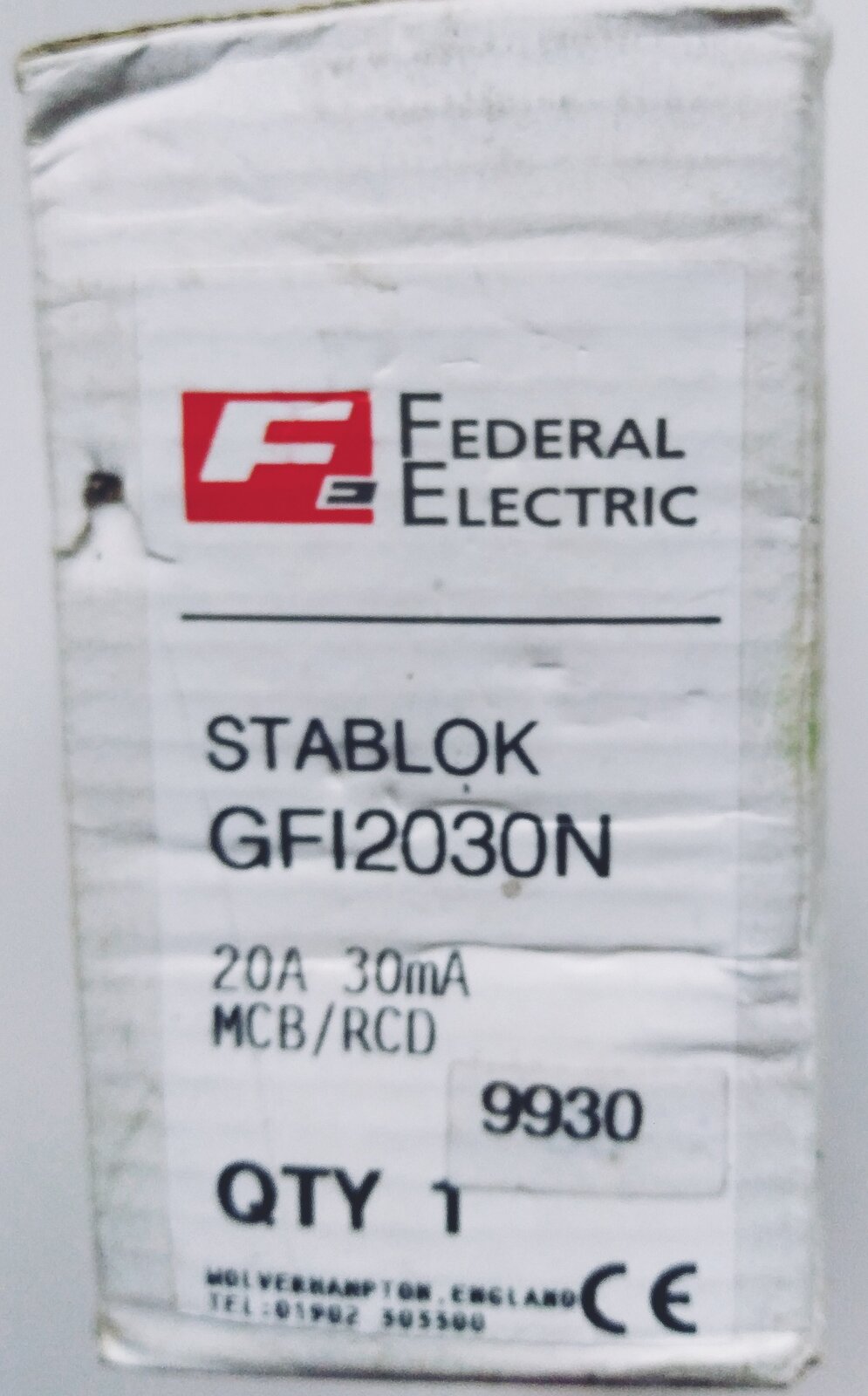

Hi, wonder if you'd like to see this pic of this STABLOK mcb/rcd made by Federal Electric that I rescued from a skip recently. Looks like NOS too.
Obviously can't find a use for it, which is prob. why it was in the skip in the 1st place! If anyone would like it for their museum, drop me a line - foc, just cost of posting, or collect from LE18... want more pics? Just ask!
