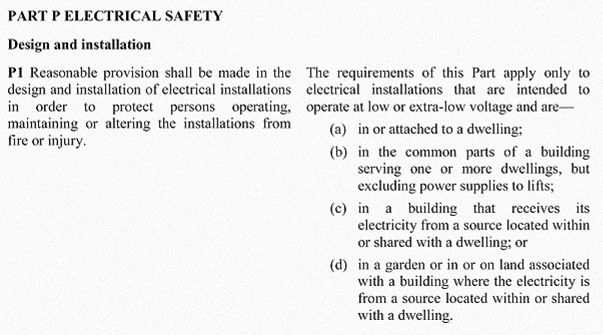

See my post above (source 2010 version of Part P , page 7)
Part P has no pages.
This is it in its entirety.
There is no more.
