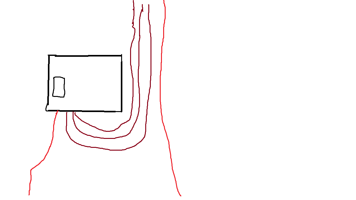

Old shower circuit removed on consumer unit today. I isolated the Cu at the main switch and triple checked for deadness. Checked with a voltage approved tester. Removed the old MCB and associated wiring.
However it has come to my attention that the (32amp) ring main has 4 wires coming out of it. I am quite concerned, it should be only two right; only if someone has spurred a socket from it however this is not the case.
There are only 2 MCB's in this CU
1) 32 amp for the entire ring for the house
2) 6 amp lighting circuit.
The ring is covering the entire house and out of the four wires; three are going upstairs and one is going under the floorboards (two rooms) (first floor).
Could it have been DIY dave who installed this CU. Its a old 3871 type.
Thank you.

Sounds like there's an original ring plus two spurs coming from the MCB. Impossible to tell without doing some on site detective work.
Are all the conductors of the same size? Maybe one is powering the cooker?
Sounds as like thats a v old CU with no RCD protection. Probably long overdue for updating.

Could be a ring and two spurs or two rings - acceptable.

Ok. Do you mean that is all there is or other circuits are not MCBs?
Ok.
Presumably the one going under the floor boards is one leg of a ring but that does not help with the other two.

What I think is, its two cables going upstairs which is a real ring and two radials (lets call it) are going to the first floor including the kitchen.
Ermm, One part of the ring went under the floor (presumably serving the downstairs ring) then comes out from the floor from the other side, then goes upstairs with the following 2 cables..
I don't get it cos this ring supposed to be serving the whole house, why did the previous guy not daisy chain it from above to below, makes testing a long day
The setup is like this the red wire on the left goes under the floorboard and the red one on the right go upstairs with the 3 other wires shown in the image.
