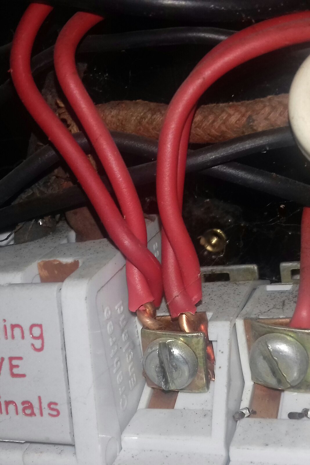

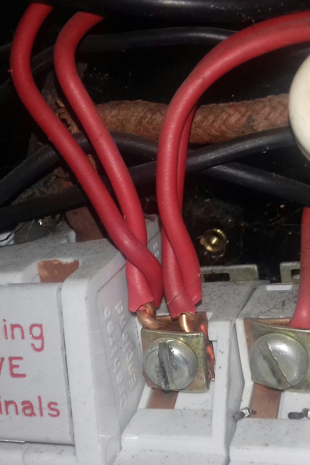

Consumer unit query
20231106_094747-1.jpg4 wired as shown
I'd at least look at getting the meter tails updated a bit, those look like the old VIR or maybe fabric type to me. Probably wants an electrician to take a look at it all.
Thanks guys.
Also the cable that leaves the 6amp lighting circuit goes under the floorboards... its quite strange... should it not go from the ceiling just like others.
Get a competent spark involved. They have knowledge and test equipment AND experience with this type of stuff
Isn't it possible that the leg going under the floor is one of the ring final legs, and one of the others that goes up is the other, then the remaining two are spurs or another ring final.
