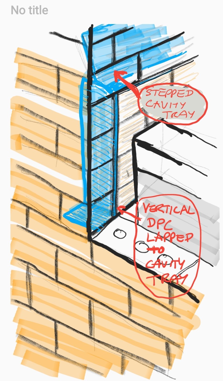

Please see pics included, the utilty area is single storey and the kitchen area will form the ground floor of the two storey extension. The inner blockwork forms the cavity wall between the utility and the kitchen and will carry on to form the inner and outer blockwork for the two storey extension.
My question is: When the outter brickwork is as high as the single storey section needs to be and it now needs to turn to build up the two storey section (see red brick on pic), how do you bridge the cavity?

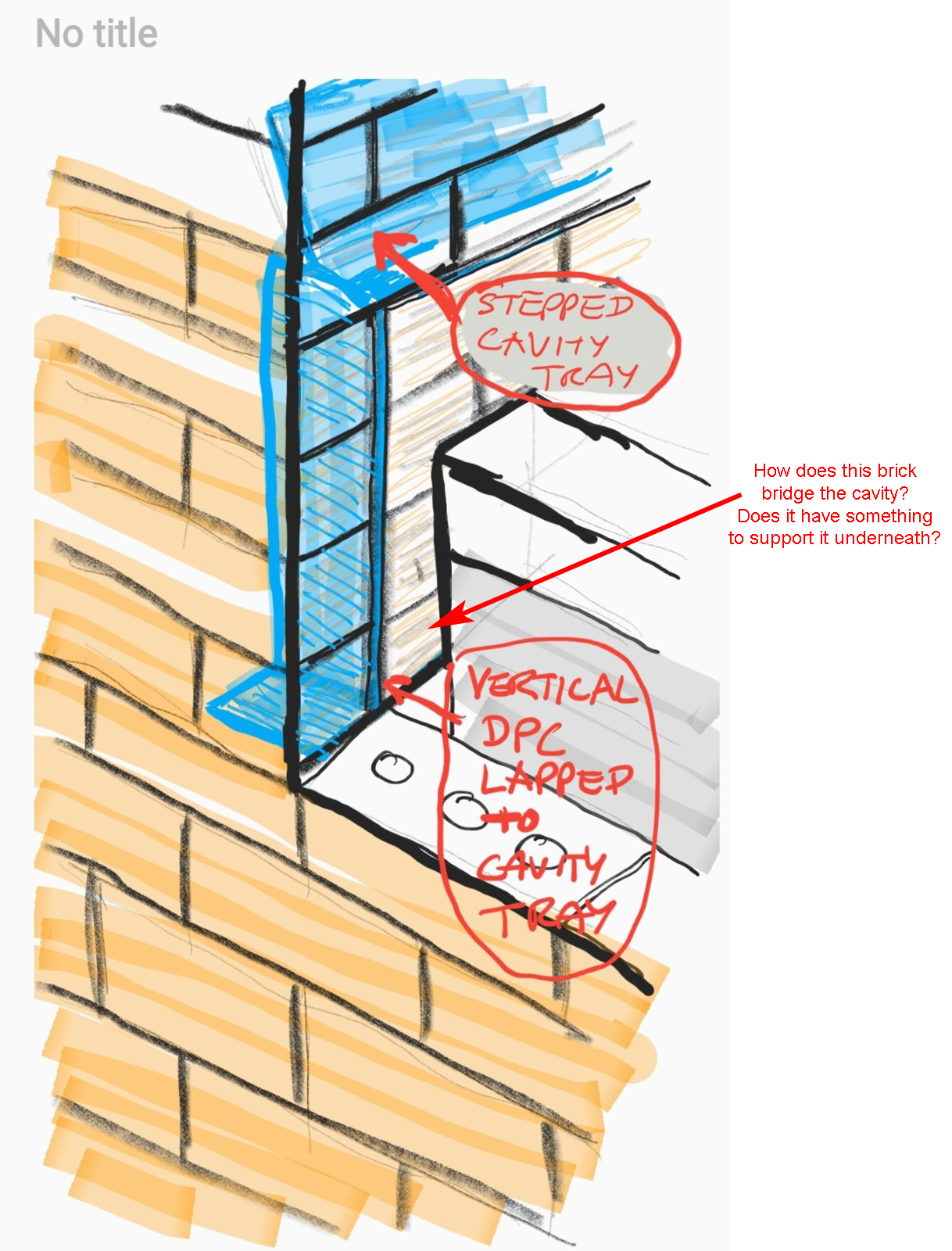

Yeah, he has said to include vertical dpc's and cavity barriers in general on the building regs. I'm asking more from a structural point of view. When the brick turns to build up the second storey instead of continuing along the first storey wall (because that’s at proper height), the brick will not be supported as it’s going to hang over the cavity.
I'm not sure how to explain what i mean which is why i'm struggling to find the answer i guess! Attached another pic to try and explain what i mean.
There is a chance i'm being completely dumb here! :confused:

Cheers for that. I understand about the cavity tray and DPC, but i'm struggling with the brick i've highlighted below. It has to turn to to bridge the cavity but it wouldn't be wide enough.

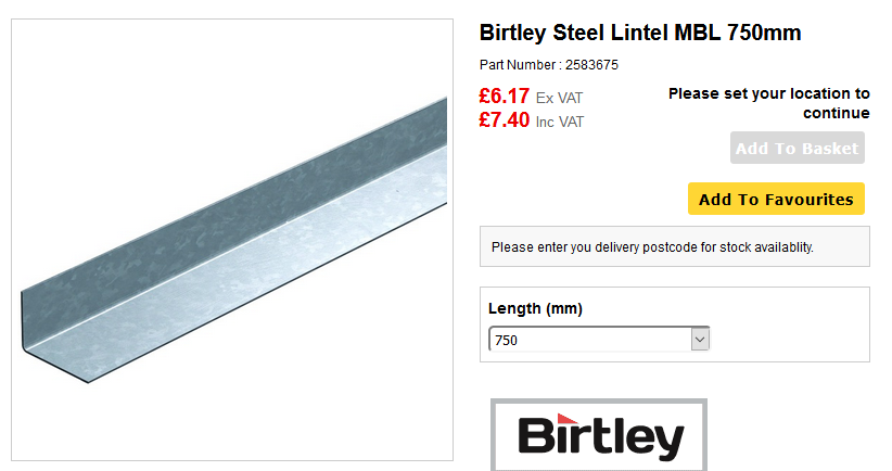

Well I kind of wondered about using a lintel but thought that sounded ridiculous for a 10cm gap; I thought i was perhaps missing a simple method of doing this particular thing! Something similar to this?

A couple of weeks ago I could have given you an offcut but for £7.40 you could make 2.

Could you not just wedge something underneath to hold the brick in place and then when the next course is laid it will hold the back of the brick down and it won't tilt into the cavity and you can remove the wedge. Perhaps a small piece of galvanised metal sticking out from under the brick on the outside to support the end of the over cavity brick on?
I suppose it could be something like this, I just thought there may have been a "proper" way to do it.
