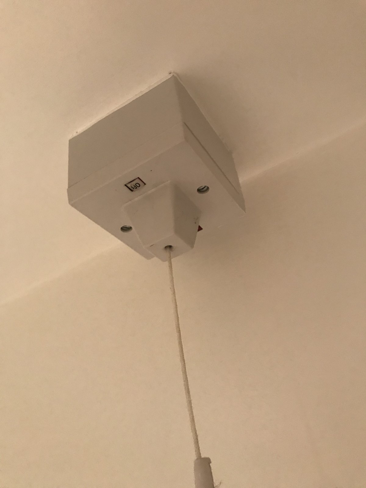

I have a Shower cord pull in my en-suite that has power to it but doesn’t go on to a shower as a mixer was fitted instead. Would it be possible to swap the pull switch simply for a shaver socket? It’s run in heavy twin and earth (I’m assuming 10mm but haven’t checked yet) so over rated for a socket. Would there be any issues with this?

You would need to have an FCU instead of the shower switch. Fuse it at 3A and then cablecin 1 or 1.5mm to the shaver socket.
But that’s a silly way of doing it.
Just install a shaver point and power it from the lighting circuit.
Disconnect the shower circuit at the CU and do away with the redundant pull switch.
