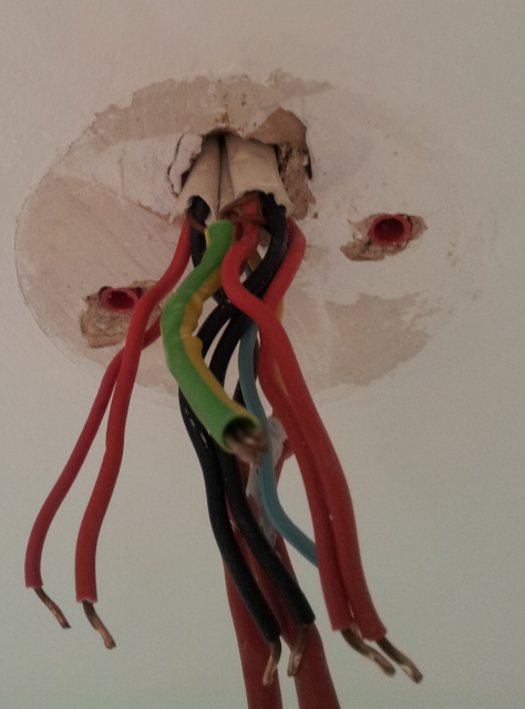

The batten lamp holder in an en suit shower room ceiling was installed by the house builder around 2000. I imagine it met the regulations then. In a recent EICR assessment, I was told that the light has to be IPX4. Is the assessor being over-strict in the assessment? Is the light fittings a borderline case in meeting the regulations? I don't imagine the house builder would have gone too far wrong.

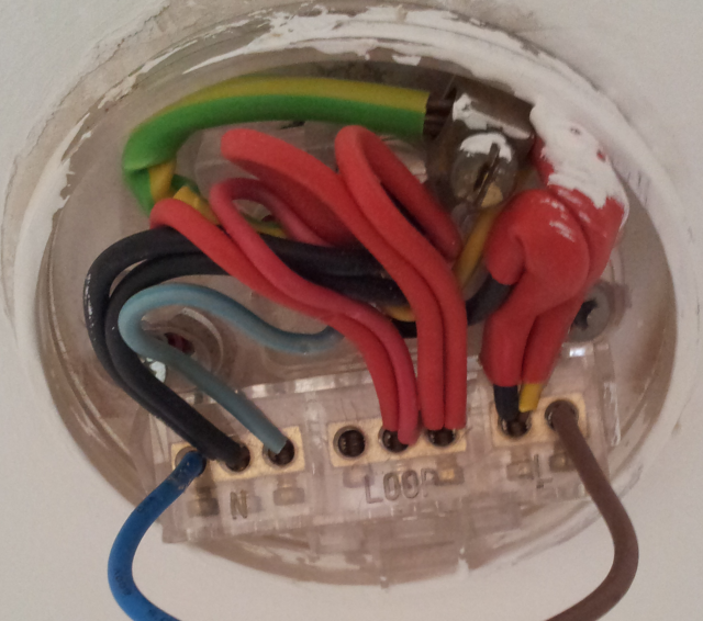

I assumed the wiring for the batten holder would be straight forward. When I opened it up, I was shocked to find almost a nuclear power station there. What is the best way for me to convert this to IPX4. Are there any particular light fittings that would work with the wiring junction as is?

Can’t see if new light fitting is suitable you have only shown the ceiling side . If you can get the existing wiring up into the ceiling you can connect it.
Additional wires may be feeding extractor fan?
Yes, you could be right the extra wires are for the fan. The piece of junk amazon unit has a foam strip on the perimeter that gives it a little space but not enough to accommodate the wire junction. On the other side are just LED chips. Getting all the wires to the other side will block some of the LEDS.
As @foxhole suggests, if you can make a slightly larger hole in the ceiling, the wiring and a connector can be pushed up into the ceiling void.

Are there any regulations about size of the hole in the ceiling. I don't know for sure, but I think the existing hole is just big enough for the wires to come through. These are solid core wires and are stiff. I will detach the junction from the ceiling and take more pics when I am at the property next.
That's not a "I was shocked to find almost a nuclear power station there." situation.
It's actually an (in my opinion) well wired ceiling rose.
As others said above, the switched live feeds something else such as a fan.
Normally, to get rid of a bathroom ceiling rose, all those wires would be put in a junction box and shoved up through the hole in the ceiling, leaving just the (outside blue and brown) feed to the lamp.
However, can you give us a bigger picture? How high is the ceiling and how big is the room? And is this rose above a bath or shower?

If I want to convert the rose into a junction box, which box is best for all these wires?
The best solution is a light fitting that has some space, like this one:

A batten lamp holder 1683193452235.pngwould not get much water in when sprayed from below the only way it is likely to get water in it is with a leak from above. But this 1683193594509.png does not look like a batten lamp holder, it looks like a ceiling rose.

As expected the center of the lamp holder is exactly 60cm to the shower enclosure door. I presume this allows interpretation either way of if it is compliant. The ceiling is 2m35cm from the floor.
The hole in the ceiling is exactly the size of the cables. The ceiling is made from reddish plaster on rock hard concrete (slab?) Beyond the slab is the cavity. Enlarging the hole could be challenging and would need diamond drill bits. All I have are small dremel diamond bits that might work but haven't tried. Making a bigger hole compromises fire and sound proofing for the flat. Suggestions?

There is no need to alter the ceiling.
You can either get an IPX4 light of any depth that has room for the wires - it won't need much if all pressed flat to the ceiling -
OR
you can get any (old) light that is a maximum of 10cm. deep and has room for the wires.
