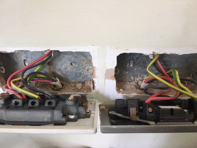

Doh. Bad news.
Its actually on the damned kitchen ring circuit.
Somewhere the pair must come out at a double socket on the ring main - I will have to go around the sockets to find with one.
I'm screwed :-(
I guess I could find where the pair from the island come out on one of the wall sockets, and then look to put in a new circuit from the fuse box to that point.
That would save me going under the stone floor.

When a ring is installed, one cable will come from a socket on the kitchen ring and the second cable will go on to a different socket. It is possible that both cables appear at the same place, but I doubt it.

Yes I agree with you, but the stone floor and water-based underfloor heating make me think they will have gone for easiest shortest route? If I am lucky.
I have checked a few sockets and they all feed down from the ceiling (as you would expect) I will keep going until I find some sockets feeding from the floor.
Yeah! Found them. Going to a pair of double sockets as you predicted.
Now, anyone got any bright ideas on what to do next?
(Apart from running a new cable from the fuse box??)
