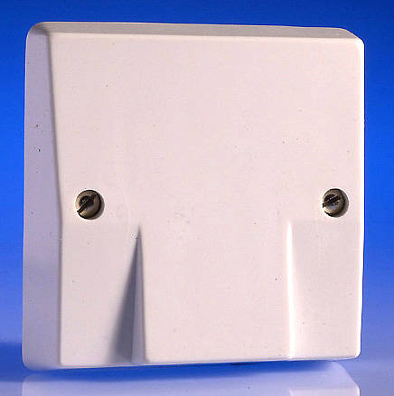

I am going to install a new electric oven/gas hob cooker and, previously only had an all gas cooker. The electric cable for an electric oven terminates in a wall cupboard - about 10" depth - above and to the left of the cooker. Can I just put in a control unit in the cupboard and run a cable from there to a connection box at the rear of the cooker. The wall in between is all tiled without any chance of getting replacement tiles should I have to cut a hole and break one. Also the cable is not long enough to reach other than where it is. :confused: :confused:

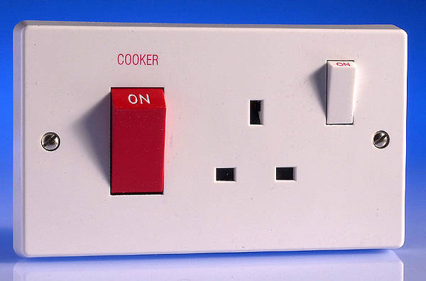

No problem - typically this is how cookers are usually wired, cable from the CU to the cooker control unit:
then a cable from that to an outlet plate:
In your case it sounds as if the second cable will have to run on the surface - use of trunking would provide protection and look better. I think the CCU has to be within 2m of the outlet.

Boys, Boys. Let us not argue. Will it be OK if I put a new cable in to run to what is, at the moment a double socket near the cooker and change it to a Cooker Switch with socket and then run a cable from there to the cooker. The socket is a spur so I can just dissconnect the other end of the wire to it.
Yes JIm, no problem doing that, however you will likely need to deepen the box. Standard double boxes are 25mm deep, the cooker box will need a minimum of 35mm, probably 45mm to enable you to terminate properly and not risk cable damage when screwing the faceplate back.
